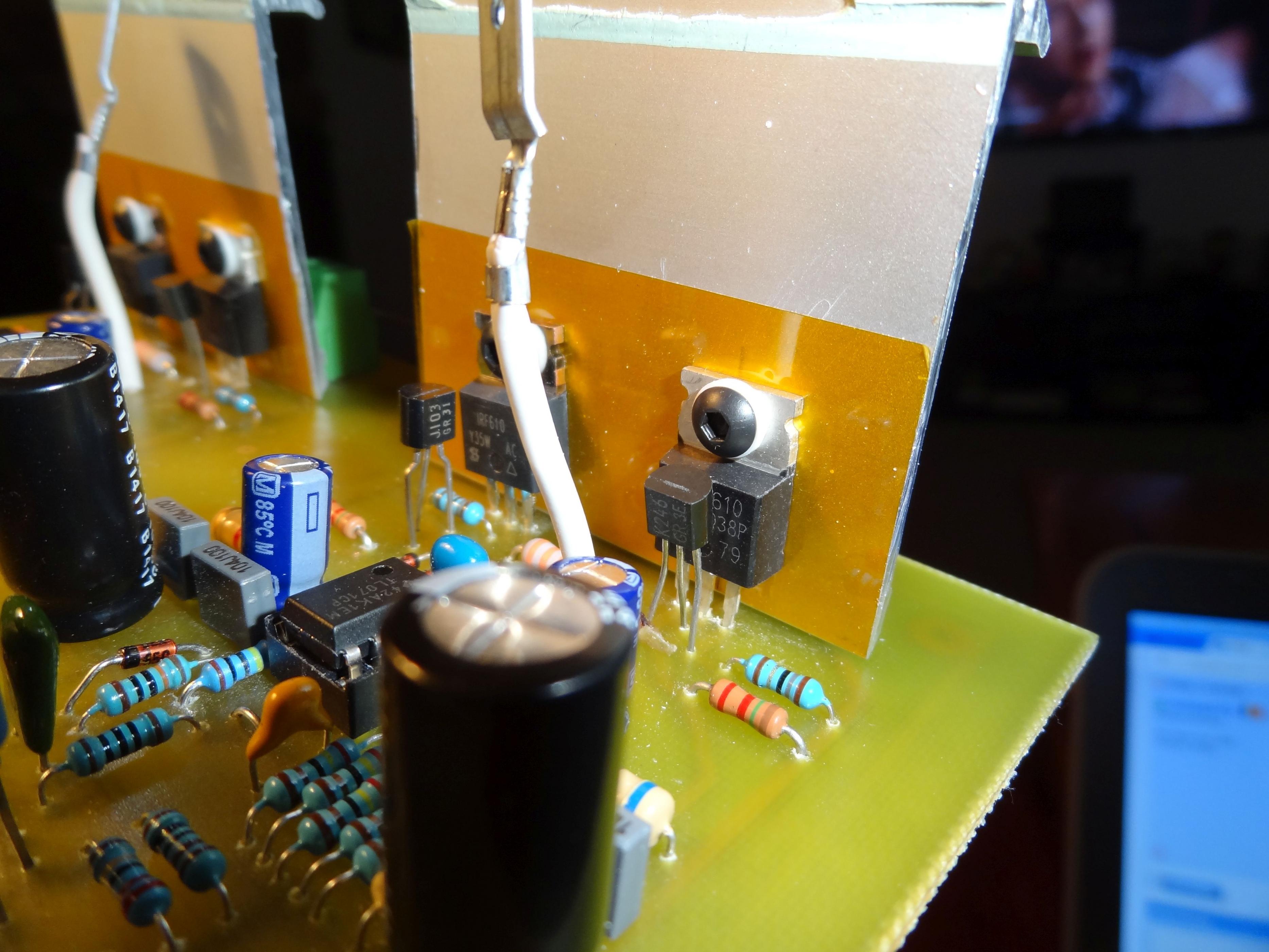

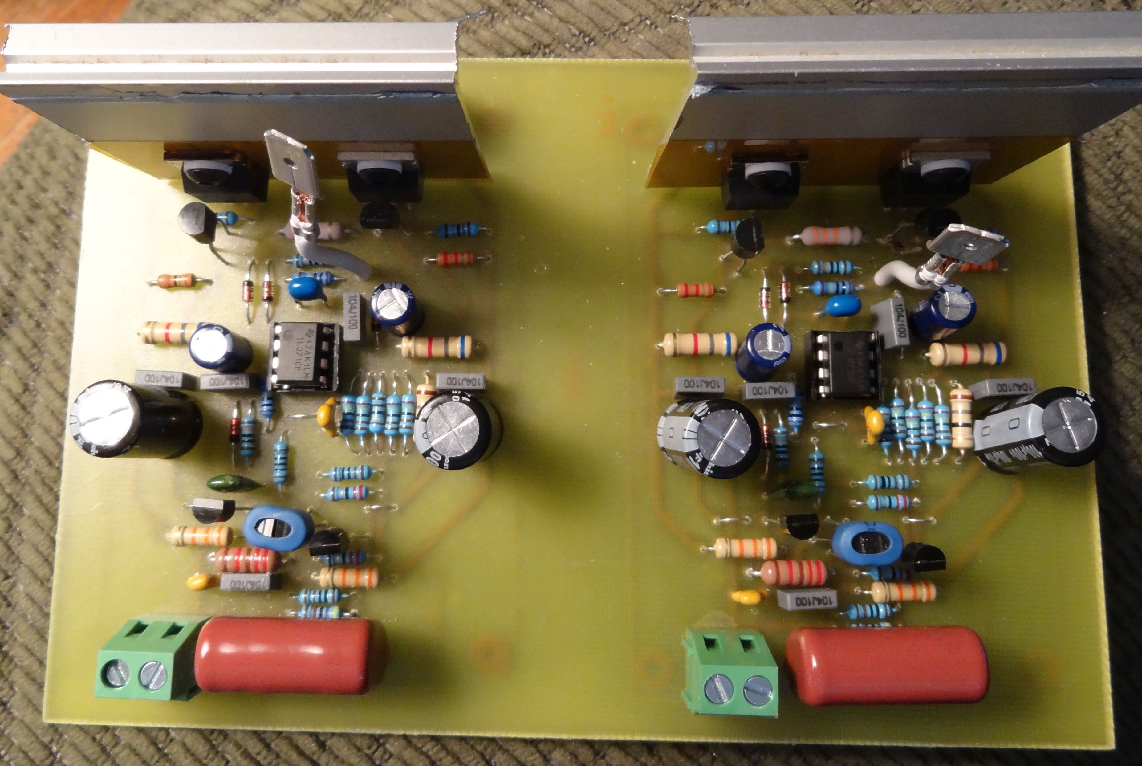

I'll post some pics in a little while. My VAS seems a little hot too. Do you run a sink on it? I measured r26 and it is 771mv. That's a little over 16mA. They are hot to the touch. Not blistering but hot. Not sure if that would cause any of this.
I couldn't see any oscillation, just a tone. I checked it against my tone generator and it is about 750hz.
Here are some pics
Here are some pics

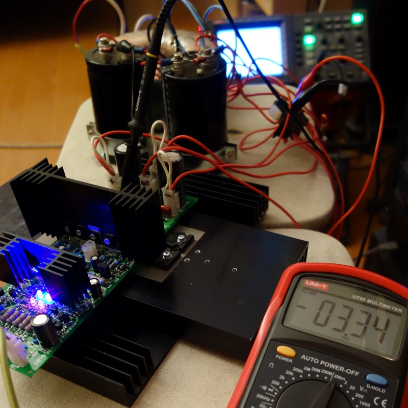

VAS current is about right and I use a heatsink - on the picture, the smaller heatsink on the left, lit by the blue LEDs, is the one attached to VAS. The other, bigger one, handles the drivers along with the Vbe spreader.
I still can't imagine the nature of the tone...

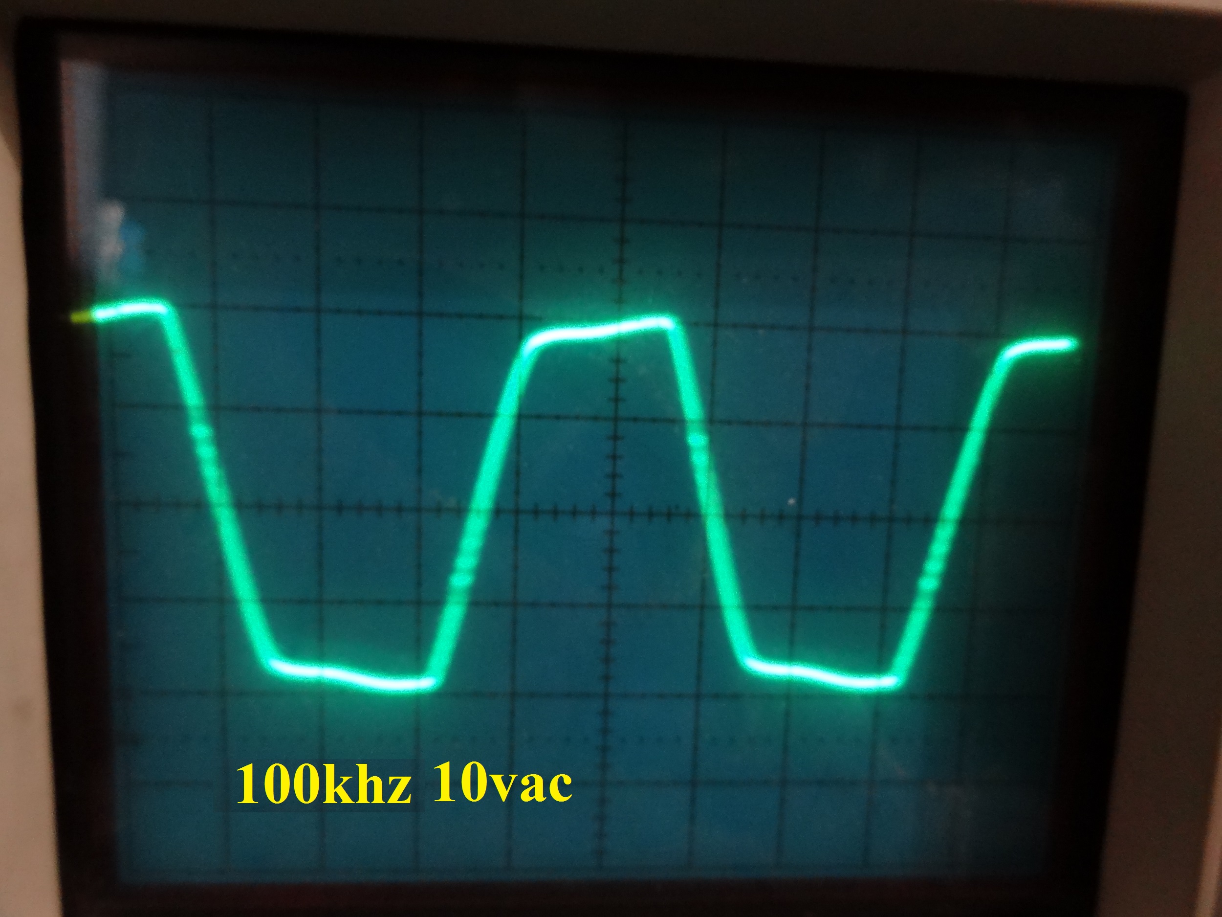

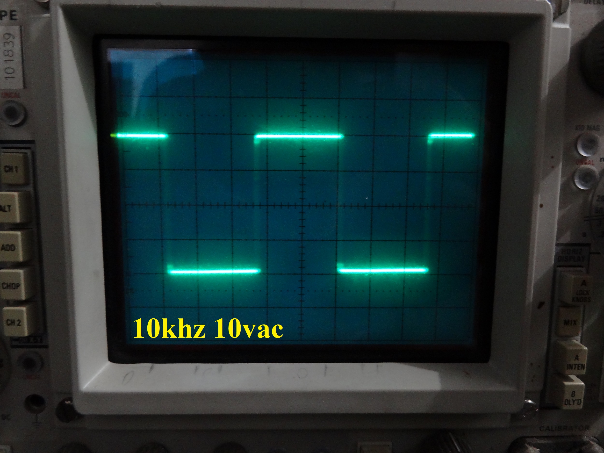

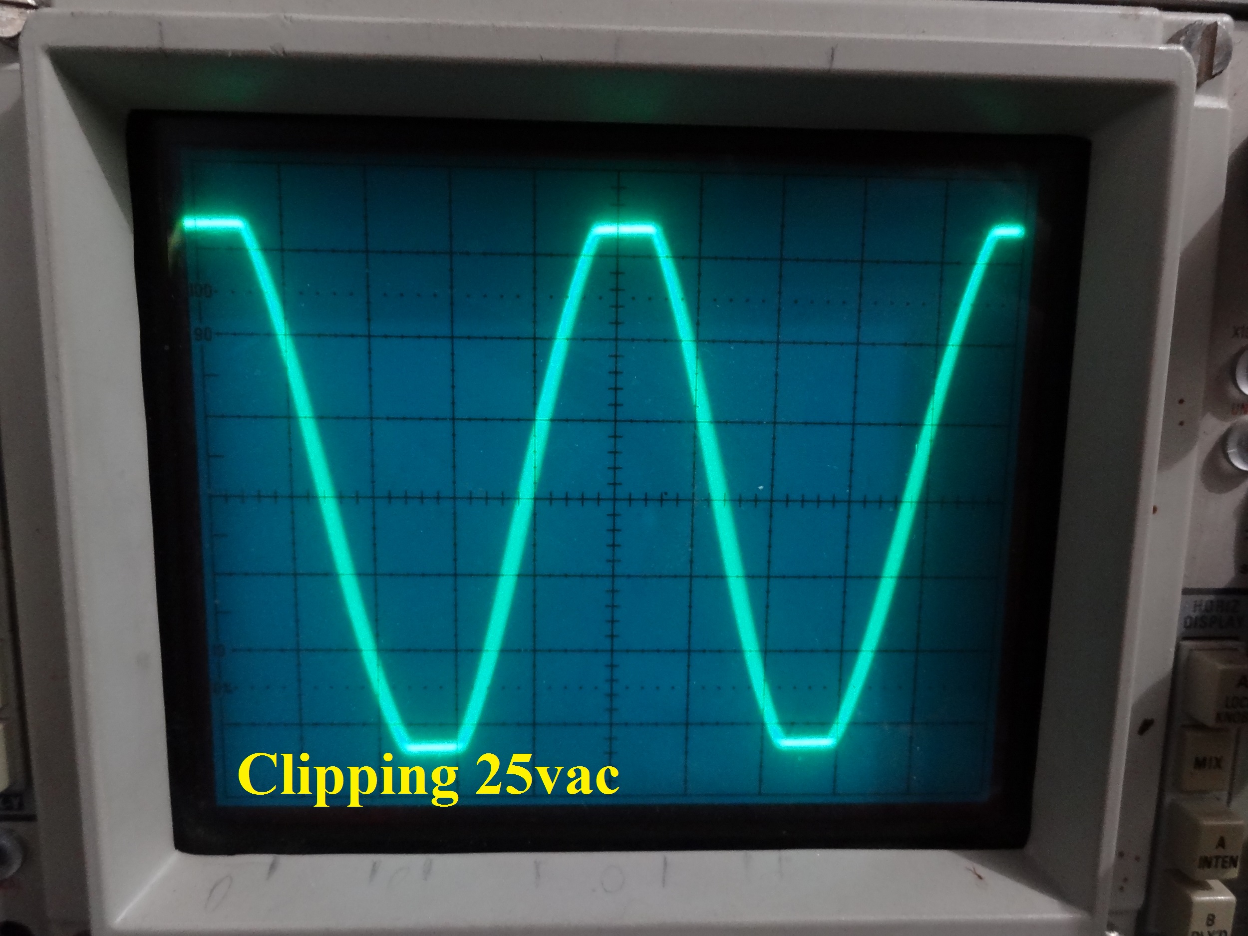

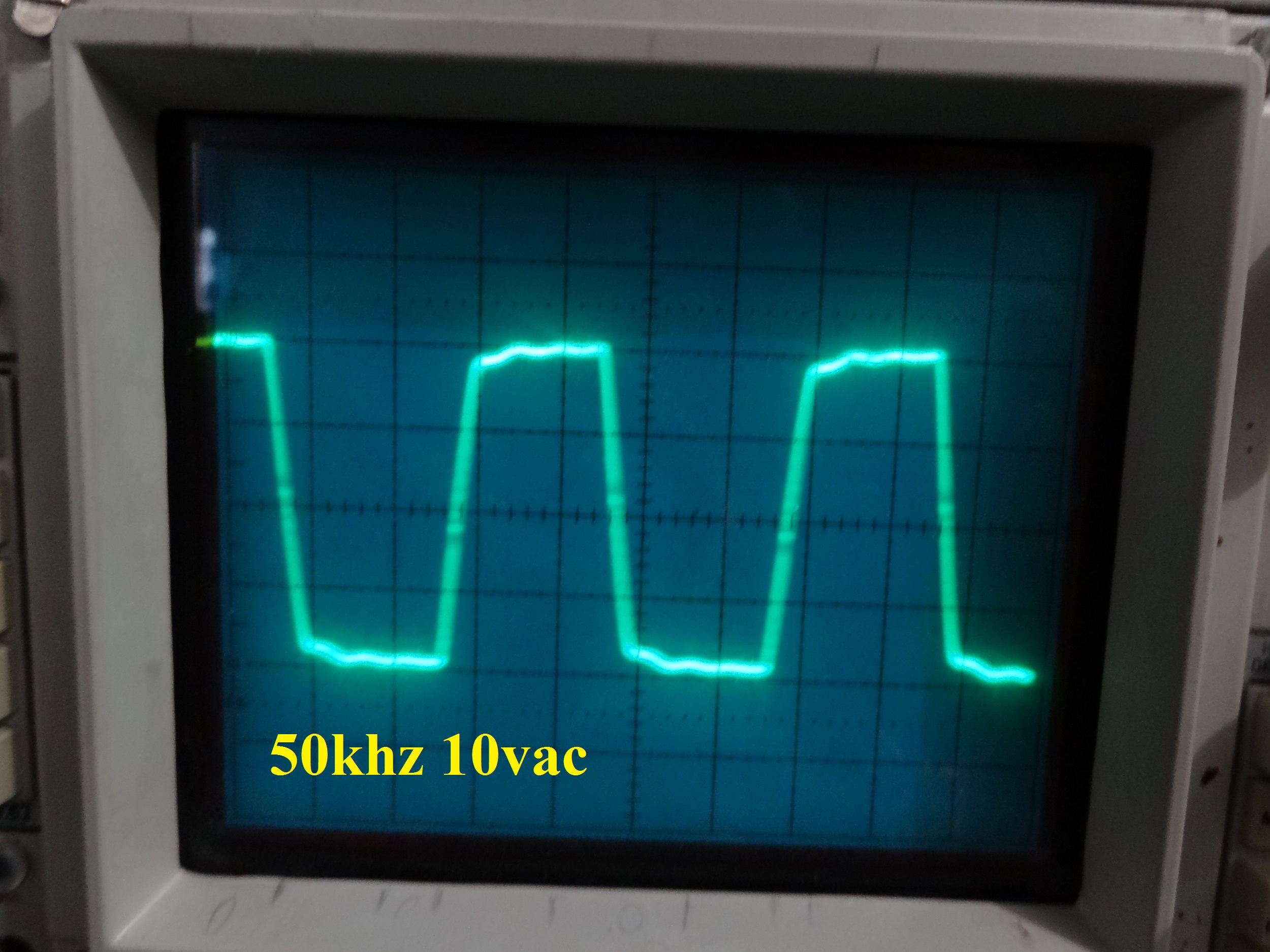

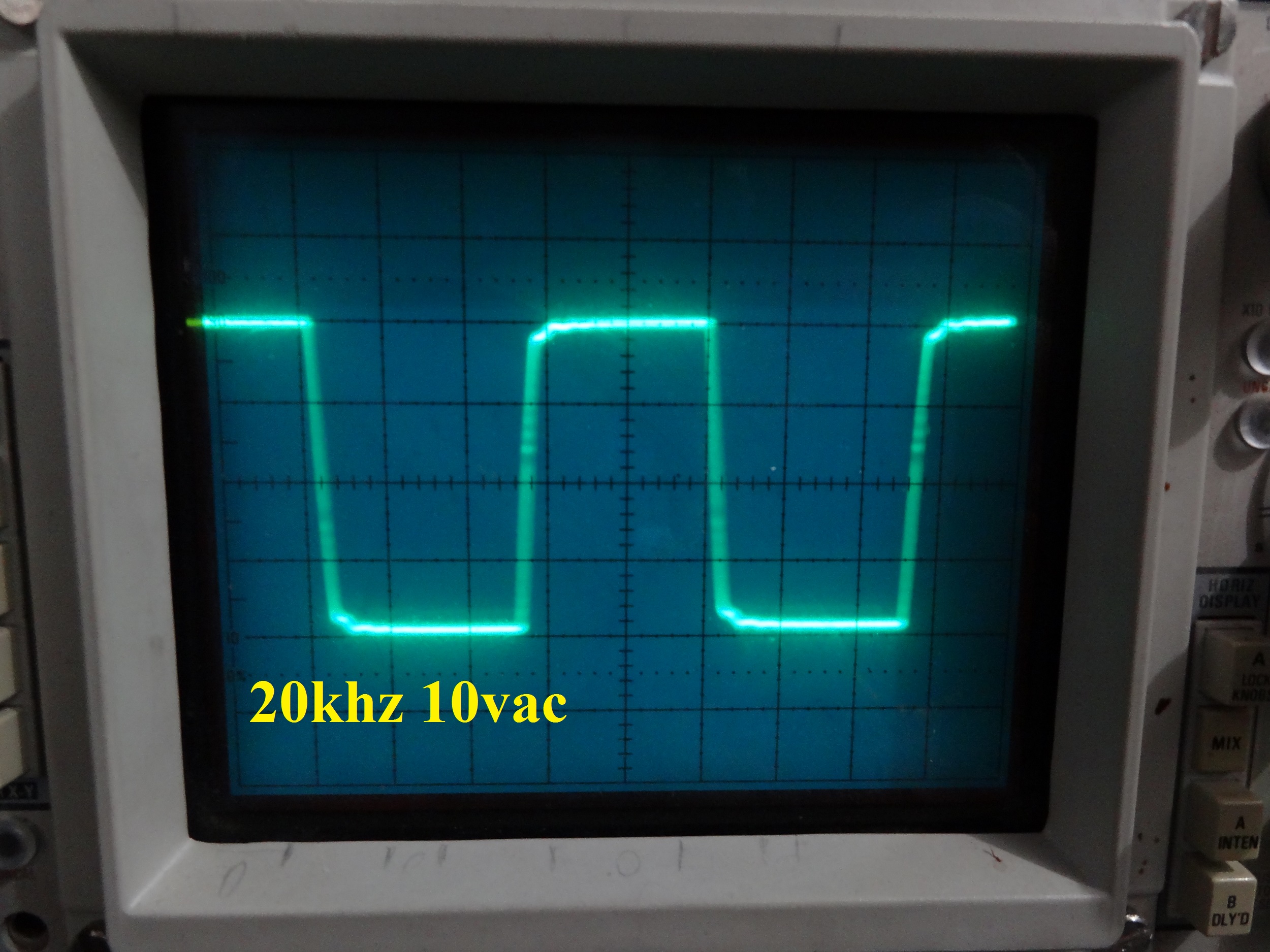

All the rest looks pretty fine. Some "teeth of a saw" at 50KHz and higher squares don't hurt - this is a slight high-frequency "ringing", that may decrease, or disappear, once you manage to make it working from +/-50V rails.
As a "crazy" idea - try to increase C14 - put some 0.1uF there. Will the tome still be there?

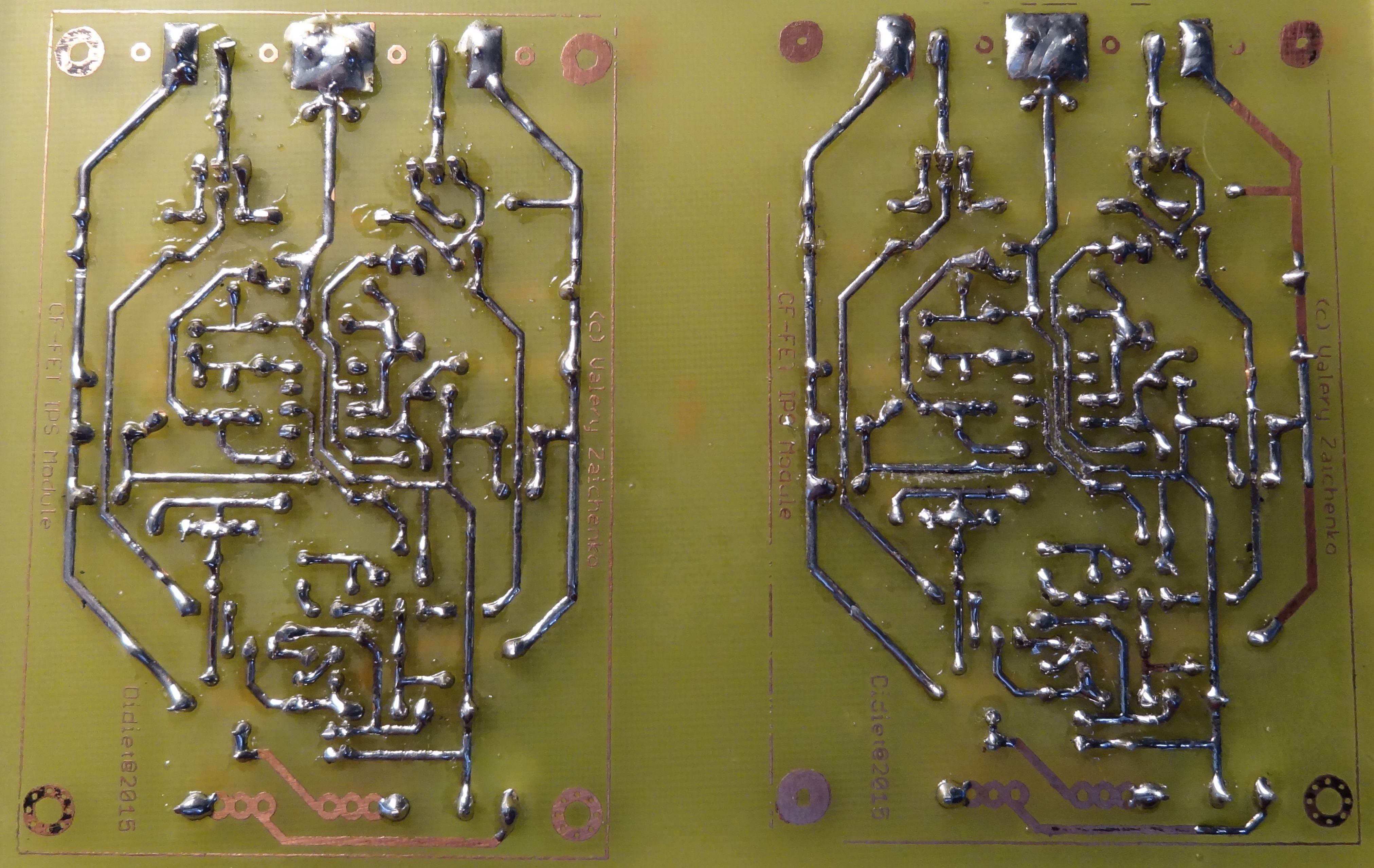

I did a little more experimenting. Just touching the input cable changes the frequency of the tone. I tried just shorting the input with a 1" piece of wire. The tone is still there. If I attach a jumper wire to that shorting wire I can change the tone simply by wiggling that wire. I tried both input terminals with the same result. It is like it is picking up RF from somewhere. None of my other amps do this.
I found this amp very particular to input wiring. I could set mine into oscillation with a shoddy quick connection. I wasn't too concerned because my protection board would always shut it down for me. I have no noise at all though and I'm running 50V rails.
Can it come from the PC or something like that?
As another "experiment", you can add two 47pF caps underneath the board - between the base of Q7, Q8 (respectively) and the ground.
There is no PC. It is direct from a CD player. Same hookup I use for all my amps. The amp does this with nothing attached, shorted input or plugged into the CD player. I'll try the 47p and get back to you. I have to wonder why neither you nor Jeff have this. Quite the mystery.
OK here is what I did. I first installed 10p in C8. that didn't help. Then I installed 47p from the bases of Q7 & Q8 to ground. That seemed to work OK so then I tried removing C8 and the tone was back. I reinstalled C8. It is almost fixed. If I turn on with a speaker attached, the tone will wind up until the PSU finishes powering up and then the tone will fade but if I fool around with the input cable I can hear it slightly. At power off the tone will reappear and wind down. Not quite there IMO. I haven't tried reducing the VAS current yet. I planned to add a heatsink there.

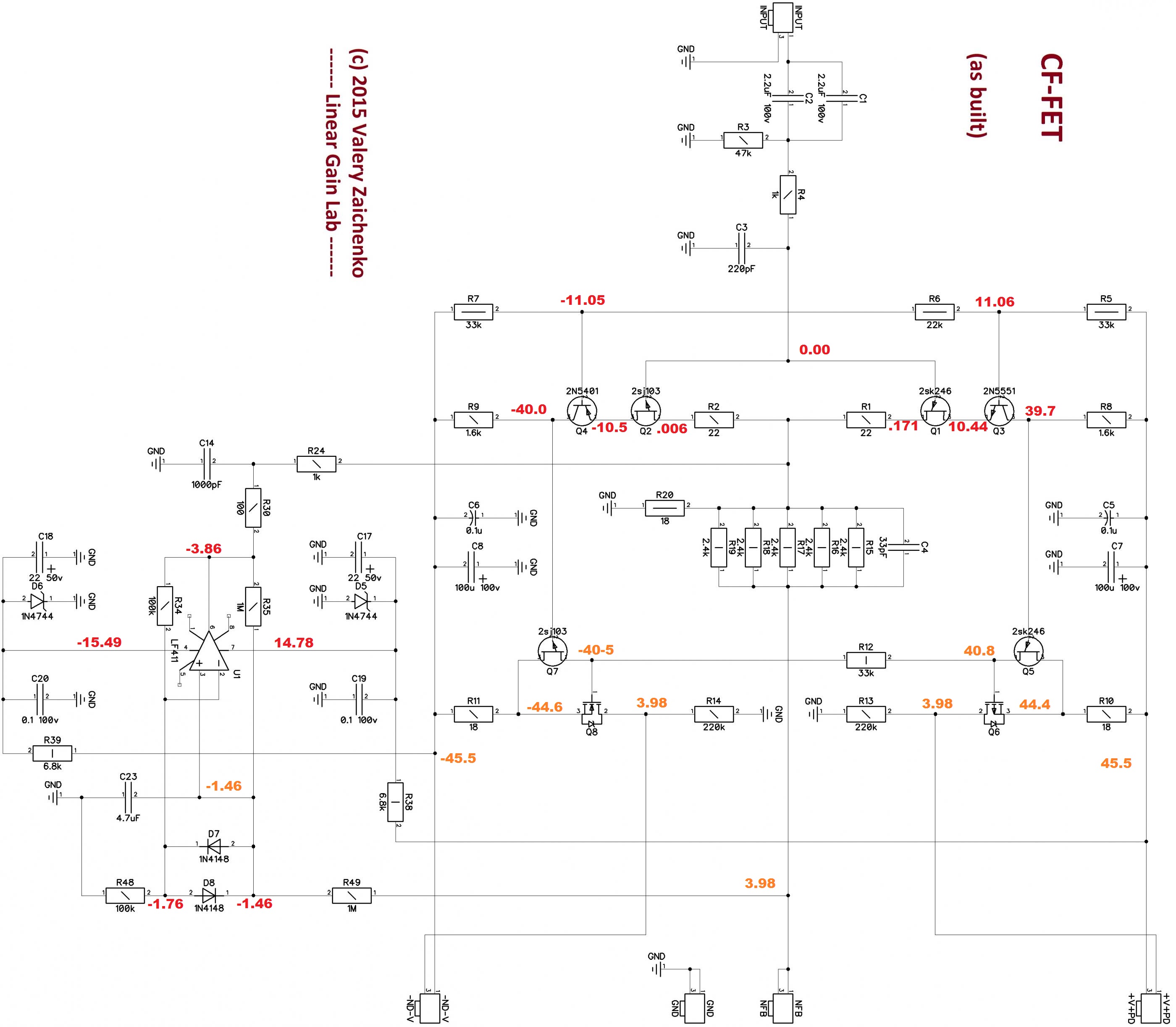

"As built" schematic is attached. Sorry - this one is from DipTrace, better presentation, but different numbering.
Leave R1, R2 as is (22R). It's good to set the VAS current with R8, R9.
R8, R9 = 1.6K -> VAS current = 8mA
R8, R9 = 1.5K -> VAS current = 5.3mA

Hi Valery,

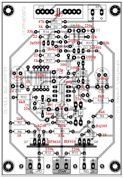

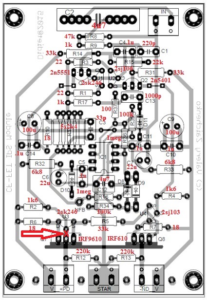

I made the changes but something is wrong. I'm attaching a board image with values. If you have time would you check it over and see if you find a problem? I haven't hooked it up to an OPS yet. I just put resistors between PD and ND and the NFB. I'm reading 65mA output so something is definitely wrong.

Hi Terry, I have checked everything I could and I don't see any mistakes (although, I have used the other layout, this one looks fine to me as well). I have replicated my boards twice and both times they worked fine right away.
Just one thing to check - is there no connection between 2SK246 gate and IRF9610 drain (they are pretty close to each other on the PCB - see the red "X".
Can you please measure the voltage drop over each of the following resistors:
- R2, R4;
- R6, R7;
- R5.
Then we'll see...

Hi Valery.
OK, I just used jumpers between PD and ND to the NFB. These are the readings I have.

I'm attaching some pics in case that might help.

Too much of VAS current... let me think a bit.

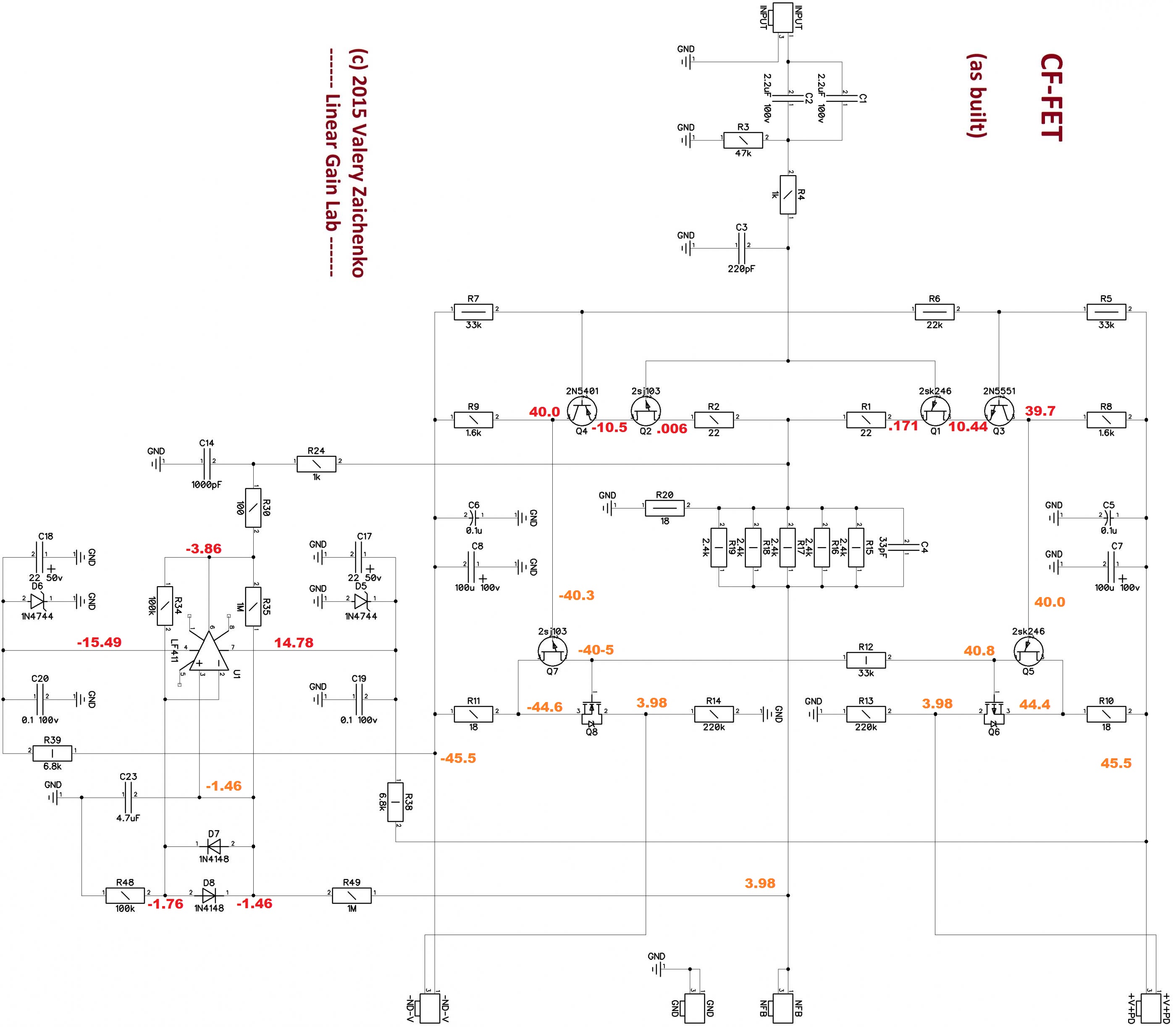

Here is a schematic with voltages. Hopefully this will help.
Terry, I have inspected my final build and also my CF-FET V2 with SMT parts gave me a clue.
First thing - I ave increased R1, R2 to 27R in the final build (and then forgot about it ).
The other thing - as my SMT version has just shown - there may be some difference in transistors' parameters - even though we don't expect them to be that high.
So - please change R1, R2 to 27R and see what you measure over R6, R7 (the voltage will decrease). In case it's still high - increase R6, R7 to, say 47R or even more. The voltage will stay the same in this case, but the current will decrease because of the higher R values. You can do it with no hesitation, nothing will break, just the VAS current will decrease. My boards' VAS runs at 11mA (with addition of 2.5mA through R5, 13.5mA goes through R6, R7).
This part of the circuit is difficult to simulate because the simulated VAS current value is lower than the one I've got in the real life prototype.
Hi Valery,
I changed out R1 & R3 to 27R. Very little change.
I tried 47R for R6 & R7 and that brought it down a little.
I now have 68R there. For some reason the two channels are different. I'm guessing difference in gain of the various transistors but not sure. Here are the readings I'm getting now.
