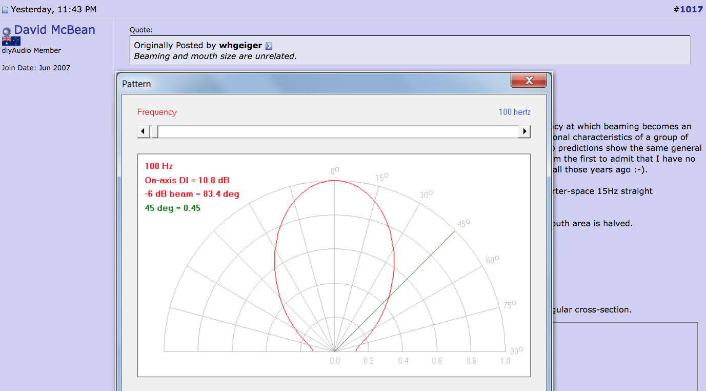

The lobe is huge and comparable to the dimensions of the horn.
I have not received a site plan requested from the OP.
At the frequencies of interest, the intensity and arrival time difference cues are at their vanishing points. For basically the same reasons we cannot detect the individual frames of a video program. WHG
As can be seen from David McBean's diagrams, the thing that's been missing in this debate using proof-by-pictures is the listener's distance from the horn and other clues to dimensions. If we take the image of sonic desolation outside the 6dB trace, just how many feet are we talking about?
What is now helpful is the actual dimensions in feet or meters of the coverage lobe. And to see that image overlaid on the sketches of the yard and seating (or tubbing*) locations.

2) If David McBean's simulation in post 1017 is correct, and based on my experience with large bass horns, it "looks" about right to me, the 15' bass horn would be only 83.4 degrees at 100 Hz, 7.6 degrees less than the 90 degree mid and high horns used in typical horn systems.
For the low mid horns to have a similar beam-width at the crossover point, they will also have to be quite large. There is nothing wrong with a gradually expanding pattern at progressively lower frequencies, but the "waist-banding" at 100 Hz the huge horn will produce is definitely not a "hi-fi aspiration".

Hi Bill,
Your proposed design should work very well indeed .
By using T = 0.6 and having in effect a "conical" expansion in the horizontal plane, I assume this means that the initial roof flare near the throat will be negative, to maintain the correct overall hyperbolic-exponential cross-sectional area expansion rate. Is this correct?
Many thanks. I look forward to seeing further details of your proposed design in due course.
Kind regards,
David
