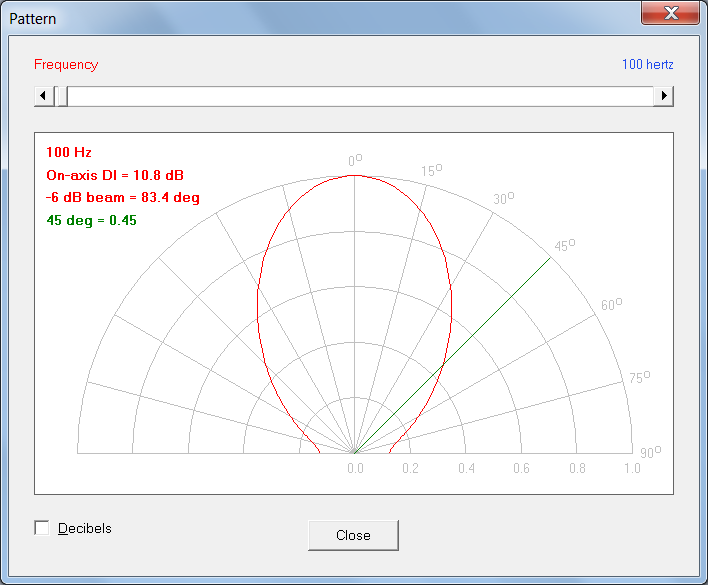

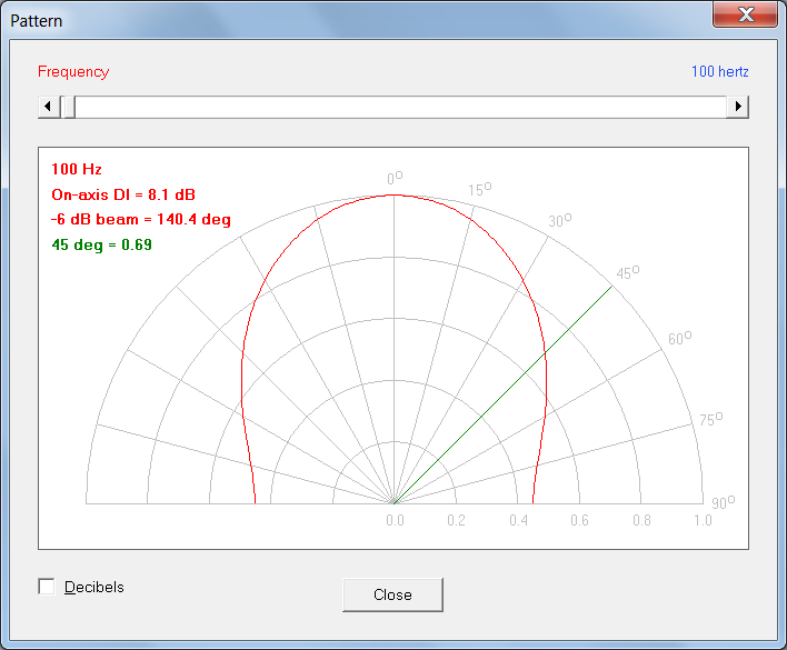

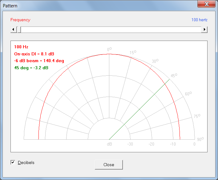

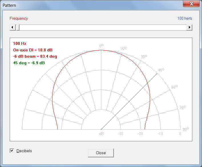

My thinking was that if I built (qty 4) 1/8 space horns, that the individual stereo channels would be too small - where only mono signals would be properly loaded into half-space.
In practice though, are the left and right stereo channel signals likely to differ much down around the horn flare cutoff frequency of 15Hz?
Smaller horn mouth sizes would mean less concrete, and less beaming at higher frequencies.

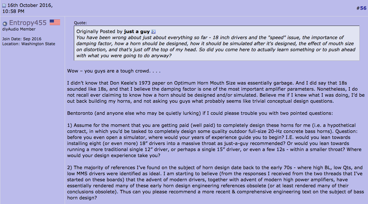

I specifically answered your question placed on 10/16/16 when you asked :
Assume for the moment that you are getting paid (well paid) to completely design these horns for me (i.e. a hypothetical contract, in which you’d be tasked to completely design some quality outdoor full-size 20-Hz concrete bass horns). Question: before you even open a simulator, where would your years of experience guide you to begin? I.E. would you lean towards installing eight (or even more) 18” drivers into a massive throat as just-a-guy recommended? Or would you lean towards running a more traditional single 12” driver, or perhaps a single 15” driver, or even a few 12s - within a smaller throat? Where would your design experience take you?
You never indicated you so much as gave even a perfunctory review of my answers to that and dozens of others I have graciously answered.

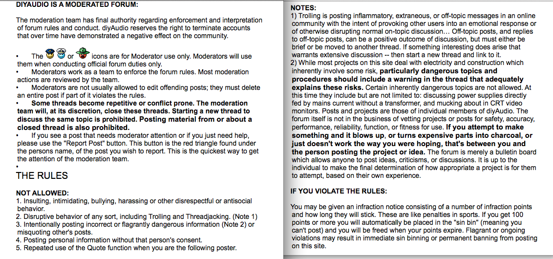

Eric, you and your troll have violated the five DIY audio forum rules listed attached below.
When I'm writing free advice to people who consistently and persistently ignore or misinterpret said advice, I'll write whatever I feel, so long as it conforms to the rules of this moderated forum.
The next time my posts are trolled, I will report said troll to the moderator of my choice, who will remove the troll post, and may ban the author, and/or lock the thread.
David,
"Less beaming" is a polite understatement ;).
As far as left and right stereo channel signals being likely to differ much down around the horn flare cutoff frequency of 15Hz, it all depends on the engineer of the recording. Most "good" engineers generally "center" low frequencies in the mix.
Many of recordings from the early days of multi-track were mixed with the bass guitar and the drums on separate tracks exclusively panned either left or right. Although those older tracks generally have little content below 50 Hz, the pan-pot "mix" of instruments with content down to or below 50 Hz may often be heard from either side of a stereo system.
Some halls have profound reverberation modes that extends down to 15 Hz and below, if music is recorded using stereo microphones with response that goes that low, the venue's sonic "fingerprint" will be preserved.
More than ever, there are recordings made where low frequency "sounds" are panned or modulated at various rates and intensity. Those recordings can not be duplicated accurately without stereo bass enclosures.
This is not meant to imply that mono bass can't "sound good", only to reiterate that it won't reproduce a stereo mix, regardless of where the mono sub(s) are placed.

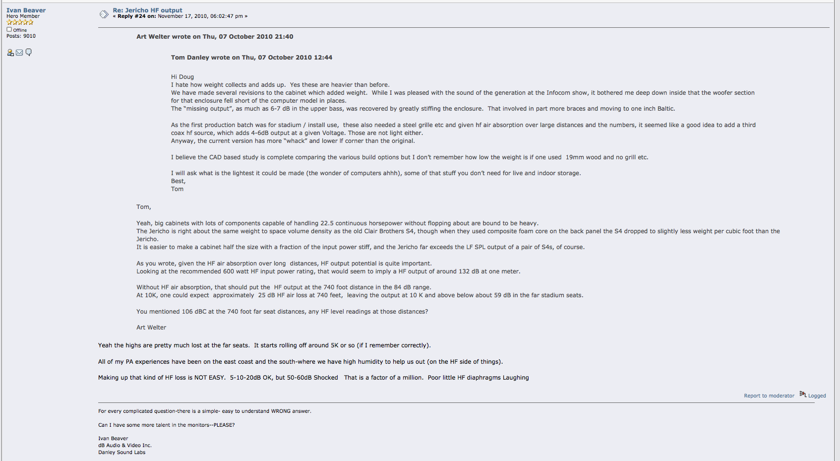

The exchange attached below between Tom Danley, myself, and Ivan Beaver around this time six years ago are indicative of the differences that may be encountered between simulations, and the measured response of loudspeaker hardware built to make a reasonably accurate reproduction of the signal that sounds like the source recording or microphone output signal.
Of interest, both Tom and I did later come up with two different solutions to "solve" the HF absorption problem, though my "preferred embodiment", the Hyperboline, uses far less than the 64 drivers his "Mosquito Beater" does to achieve the same HF SPL at a given distance :^).

Attachment 1 shows the Hornresp-predicted 100Hz polar response for one of Entropy455's proposed quarter-space 15Hz straight exponential horns.
Attachment 2 shows the predicted 100Hz response for the same 15Hz horn, foreshortened so that the mouth area is halved.
Attachments 3 and 4 show the same results as in attachments 1 and 2, but scaled in decibels.
Kind regards,
David
EDIT - I should have clarified that the results shown are for an axisymmetric horn, not one with a rectangular cross-section.

As can be seen from David McBean's diagrams, the thing that's been missing in this debate using proof-by-pictures is the listener's distance from the horn and other clues to dimensions. If we take the image of sonic desolation outside the 6dB trace, just how many feet are we talking about?
What is now helpful is the actual dimensions in feet or meters of the coverage lobe. And to see that image overlaid on the sketches of the yard and seating (or tubbing*) locations.
