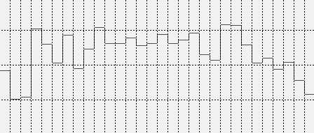

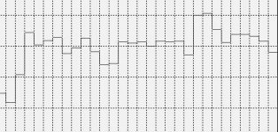

True. For that particular speaker high DF improves the initial response (the antiphase spike is almost absent) but makes little difference to the rest. You prefer the low DF sound. That is your choice.
First that driver is not my choice because I don't like fullrange drivers with whizzer cone. The point is just that generalizations simply don't work for best results. Period.
The bass loading of that driver was a resonant type with actually two added resononces, one above and one below the driver resonance and yet they do not appear anywhere.
The improvent on the overshoot is just theroetical because it only shows up in anechoic conditions in a very narrow frequency range around the resonance. The tiny peak at resonance completely disappears in normal listening room. Room modes rule.
With other kinds of bass loading like sealed box or 1/4 wave transmission line one might not even get that, if properly done!
Instead the overall performance is measurably and audibly better aross 99% of its frequency range. It's not simply opinion but facts.
The in room FR clearly shows (high Zout on the right and low Zout on the left) that there is abosolutely no problem whatsover at low frequency. On the other side the low Zout doesn't solve the issues related to the whizzer cone as this is not "connected" and calls for a tweeter! Imagine the total disaster of a full range with a whizzer cone + a tweeter crossed-over at 2-5 KHz....
The 3-5 KHz peak is due to the whizzer cone. Nothing can be done about that whitout degrading overall performance.
I didn't say that the driver is your choice. You said that you preferred the sound with high Z/low DF over the alternative - that was your choice.
The 3-5kHz peak seems to be more noticeable in the high Z plot because the lower frequencies are attenuated. My reading of the plots is that low Z has a better frequency balance, although both are lumpy because of the room.
If there is a cabinet resonance interacting with the speaker resonance then the coupling to the electrical end may be weaker. However, it remains true that most speakers are designed for voltage drive and most amplifiers (tube and others) are designed to provide voltage drive.
