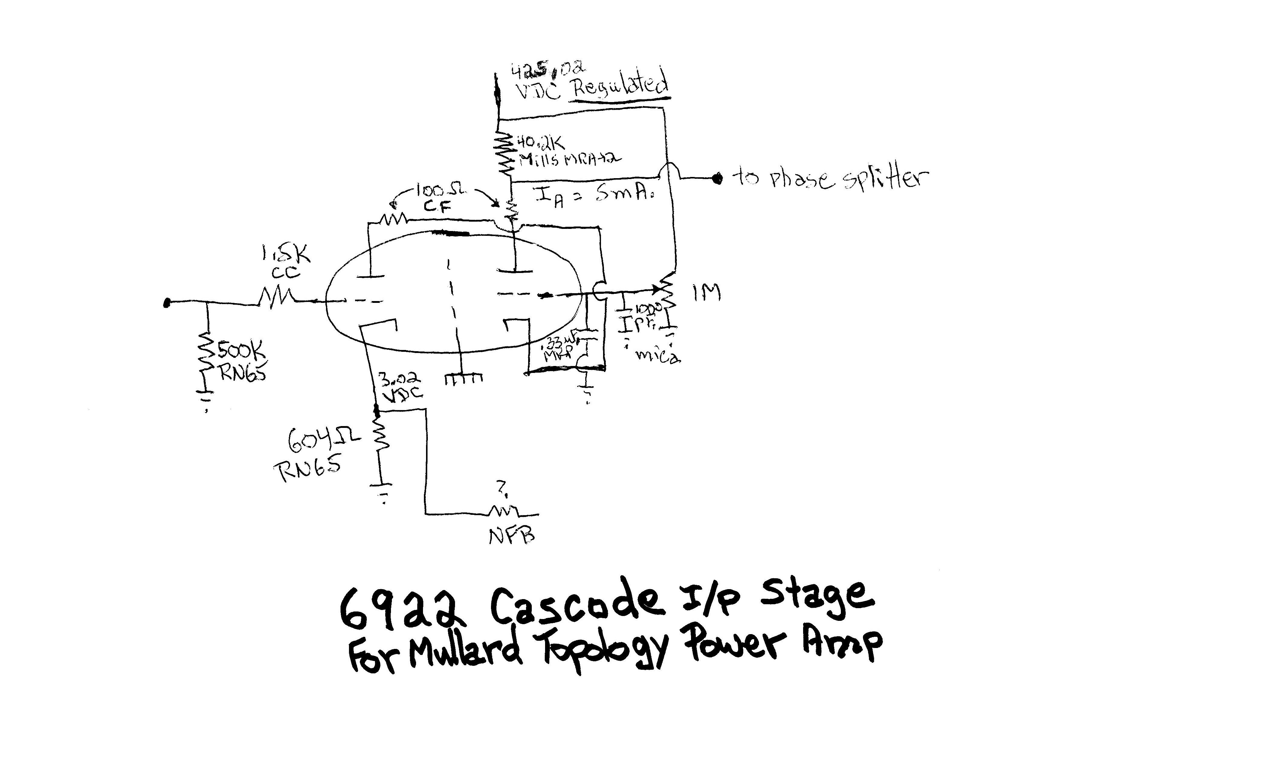

The remark about avoiding high NFB amps is an oversimplification. The H/K Cit. 2 has something like 36 dB. of NFB in 3 nested loops and it is among the very best amps ever made. Not only honest as a Summer day is long, the "Deuce" is (sic) unconditionally stable. Unfortunately, the superior O/P "iron" Stu Hegeman designed around is not available.
Perhaps building along the lines of the H/K Cit. 5 makes sense for the OP. The superior implementation of Mullard style circuitry will do well with decent, if unspectacular, O/P trafos and power O/P is large enough to make many a commercial speaker feasible. The 12BY7 shown is getting scarce, but the 6922 cascode I've provided is a reasonable replacement. Decent 6L6GC class tubes are available for "finals".
FWIW, I'm not a fan of "simple" SE 300B setups. IMO, excessive 2nd order HD is present. OTOH, a SE 2A3 is linear, but only 3 or so W. are available.
