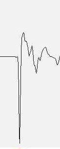

On the issue of amplifier output impedance, output Z is reduced by negative feedback. Transistor amps usually have much more negative feedback for various reasons, so a lower output Z. Lower output Z means that the amp is more capable of forcing the reactive speaker to follow the amps input signal. When a low feedback tube amp is used (which the hard core tube amp addicts seem to love), the reactance of the speaker is significantly less controlled due to the amps higher output impedance, which can be anywhere from about 1 ohm to 8 ohms from my experience.
Nothing like that!
Attached there are the impulse responses (over precisely the same time window) of an affordable 8" full-range with whizzer cone (so no crossover) driven by low Zout amp (DF>100) and relatively high Zout amp (DF<2, typical valve amp with no feedback). The only thing that the low Zout amp does is damping the initial overshoot (left image). For the other amp this damping effect is visibly less. However for the rest of it the high Zout amp is the clear winner as the decay is cleaner and faster! I would say, having listenened to it, the high Zout amp has more control as the intial overshoot is a very short transient that has negligible impact on the end result.
