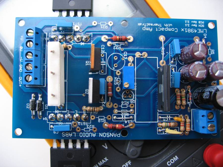

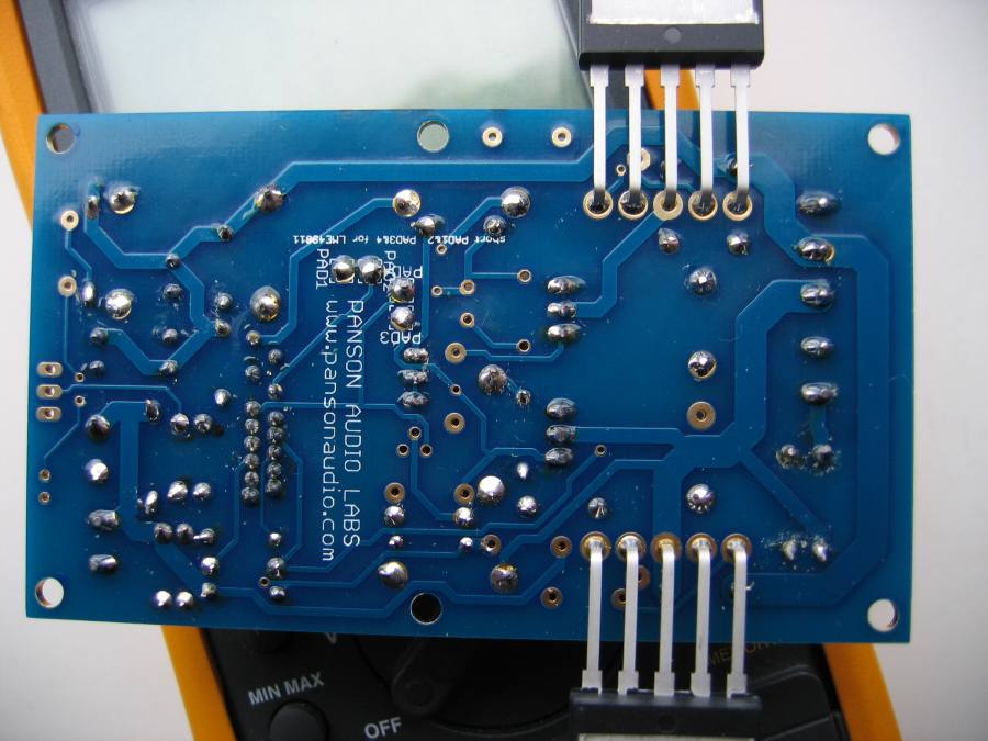

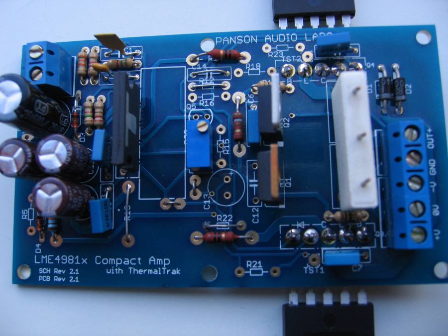

I just soldered it but it is too late to test/measure it so I want to show you my "skills". Please Panson, can you check my board before I put +/- 45 V on it?

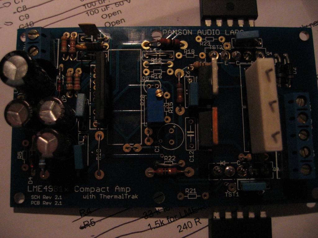

The lighting of the last photo (Compact amp) was not right. I can't see thing clearly. Please take another photo with proper lighting. Thanks!
Had to wait for the sun to come up
Better lighting
Better lighting

You have all e-caps and diodes in correct position. You should add heatsink to LME49811, Q1 and Q2. I think you have change some resistors' value slightly. Gain setting R7 and R8 should meet the min gain specified in the data sheet. You seem to use 330R for R7. The gain is a bit lower than 26 dB which is specified as the min. in the data sheet.
Please don't forget to set the trim pot to min resistance. Use two 10 ~ 33R 2W resistors at the rails to limit current in case of problem. Short the input to ground as well. Also make sure you supply is operating properly.
Measure the voltage drop across the above current limit resistor. You should not see any voltage higher than 1 V. Then check output DC offset level. It should be less than 10 mV.
Panson
Panson

Thanks for looking at my project. Since you used different caps I wasn't sure about them so that's why I put the pictures on the internet. The silver mica looks different and the 460pf too.
ps. your "Sea of Caps" looks quite like mine
-they are 220 and 5k6 (at least, should be )
-is that turning it clockwise? or counter-clockwise? Turning it clockwise makes the resistance between r12 and r22 the least. (+/- 2 ohm at the moment)
-you mean 2w resistors between the psu and the compact amp pcb?
-k, I'll do that.

Please check the resistance between R12 and R22. Make it zero ohm.-is that turning it clockwise? or counter-clockwise? Turning it clockwise makes the resistance between r12 and r22 the least. (+/- 2 ohm at the moment)
Yes.-you mean 2w resistors between the psu and the compact amp pcb?
Yeap.
