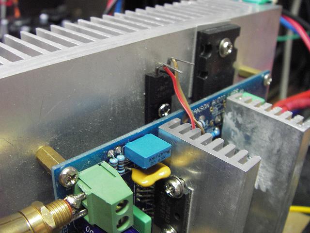

Thermal tracking exercise
Here I continue my last experiment using two diodes attached on the main heatsink for thermal tracking (one shown in the picture). The two diodes' forward voltage, a 500R trim pot and ThermalTrak diodes set the bias level.
The initial bias level was adjusted for 23 mA passing through the output devices (5 mV across 0.22R emitter resistor). The heatsink temp is 30 C when the amp is idle (room temp = 28 C). Input signal was then applied for output 36 W into a 4 Ohm resistive load. The input was removed when the heatsink temp reached 50 C. After 10 sec, the Re drop was 6.4 mV (29 mA), heatsink temp was 48 C. When the heatsink was 42 C, the Re drop was 6.0 mV (27.2 mA). When heatsink was 37 C, Re drop was 5.6 mV (25.5 mA). The tracking performance is still not "perfect", but much better than only using TT diodes. More effort needed.

What is the bias level do you currently use? If the output device bias level is 22 mA as used in my test, they will not get hot for low level output. Do you have heatsink for LME and driver? The temp of them seems normal. You can try to test the amp with a power resistor load. Let it run for 1/3 rated power for, say, 30 min. The output devices should then be very warm.

I think 2 things. I think the combination of relative low ohmic output resistors and the relative small heat-sink in combination with your high bias levels result in thermal runaway. I think your bias levels are to high and suggest you lower them between 20 and 25mV over each Re.
higher output resistors like 0.22Ohm or 0.33Ohm gives a bit more thermal stability.
Also if you adjust the bias, let the amplifier warm up first, then adjust, wait again and adjust.
Keep in mind also, if you measure bias just after a period of (loud) listening levels, the amplifier and bias need time to go back to idle. Normal this takes about a minute of 1 or 2.
Also a question to Panson. Isn't it that only two termaltrak's have not enough diodes for accurate thermal tracking?
Yes, it is. This is why I use two extra diodes to get better thermal tracking as mentioned in post #145 of this thread. The result is not perfect, but much better.
