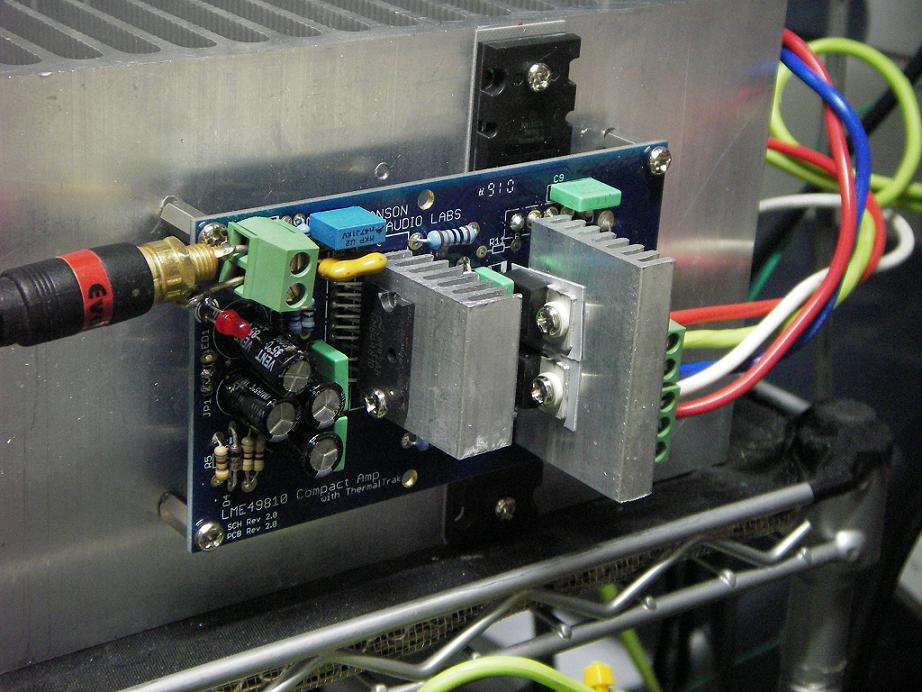

Hi everyone,
This is my new 49810/49811 + ThermalTrak Amp intended for low output power (Class-AB/B, <= 60 W). Output stage is driver + emitter follower. I have not put the heatsink for LME and driver (too noisy to do metal work in the midnight).

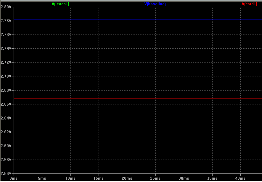

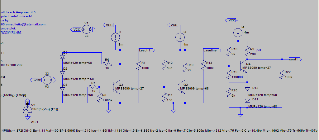

Panson,
I got both my Leach bais configuration and Cordell bais configuration for thermal trak working. The Cordell is tweaked a bit from his diagram - I decided to simulate both schemes to see how they react to temperature.
The values shown were adjusted to 2.93v at 27deg c. Then I changed the simulation temperature to 68deg c and ran it again. You can see that the Cordell version stays closer to the baseline Vbe which assumes that the Vbe transistor has a perfect thermal connection to the output transistors.
Ken

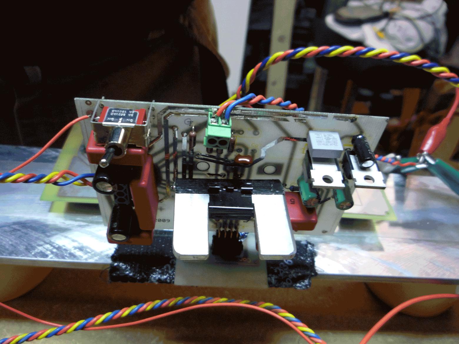

Yes, using your modular approach, I now have three boards, the LME49811, with DC Servo, a board for the bias resistors, and the output board which contains the VBE transistor, predrivers, drivers and Thermal trak output devices. I put jumpers at the T Trak so that I can use either two, three or four of them in series. I had to make some mods to the driver board to go from the Leach bias scheme to the Cordell scheme. The photo shows the Cordell scheme. Note that I had to put pairs or resistors in series to get the correct resistance. Seems you never have the right stuff on hand regardless of biweekly DigiKey and Mouser orders...
My shop computer with the highend sound card died, so, no THD tests for a few weeks. But, played it with both bais schemes and it sounds great, also, sine and square waves look smooth and clean on the scope.

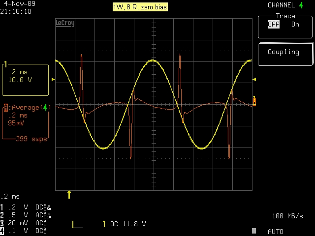

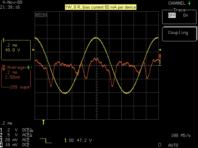

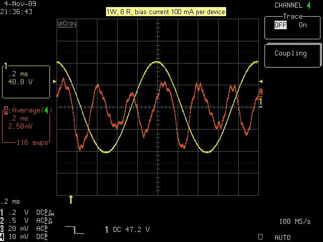

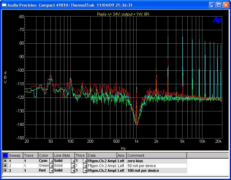

What is the bias current to get the optimum result ?
Peter,
I have some more data which should be able to answer your question. The output waveform (1W/8Ohm) and THD residual are monitored for various bias levels. FFT of the residuals are also shown in the figure.
You can see very large spikes of cross-over distortion for zero bias. When the bias current is 50 mA per device, the cross-over distortion is reduced substantially (notice the vertical scale). At 100 mA bias level, we see no more cross-over distortion. The distortion is mainly contributed by 3rd harmonic.
I use 0.22 Ohm emitter resistors (Re) for the output devices. The voltage drop is 22 mV. Optimum Vq (2 Re drop) for EF is 42 mV, as given in Self's book. Here is 44 mV, more less the same. This is the optimum value.

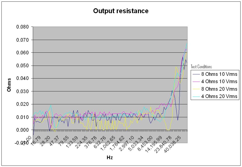

I measured the output resistance. Output circuit output voltage was set to 10 Vrms, 1 kHz. The AP recorded the output level without loading from 10 Hz to 50 kHz. The output level was then measured again for 8 Ohms and 4 Ohms load. The amplifier output resistance is estimated by using the measured data. The measured was repeated for output level set to 20 V rms, unloaded.
It can be seen that the output resistance in audio band is below 20 mOhms. Damping factor, ignoring cable effect, is > 400 for 8 Ohms.
