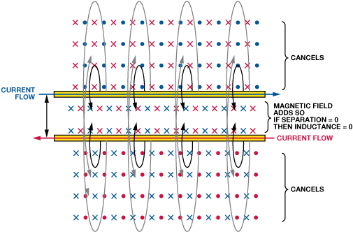

Magnetic field lines around parallel conductors carrying equal currents flowing in opposite directions cancel everywhere outside of the conductors and add everywhere between them. If the inside loop area can be made small, then the total magnetic flux, and therefore the inductance, will also be small.

Can you possibly be serious? You seem to keep insisting that adjacent conductors are not inductively coupled. In which case, no matter whose name you drop, transformers no long work, nor do electric motors, nor does civilization as we know it.
You need to learn the topic. Until you do, you will continue with some very bad understandings.
But who am I to argue with an expert. Have it your way, transformers don't work. At least, as before, the "loop area" question is settled. Turns out there's no such thing.

You did know the subject is AC, not DC? Suggestion: further investigate "varying" or "stationary" flux fields.
Your solenoidal example is incorrect, as was pointed out by others.
Perhaps you should learn the topic first.

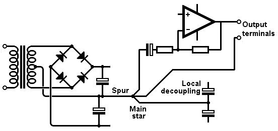

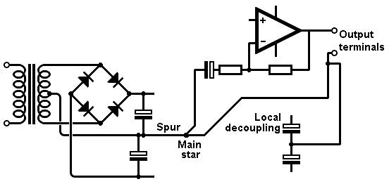

Don't add parallel caps to the PSU smoothing electrolytics. This bad practice can make oscillation worse.
If you add any caps, then they must be snubbers, i.e. a cap+resistor to damp out the oscillation.

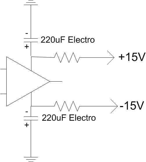

Would that be like this pic, (I did not show the 100nF ceramics, just the electrolytic bypass caps) -a 1st order low pass? If so, what frequency should I shoot for for the cutoff frequency? I was messing around with an online calculator and I noticed that the resistance of the wire/PCB traces to the bypass cap must make it's own snubber with the cap anyway around 50000Hz or somewhere in that area. Is this right? Will this snubber affect the higher frequency ceramics in any way?
I don't try to calculate a frequency. Probably because I can't and possibly because I would not know what to do with the answer.
The power supply cable has impedance, partly resistance and partly inductance.
The RC makes a single pole filter.
The LC makes to 2pole filter.
You end up with a weird version of a 3pole filter.
What would you work out from that if you had the frequency answer?
But your diagram is not right.
The two electros need to connect to each other with a smallish loop area and shortish loop length.
When you analyse the output current loop you find that at high frequencies most of it returns direct to the electros and only a tiny bit goes back to the PSU Zero Volts.
When you add in the HF decoupling and look at VHF currents and include a Zobel which only pass HF and VHF, you will see that almost no VHF curent returns to the PSU and little goes to the electros. Almost all of it returns to the HF decoupling ground. Since this is VHF, it becomes absolutely necessary to keep the loop lengths and loop areas ultra short/small.

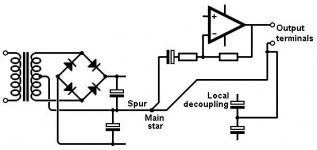

For this exact reason it has always bothered me that the bypass caps are given their own ground return back to the main star. Rationally I want to return them directly to the 'ground end' of the load, then run a wire from there back to the main star. I would love to hear a good explanation for doing the former!When you analyse the output current loop you find that at high frequencies most of it returns direct to the electros and only a tiny bit goes back to the PSU Zero Volts.
That should bother you, since it's completely wrong. The whole point of a "bypass cap" is to bypass the circuit inductance,
not to add even more inductance with a long wire. When you see every ground wire in the circuit run to a single "star ground,"
it is not possible for it to function as well as it should.

EDIT: Looking at it, I suppose it is because the load is so remote that the ground wire leading to the output terminal must be considered an extension of the load impedance.

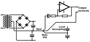

I think the significant question is, "Bypass what?" There are some pretty wild tales along this line, but broadly speaking the object is to shunt anything in the power lines that's not pure DC to ground.
From the National data sheet for the LM1875, paragraphs and some punctuation added by me.
"...to eliminate possible oscillations all op amps and power op amps should have their supply leads bypassed with low-inductance capacitors having short leads and located close to the package terminals. Inadequate power supply bypassing will manifest itself by a low frequency oscillation known as “motorboating,” or by high frequency instabilities.
"These instabilities can be eliminated through multiple bypassing utilizing a large tantalum or electrolytic capacitor (10 µF or larger), which is used to absorb low frequency variations, and a small ceramic capacitor (0.1 µF) to prevent any high frequency feedback through the power supply lines.
"...all sorts of problems can arise from improper grounding, which again can be avoided by returning all grounds separately to a common point. Without isolating the ground signals, and returning the grounds to a common point, ground loops may occur.
"...When designing a layout, it is important to return the load ground, the output compensation ground, and the low level (feedback and input) grounds to the circuit board common ground point through separate paths. Otherwise, large currents flowing along a ground conductor will generate voltages on the conductor which can effectively act as signals at the input, resulting in high frequency oscillation or excessive distortion."
