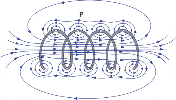

...a straight wire with another wire coiled around it...although the coiled wire does indeed produce flux when a current passes through it...the flux flows harmlessly in parallel with the straight wire and therefore induces no (or negligible) EMF in it.
Let the AC-twisted-coupled thing go, it doesn't matter anymore. Because the theories around here have now gotten downright bizarre. This is in addition to nullifying every high school science demonstration ever conceived.
Lookee, it doesn't matter whether a single conductor is straight, coiled, or formed into a likeness of Mickey Mouse. 1. Given current flow, a flux field will exist around that conductor. 2. A second conductor adjacent will be influenced by that field. 4. "Influenced" in this context means current will be induced in the second conductor.
Everybody write that down, and read it until you believe it.
In the stated case of a coil around a straight conductor, the induced current in the second conductor will be significant. It doesn't matter which is the first or second conductor, flux fields work the same way backward or forward.
If just a straight conductor crosses another straight conductor at a right angle, then induction will certainly be minimal, but whether it's negligible is a different discussion. There is no "zero induction" state.
Sorry, but the idea that "...flux flows harmlessly in parallel with the straight wire..." is just meaningless. That's not how a flux field works. To give just the barest notion of this (there's actually a lot more going on), below is an image from https://www.nde-ed.org/EducationReso.../CoilField.htm
Or if you want to believe otherwise, fine by me. But don't blame me when when all electrical phenomena stop happening when you're around.
Just in a brief sidebar, remember that all of this applies as well to DC as to AC. In the two different cases the question of a "varying" or "stationary" flux field arises, but the rules are the same.
If you look at your flux diagram you will see that in the centre of the coil the flux flows in parallel straight lines, so if you place a straight wire down the centre of the coil it too will be in parallel with the flux, so it does not cut any lines of flux, hence no induction into it. The same principle applies to a twisted pair even though the geometry of the situation is more complicated (i.e. less obvious). OK, nothing is ever perfect; there can always be some induction, but it is much less than if the wires, say, run directly side-by-side in parallel.
And as Mark pointed out, a twisted pair usually carries the same current in each wire but in opposite directions, so the flux fields cancel out, or very nearly so. You wouldn't normally twist a pair of wires which carry completely different signals.

If you look at your flux diagram...if you place a straight wire down the centre of the coil it too will be in parallel with the flux, so it does not cut any lines of flux, hence no induction into it.

Yes this applies for AC; when the current reverses, the flux still follows the same path as in your diagram, but in the opposite direction. It is always parallel to a straight wire in the centre of the coil.You did know the subject is AC, not DC?
Not quite. AC current induces voltage, not current.bentsnake said:4. "Influenced" in this context means current will be induced in the second conductor.
Some geometries can give zero induction in the ideal case, and negligible induction in many practical cases. That is why we use coaxial cable or twisted pair.If just a straight conductor crosses another straight conductor at a right angle, then induction will certainly be minimal, but whether it's negligible is a different discussion. There is no "zero induction" state.
Not certain what you mean by "all of this" but magnetic induction only occurs for varying currents, not steady DC.Just in a brief sidebar, remember that all of this applies as well to DC as to AC.
