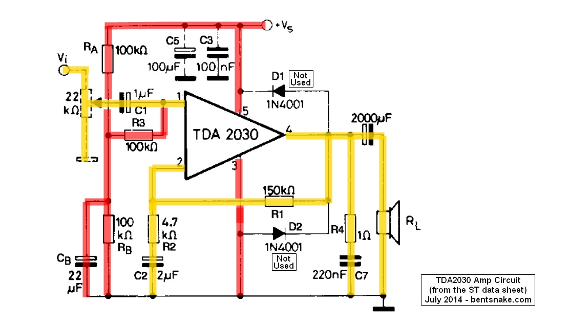

However, I'm glad you said something because it reminded me. I've been meaning to check with you about your post #9 here: http://www.diyaudio.com/forums/chip-amps/259494-tda2030-amp-issue-help.html
For your convenience I excerpt your post below:
post6 shows a 2000uF (2mF) cap acting as aDC blocker and feeding the 8ohms speaker.
Unfortunately the designer has made it into a Filter Capacitor with a turn over frequency of ~ 10Hz.
This will introduce into the output signal.
The Input Filter (DC blocker) is set to a turn over frequency of <2Hz.
If one wants wideband and low distrotion the Output capacitor must be set LOWER than the input capacitor.
You can achieve this by making the 2mF much larger or making the 1uF much smaller.
The Input Filters MUST set the HF and LF bandwidths of the Power Amplifier.
Oops !!! the designer has forgotten about the HF filter. ADD an RF filter as well as getting the LF turn over freqs correct.
C2 set to 2uF is wrong as well. It creates a filter with a turn over of ~17Hz.
Who designed this amplifier?
The "post6" amplifier you refer to I re-post below, again for your convenience. "Who designed this amplifier" is the engineering staff at SG, of course. The highlighting is added by me, but otherwise the circuit is a screenshot, there are no changes. Here's the data sheet: https://www.futurlec.com/Philips/TDA2030a.shtml
I wanted to check with you on whether you'd heard back from the engineers at SG? Have they made the changes you require, is all that taken care of?

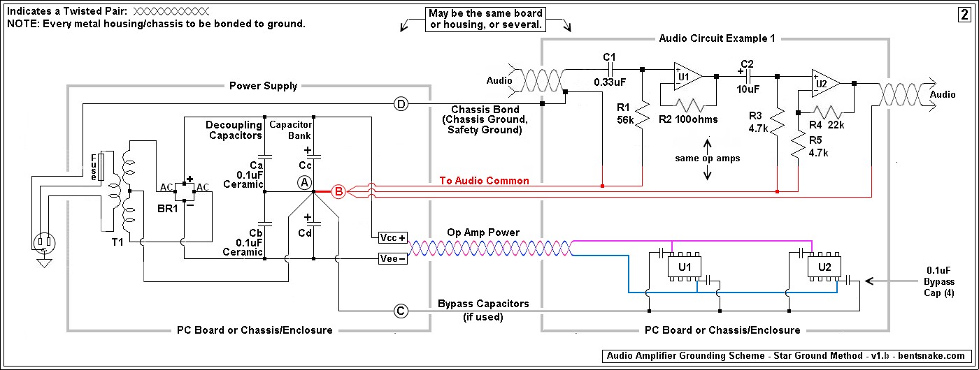

OK I think I see my mistake. Some of my mistakes. One of them.
I asked an open-ended question, which obviously is an invitation to chaos. Sure enough chaos ensued, unrelated pet theories and projects lined up at the door shouting hey looka me, I'm important.
But it's not important unless it relates in some visible way to the circuit I posted. For the following reason.
Contrary to the opinions of those who enjoy making things hard, it's not. Grounding is not arcane or mysterious. Not in the chip amp world.
For proof of this, bang together any single-stage NE5532 circuit. For crying out loud there are three--count 'em--connections to the zero-volt ground point. Run all three grounds to that one point.
How many times have you done exactly this when breadboarding a circuit? Notice anything? Oh yes, son of a gun, it worked!
Of course it worked. Many engineers, and many thousands of dollars spent on research and testing, say it has to work. With these little black chips the only hard thing is making it not work.
Er...usually, that is. There are pitfalls, yes. But to a newbie there are only two pitfalls that really matter: 1. He doesn't know where to start, and: 2. He doesn't know what not to do.
Hence my li'l compendium circuit. To give the poor guy a starting point, a plan of attack. One that will: 1. Work, and: 2. Keep him away from pitfalls unnamed.
It would also be awfully nice if it were: 3. Simple enough not to scare a newbie half to death. The compendium started out pretty simple, but due to valid advices received (ahem) it keeps getting more complicated. Well, I'm working on re-simplifying.

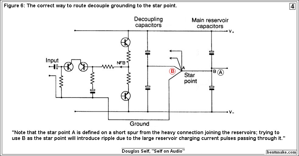

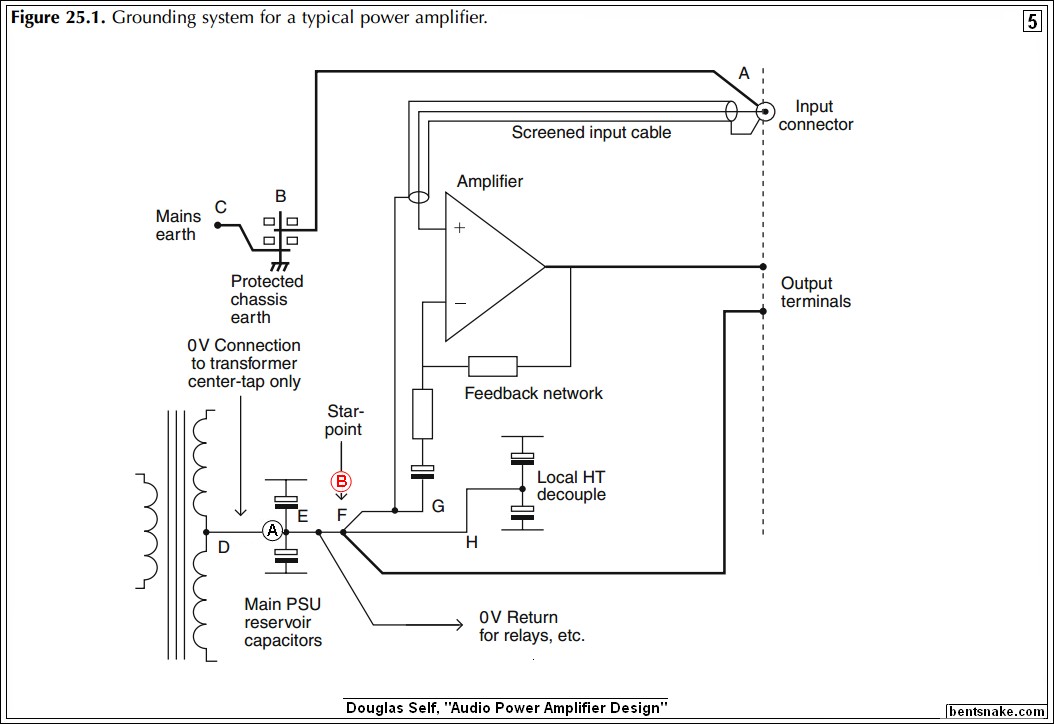

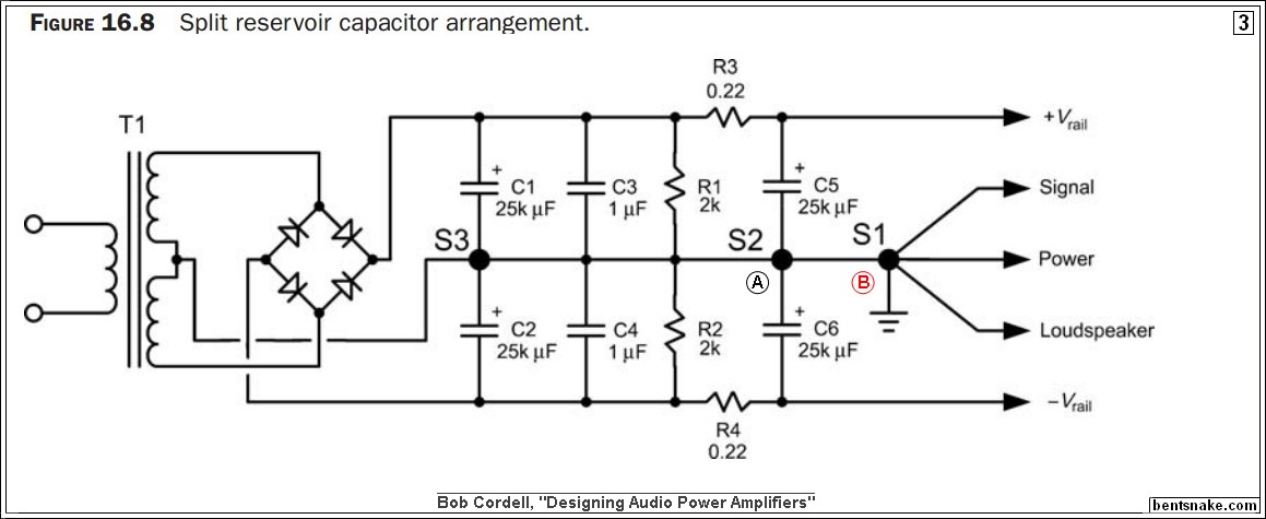

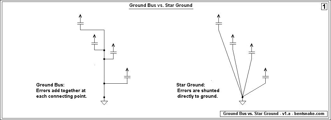

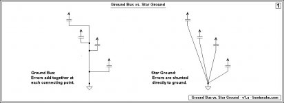

All of which considered, again I post. But this time, hoping to stick more closely to the subject, I include some of the references I've consulted. On the references I've added my own circled A, and red circled B, to illustrate the "common denominator" I'm looking for. Posted below are:

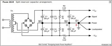

1. My circuit, illustrating, in very broad terms, the bus-star argument.
2. My circuit, the one under consideration, showing my understanding of the references that follow here:
3. Circuit by Bob Cordell, "Designing Audio Power Amplifiers."
4. Circuit by Douglas Self, "Self on Audio."
5. Circuit by Douglas Self, "Audio Power Amplifier Design."

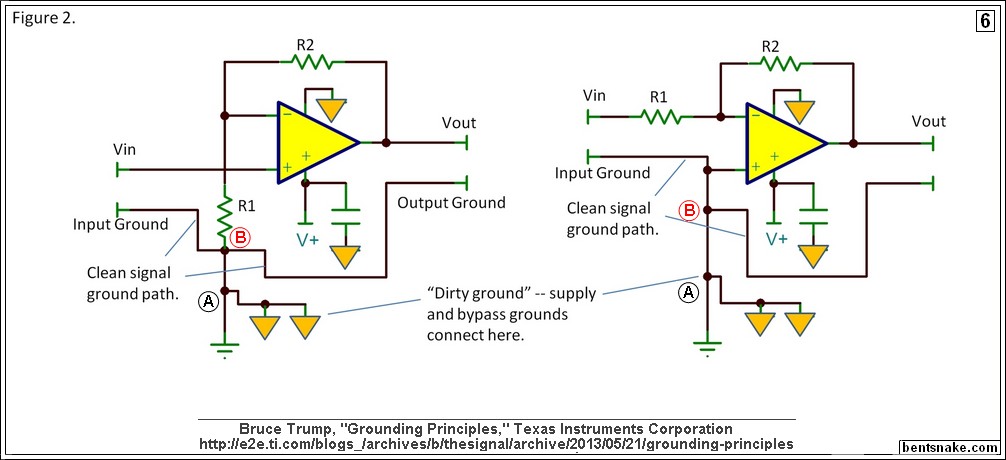

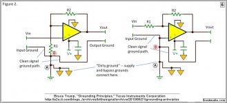

6. Circuit by Bruce Trump, "Grounding Principles," writing for Texas instruments. The complete article is here: Grounding Principles - The Signal - Archives - TI E2E Community
7. Not an individual circuit, but reference is made to Texas Instruments, almost any data sheet, the section on Stability. For example page 7 of the LM1875 data sheet here: http://www.ti.com/lit/gpn/lm1875
The attempt is to gather these and other almost-the-same circuits into a single practical reference circuit, which is intended to be circuit #2 above. Comments and/or corrections that actually do apply to circuit #2 are implored.
