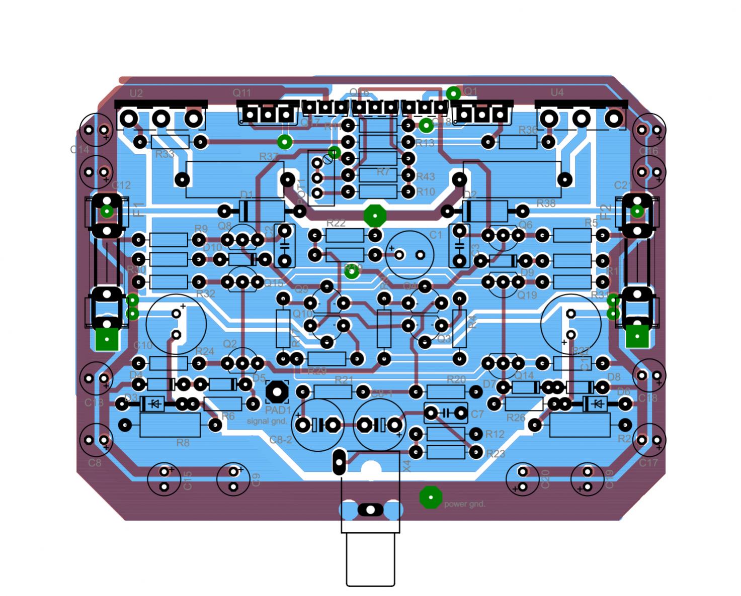

Ignoring the silk that needs tidying. This is the proposed layout that will go to print mid next week.
Kindly make comments especially WSJ, Evette etc
The layout looks good, however, there are a few areas of concern.
The base of Q8 is the amplifier summing junction, with an openloop gain >1,500 (64db) the design goal is to place all components close together and keep this trace as short as possible. R22 could be moved up and C8 moved down to shorten the summing junction trace and reduce the coupling between Q8 base and collector. The trace connected to Q8 collector is connected to the negative supply, which crosses the summing junction trace and is therefore capacitive coupled to the summing junction. Move Q8 collector trace away form the summing junction. Look at all AC signal sources near the summing junction as a capacitively coupled noise source to the summing junction.

R15 and C7 (100 Ohms, 470 pF) look like a lowpass filter for the input, probably for RF. That's a very good idea but the cutoff frequency is kind of high, at 3.4 MHz. I think it would be better to put it at about 1/10th of that. So I'd probably increase the 470 pF to 4700 pF or so.
Regarding the two 33uF caps for the power supply inputs: This might not be overly important, but having them off to the side is not really the best way. The pads for the pins of caps that go in the power trace should be downstream from the power input, and should be situated so that the power rail current must all pass directly through the capacitor's pad, on its way to or from the loads. Usually, if the trace is wider than the cap's pad, it should even be narrowed, at that point, to be no wider than the pad, so that the current must go very near the cap's lead, as it flows past.
R31 seems to be overlapping three other components.
There are quite a few acute angles (i.e. less than 90 degrees), in the top half. Those are known as "acid traps" in the pcb fab industry. There should be no acute angles.
I would probably fill the area around the output trace with the power rail copper, to minimize the enclosed loop area, so it won't radiate so much. Or maybe ground, whatever makes more sense as far as keeping current in and current out close together.
I think that it is risky to not have much more capacitance, much closer to the output transistors. There should also be high-frequency bypass caps, no?
I would also want the 68pF caps (and everything else) to connect very close to the bases, and would want ground plane for all traces to bases (especially signal traces). Otherwise, they are hum and noise and RF antennas.
Since you have another layer that seems underutilized, think about where the currents go, and then how they come back. Those two should never, ever be separated. Otherwise it makes either a transmitting or receiving antenna. (See Faraday's Law.)

about improvements...
I removed the bridge and place a resistor between signal and common gnd.
making sure that no traces would run on top of the output and supply lines and observe track witdth.
As much as possible those tracks that are noisy I placed it adjacent instead to the top.
ACTUALLY THERES NOTHING NEW IN THIS PCB .....it has been a long practice having a separate gnd. return for signal gnd.rather than using a 10 ohms resistor.having a copper plate as the source of my high quality gnd.will separate it from common and signal gnd.
regards,
joel

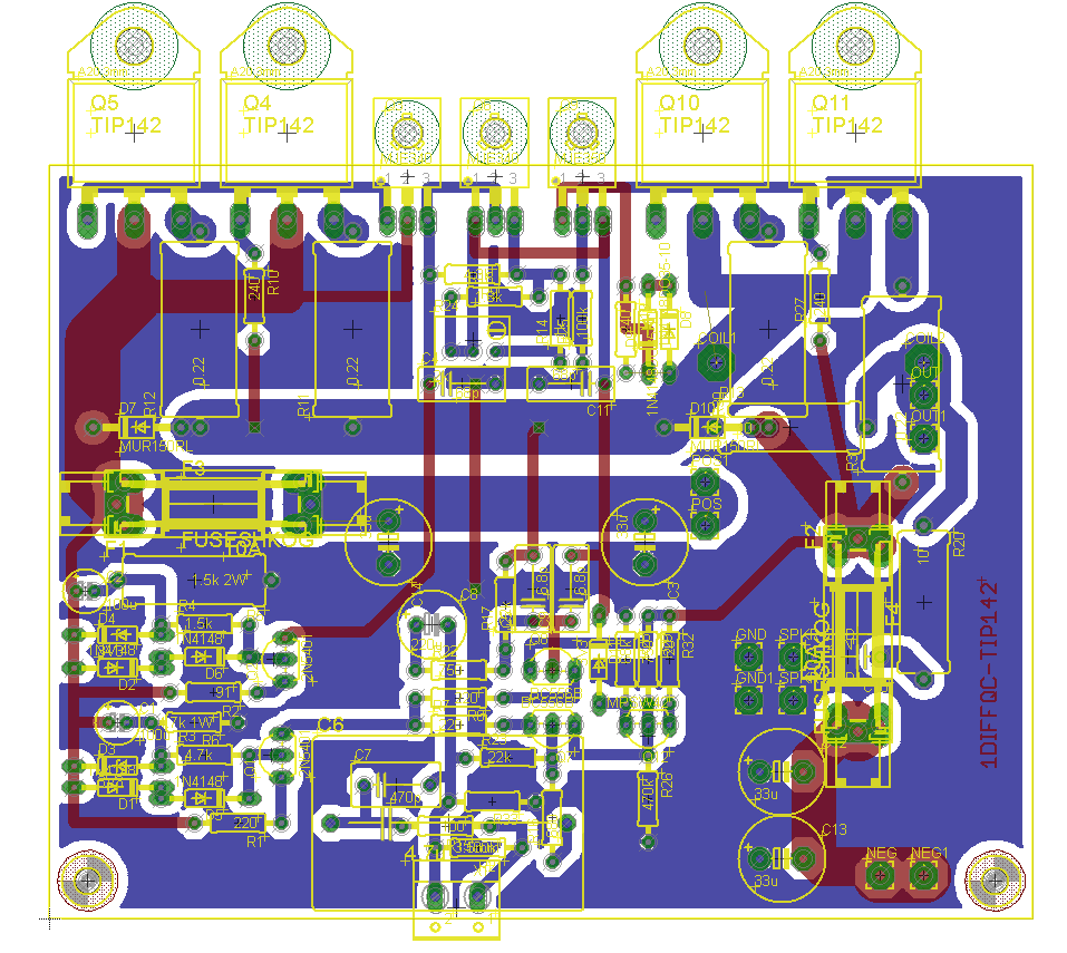

Marvelous design
This layout is fantastic, there is however one possible bottleneck, can you spot it ;)
Comments welcome

Edit: You posted your new layout while I was typing. So some of what is below might already have been addressed.
This is true, however their orientation localizes the flow of high current on the ground. Even with the orientation used, they are bound to respond pretty fast. However will take a second look
Yes, I had thought about that, too. That would tend to make the rails a bit more quiet. As is often the case, we know some alternatives but don't know their relative signficance or merit (Or at least I don't.).
(As you know, this is one or more of my "pet peeves". Apologies in advance.)
Why not something like 2200uF, or much more, or several in parallel?
Even with 33 uF total per rail, several in parallel would divide the impedance to ground, for high frequencies, by the number of caps paralleled. and would lower the impedance for current demanded by the transistors, by the same factor.
These are also the only decoupling caps, meaning that they have to supply the fast transient current demands of the transistors. More capacitance here would also lessen the rail voltage disturbances, for current-demand changes by the transistors, at all frequencies.
Also, putting them closer to the transistors would improve everything above, and would keep all of the large, and fast, and large and fast currents in a smaller loop.
Thanks for the heads up on acid traps. My board house is pretty advanced, they had a look at the gerber files and gave me the all clear. Will take a second look also.
This is not too important. But I would get rid of them. There is also a high-frequency reason for not having acute angles on PCBs, which escapes me at the moment. So it's just considered to be "bad practice". So it would probably be "esthetically disturbing" to experienced PCB designers. That would be enough of a reason, for me, to change them. Note that you could still have almost the same overall trace shapes, if that's important, if just a small part of each corner were straightened or rounded.
Am also thinking about filling that top half with ground copper, but may leave it out.
I don't know how important it might be. I was just thinking of "enclosed loop areas" and Faraday's Law, in this case mainly to avoid creating time-varying fields in the air that might induce corresponding currents in some small-signal loop that also had too much enclosed loop area.
For this circuit my assumption is that since the input and output are filtered, there shouldnt exist high frequency current draws that are in the range of of 1/2 wavelength of the trace. Quite experimental really
The main point was not HF bypass, but local decoupling capacitances near the transistors, to enable accurate supply of the changes in the current demanded by the transistors, and to prevent voltages from being induced on the rail. Othersise the rail inductance will prevent supplying the fastest current changes soon-enough for them to be accurate, and the rail inductance will cause voltages to be induced (on the rail) by all changes in the current drawn. Caveat: How audible any of that might be is still unknown.
Regarding high frequency bypassing: It's for HF positive feedback that occurs through the power rails, locally. You can just try it without them and check with a scope, I guess. But I'm not sure if that would be valid for all conditions that might occur later. Those caps would be small and could be added later, easily, anyway, maybe on the bottom of the board.
Will take a second look, I suspect that these babies handle phase more than high frequency filtering.
You must be refering to the top half. The PCB will be mounted against a ground plane
I think of capacitors as "transient-current supplies" more than as voltage filters, although those two effects are often simultaneous.
The ground plane comment was just another reference to possible "enclosed loop area", which is especially bad to have for low-level inputs to high-gain stages. So I just wanted to suggest that none of those types of traces should ever be hanging out in space, alone, since that would guarantee that there would be enclosed area and then the only question would be how much hum and noise they would pick up. Input signal should always be placed as close as possible to input ground, everywhere. I just wanted to make sure that you checked for that.
I have tried to implement my inderstanding of reducing crosstalk as used in twisted pair cabling. A second look will not hurt.
Its interesting that yesterday I was refreshing up on the 'right hand rule'.
Would you recommend filling the top layer with ground copper ? Has anyone tried this with good results, no parasitic capacitances where they should not be. However the board width could be increased at a cost. What would you recommend ?
See my previous comment about ground plane.
Not sure what I would recommend, without more time looking at it. (I'm not really an expert at any of this, anyway.)
But, ground plane is almost always good, and any parasitic capacitance it makes is almost always a good thing, too (e.g. power/ground capacitance), except maybe at certain types of feedback inputs.
