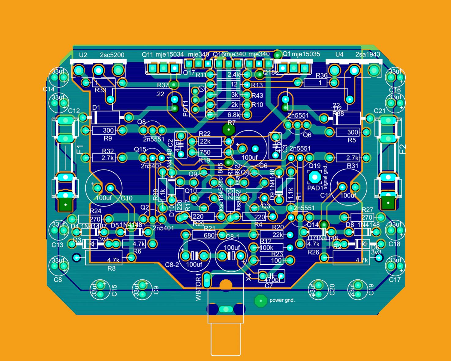

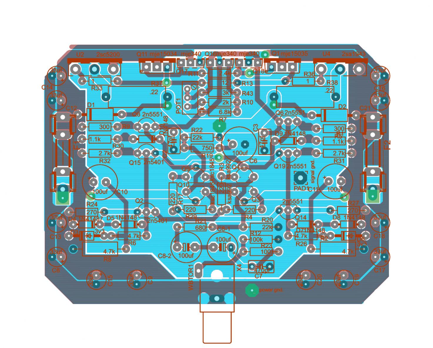

here it is
now I know why you want me to put gnd besides those supply and output tracks.
again this is a two sided pcb composed of two gnd. plain at the bottom(power and signal gnd). with two gnd returns to star gnd.its worth to try experimenting.
regards,
joel
p.s.
forgot the attachment

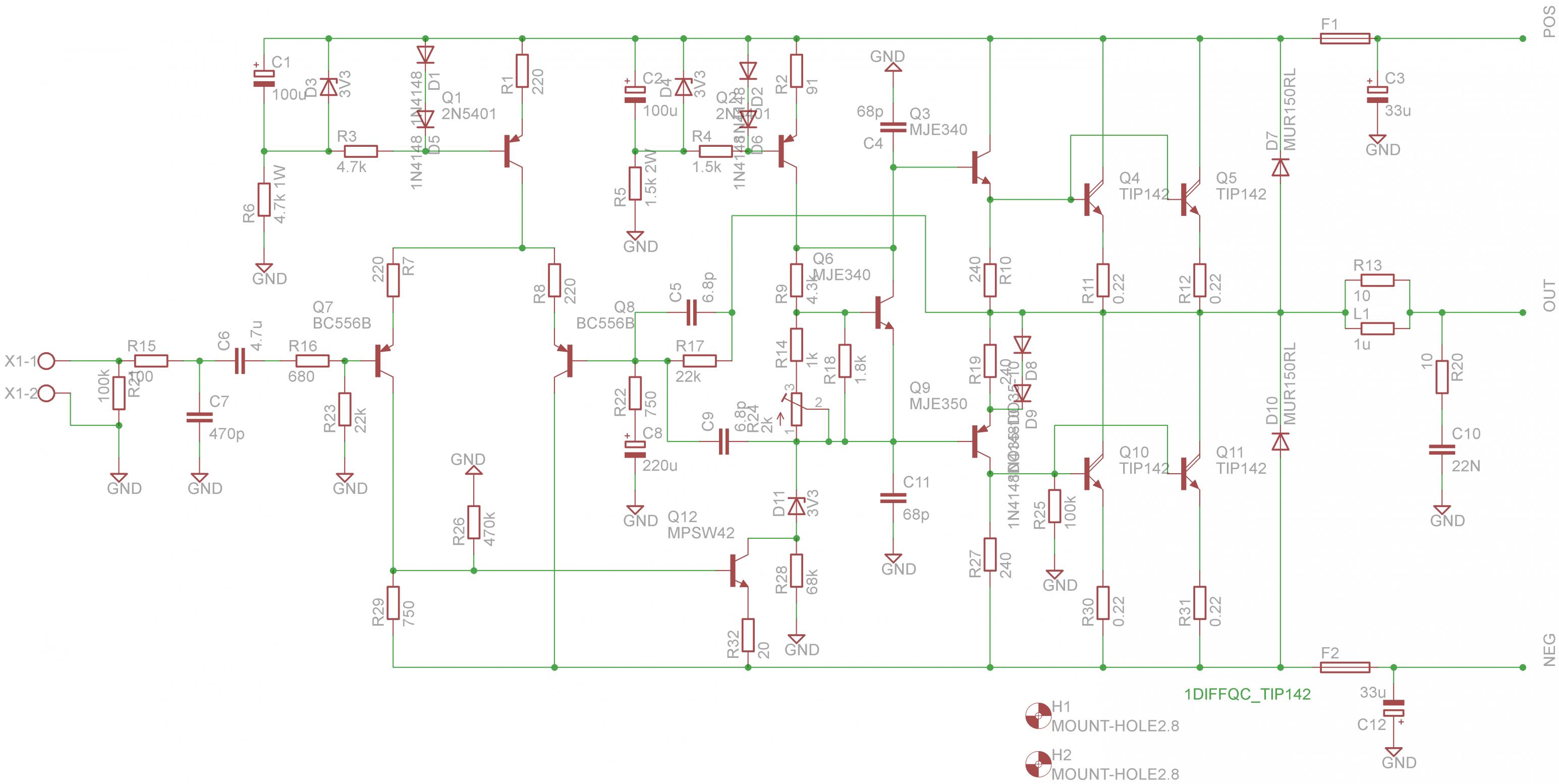

This is the first edition of the schematic that will go with the PCBs.
What connectors would be suitable for the power supply and output on the PCB ? Or is soldered wire preferable ?

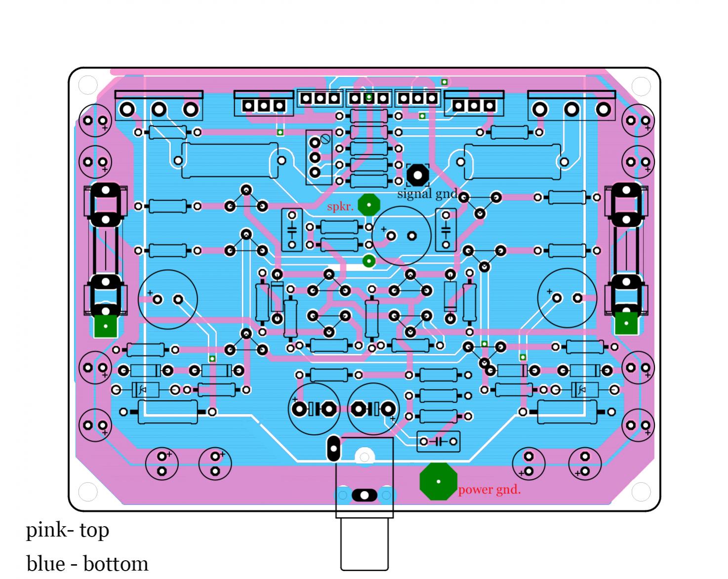

I have put a bridge in here, but still it has a two gnd returns.I have manage to silence the symef with only one gnd return and sure it will not be a problem in here.enclosed in zip is the top and bottom of the pcb. so you could peek.
regards,
joel

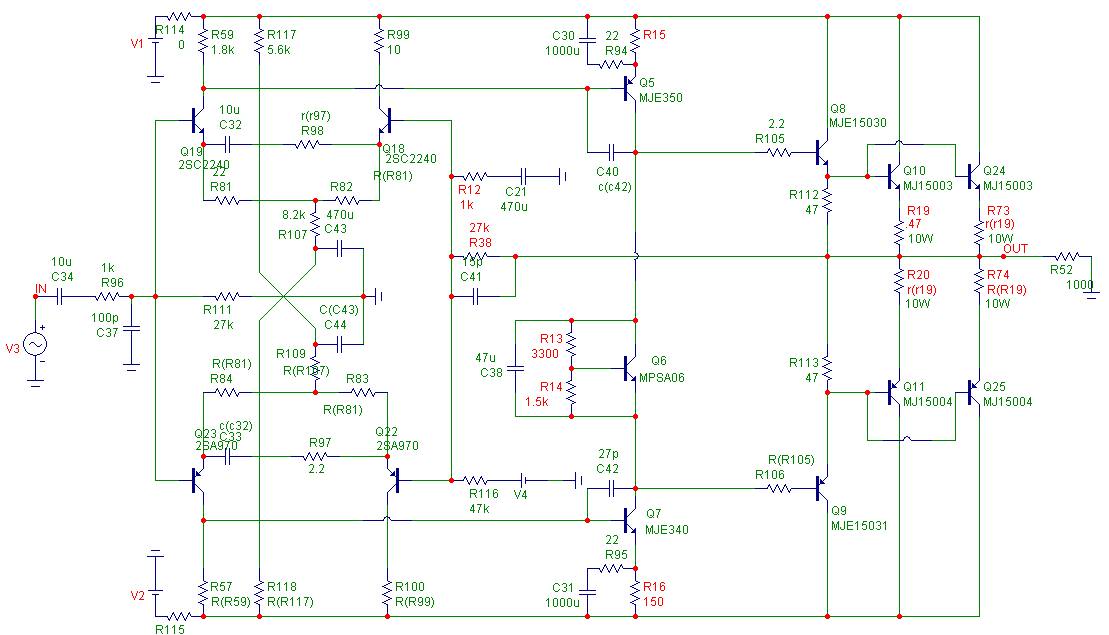

Hi Harrison, the schematic in #1 is very much that of KRELL KSA50 of the early eighties with some minor modifications. The dual complimentary symmetry has a characteristic of sounding more powerful that it really is. In other words a 50w amp sounds much louder than expected. The MJL15002/3 are better suited I think than the 2SC5200
It is a very popular amp and produces very good results.

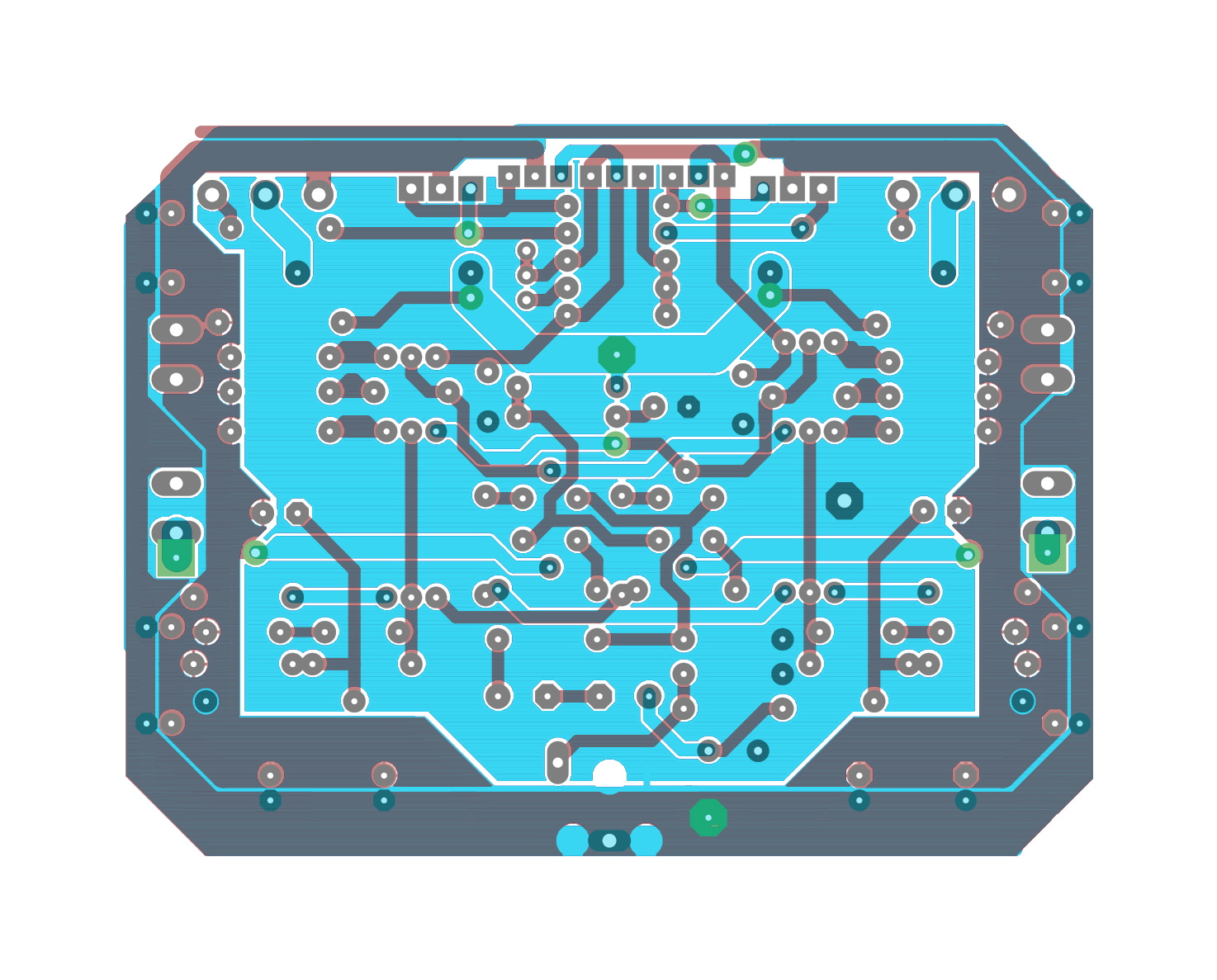

my work is finished...
I believed that I have reach the peak for this amp.I have done some research and making sure that I dont throw punches on air....
theres a lot of advantages offered by a dual and multi-layer pcb and believed this will solved bottleneck and makes the amp. be distinguished from the rest.
regards,
joel

Attach is RAS200 from 1992. Harison, we may have had the same super heroes. Dan Augustino
