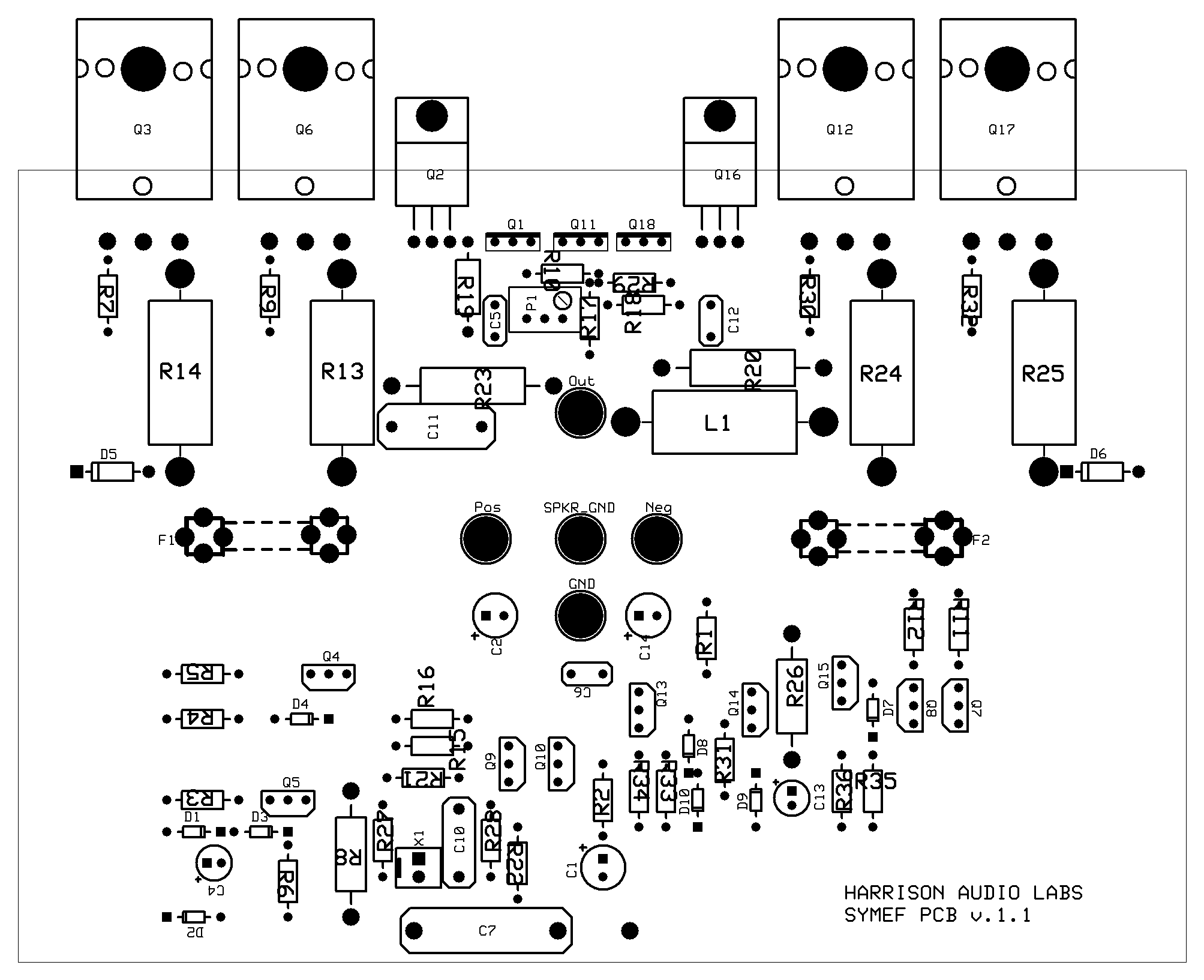

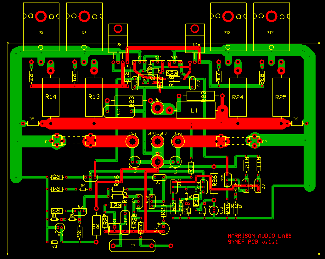

I have played around with many layouts. Some where perfect in terms of layout logic but were physically challenged (they could make great monoblocks with gigantic cases, but this is diy) . There just has to be that balance. I have to say that the current layout rocks.
On the next run however, I want to experiment. There is a layout that I dreamt up the other day that I want to offer on one of these runs, its a slight deviation from what is on the market in terms of laying out PCBs. I do not know how well it will perform, but it looks very promising.

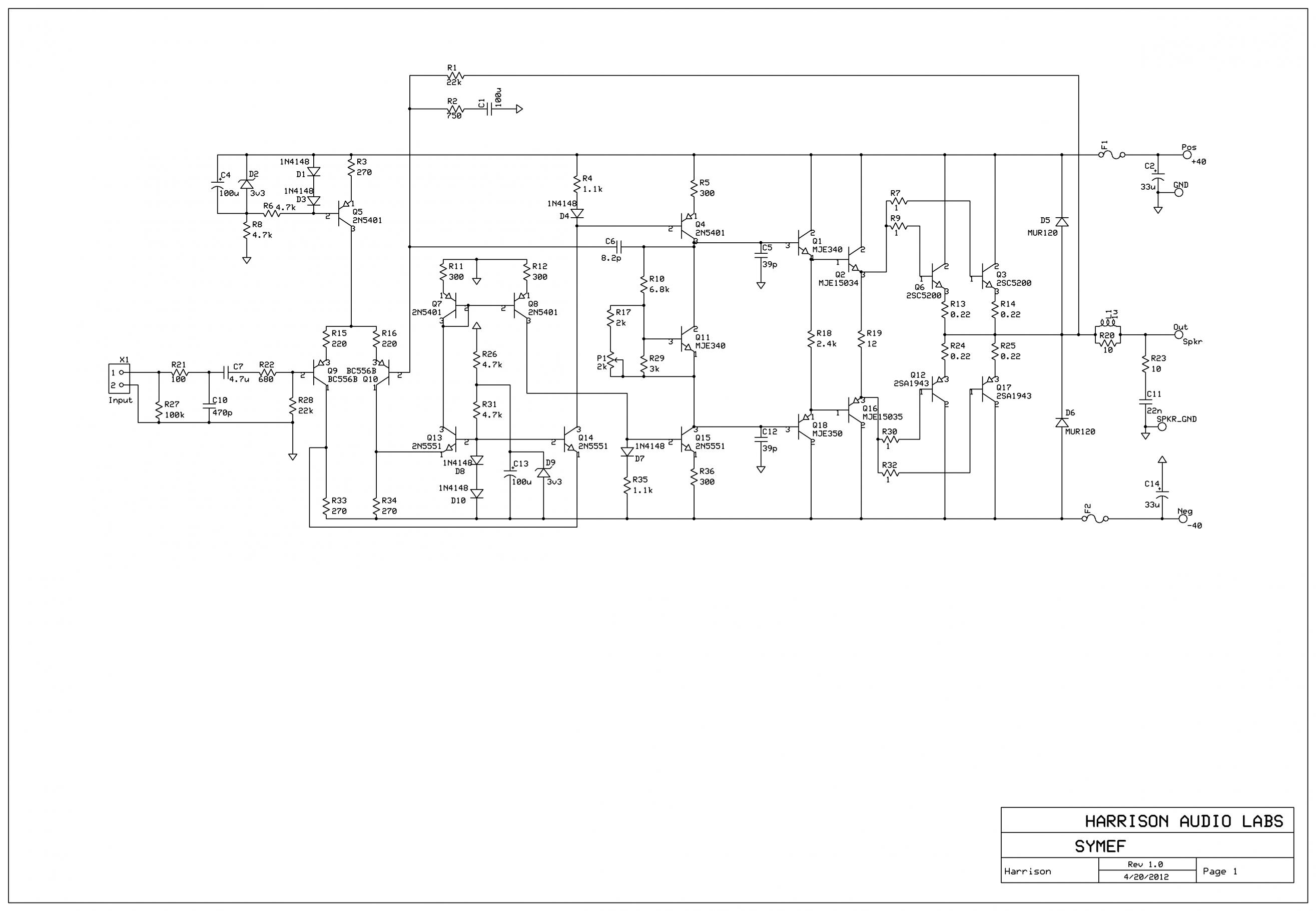

I will post my ideas and you will post yours. Heres a start.
Harrison,
Your layout is actually very favorable for good performance, but I would like to see you decouple the driver side from the power side with a diode per rail and place a few hundred uF for driver reservoir. In my opinion it would be closer to perfection. There is more than enough space on the board for this mod.

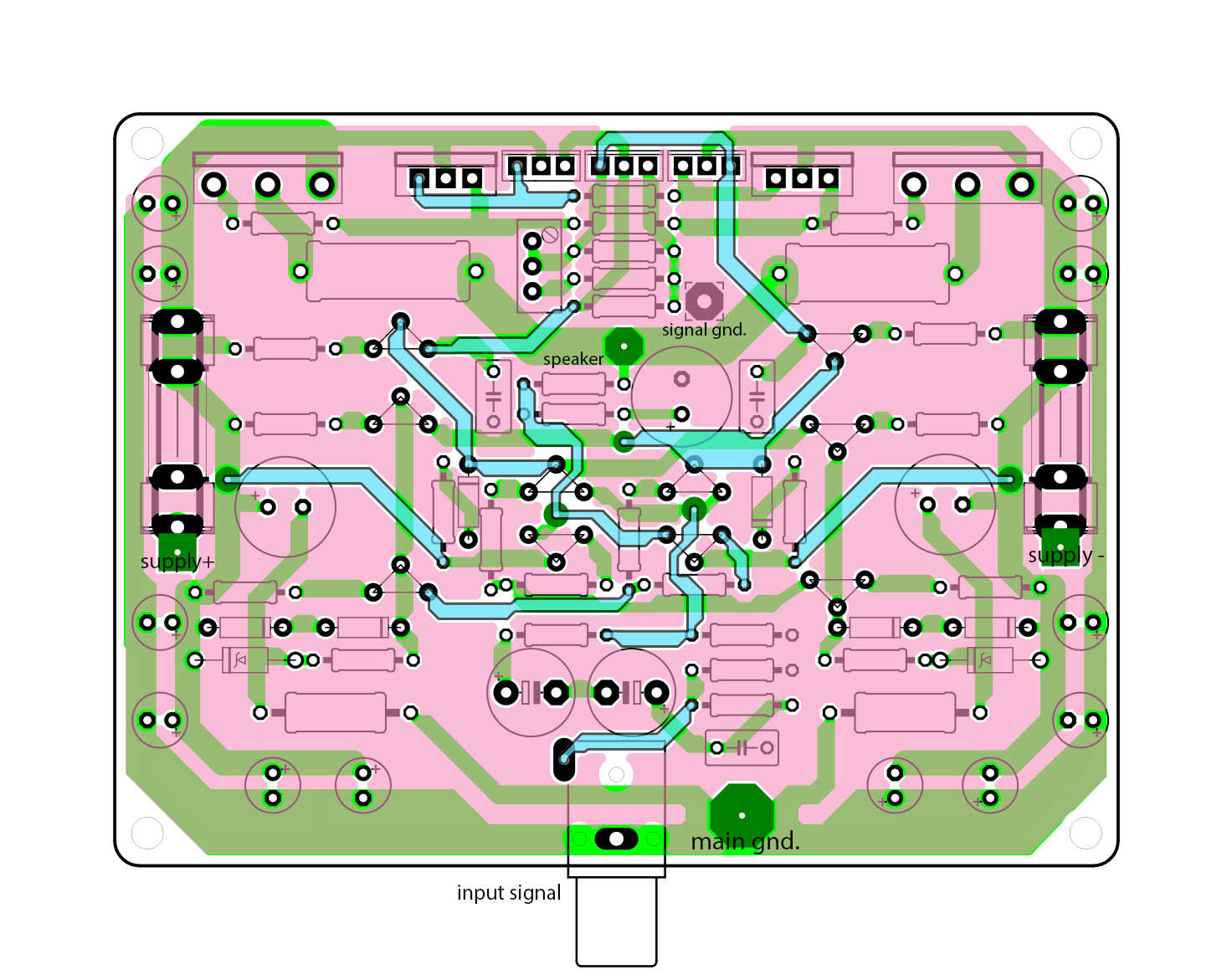

here's my contribution....
size is 4x3 and decided to separate the zobel and coil section.but I do believe that the amp. should have this, as an external protection for the output transistor.
I have read Jay's post about using rca at input.....and also I have read about balance and unbalanced input.how this small volts rides with the input signal.problem is difficulty employing potentiometer for volume and in case the amp. is still on and plug a device a loud signal will be heard at speaker.
the amp has two gnd returns one is for power gnd and the other is for the signal gnd. going to the star gnd. Signal gnd.is at the top of the pcb which is also the plain gnd. and acts as a shield.
using a star gnd. at pcb is very hard since you have to use a good conductor, very low resistance going to star gnd. otherwise will cause gnd. loop.
my biggest challenge is how to do it in an ordinary two sided pcb.
regards,
drowranger
p.s.
those decoupling capacitors are 33uf for filtering high frequency and having an advantage when decoupling capacitor all having the same value.

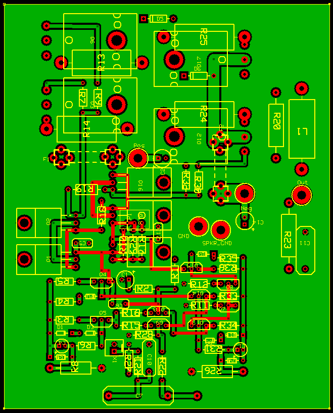

Not a bad idea. That can be one version. I am waiting for a few more people to contribute their ideas and layouts. I am waiting for some of the worlds most creative minds to share their ideas. Has something to do with people different perspective of things, if you can harness that, then you can rule the world. Is the glass half full or half empty ?
Here is an alternative half finished layout that looks sweet, but there are amplifier case mounting and dimensions to address. So ladies and gentlemen share your layout ideas for the next SYMEF PCB ;). Lets drive the state of the art forward.

I would recommend building a full version just like you did the SYMEF. A three layer design like the one you have posted is best implemented at the board house. ;)
Would it be possible for me to entice you with trying out this new layout idea that I am planning to experiment with in the SYMEF.;)
its only two sided..
my gnd. plain is on top and serves also as my signal gnd.power gnd is at the bottom of the pcb.
I have to modify my gnd. plain should not extend to supply section.
my signal and power gnd are not connected so there will be two gnd. returns to star gnd.if this does not work I will try to put a bridge for the two gnd., which is at the top and bottom and there will be one gnd return to star gnd.I hope this will separate the power gnd. and signal gnd. contaminating each other.
Star gnd. should be as close to amp. and maybe use a copper plate as my star gnd. and solder these return wire for good conduction.I have also read about metal enclosure are bad conductors, may be this is the cause when these rca connectors(input connectors) come in contact and produce humming noise..:scratch:
I dont know if my idea make sense:D
regards,
joel
