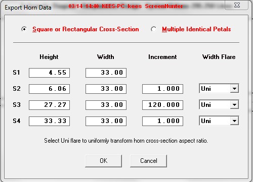

Hi David
For the cross sectional dimensions I do now, when drawn in sketchup I get automatically when folding on the right pad, I do keep the dimensions from export as the sound pad, but I use a speaker and this speaker has 1.4 liter as space it take, but I think that it has not so much impact, Can I make S4 some bigger to implement the volume taken by the driver?
The photo let seen what horpresp do, I fill in the height and hornresp fill in the width and vica versa I do understand this, the same for bracing I put that extra in place where the bracing is, like S3 so making S3 some bigger.
And the folding I get always the right dimensions because I do fold around the 18 mm panels, the rest is easy.
Regards and thanks for the help, I am almost ready for the challence.
kees
forgot the photo, I have change the width to 33 cm to fit the driver, and make S4 some bigger for the extra volume of the driver.
thanks for look at it it is the last for I want to now for shure.

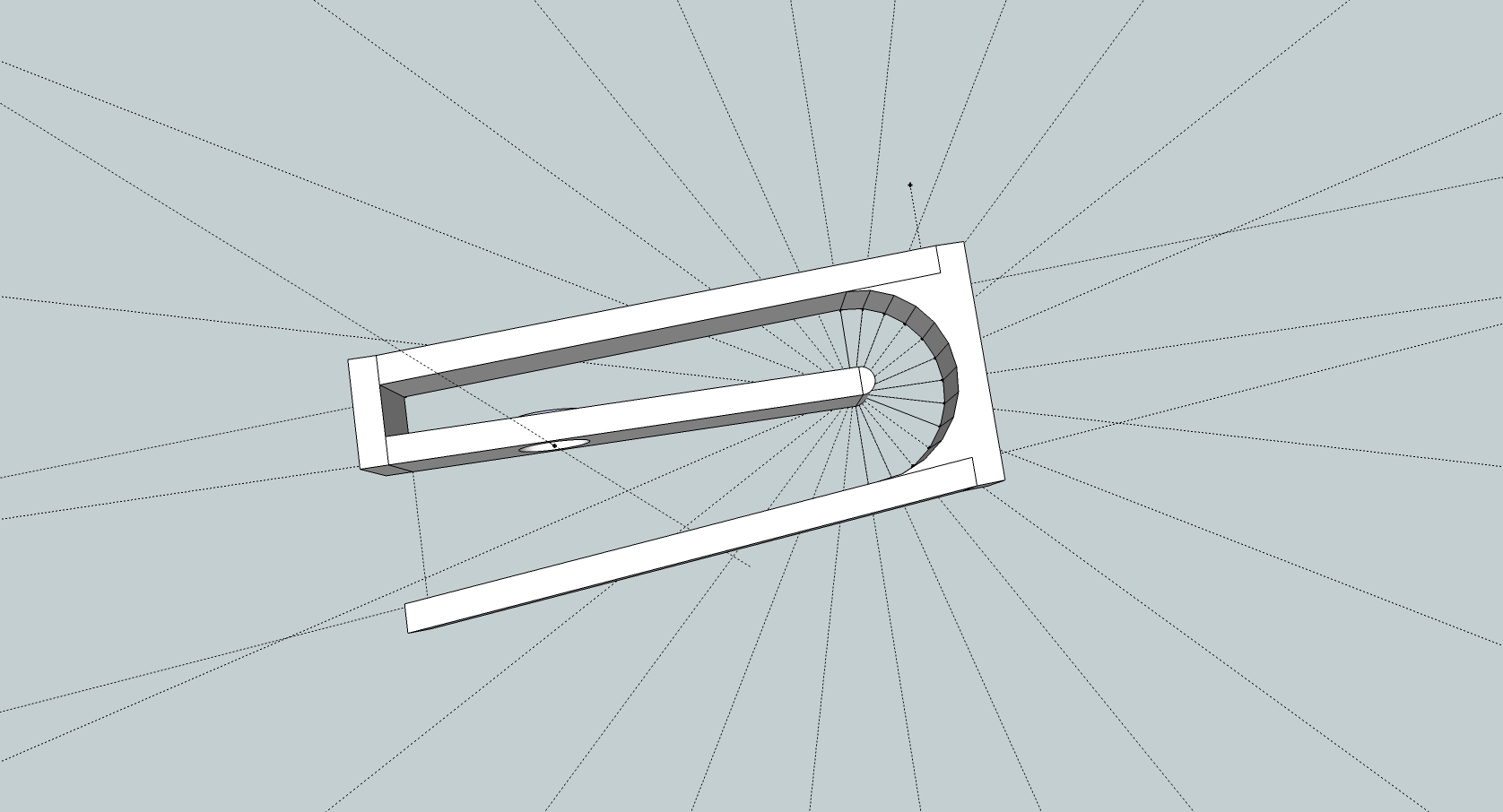

Well I have tryed a fold, my way, to make the output of hornresp increments just as small what sketchup alows, it did not exact 10 mm in the circel.
I did see why sketchup do sometimes very strange, it do not delete always everything en let some pixels left and so problems, I did not see it unless I zoom big.
I have just for the bend start with hornresp output and did 0.9 mm increments until I am on the other side of the bend and then i use bigger increments until the other bend etc.
I like to hear what you think, maybe I am a little busy to do it wrong. First I go learn sketchup or autocad (better).
PS this is not a real design but a part of my hornresp output to look at the bend.

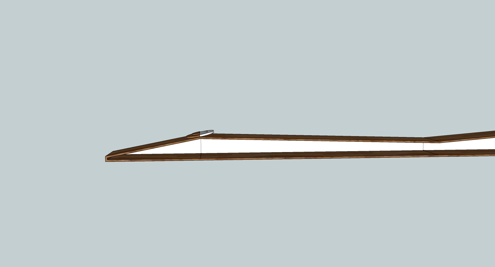

Well after some tryouts I have some new question, sorry about my behavior.
the txt file have I exported from hornresp but I get not precise a good flare, from S3 to S4
it have a bend, and I need not a bend there because of the wood.
What is the best way to get a conical flare from the troat to the mouth, I did put it in parts for sketchup but it dit not match after the S3 to S4 where the speaker is a bend here is afcourse not the way and in hornresp I can not see when I am oke for export the horn to txt. Maybe you have a tip or tips, and have I use the digits after the mm? sketchup do only use mm as highest resolution so far. for the rest, it go better.
  • keestest.txt
the txt file have I exported from hornresp but I get not precise a good flare, from S3 to S4 it have a bend, and I need not a bend there because of the wood.

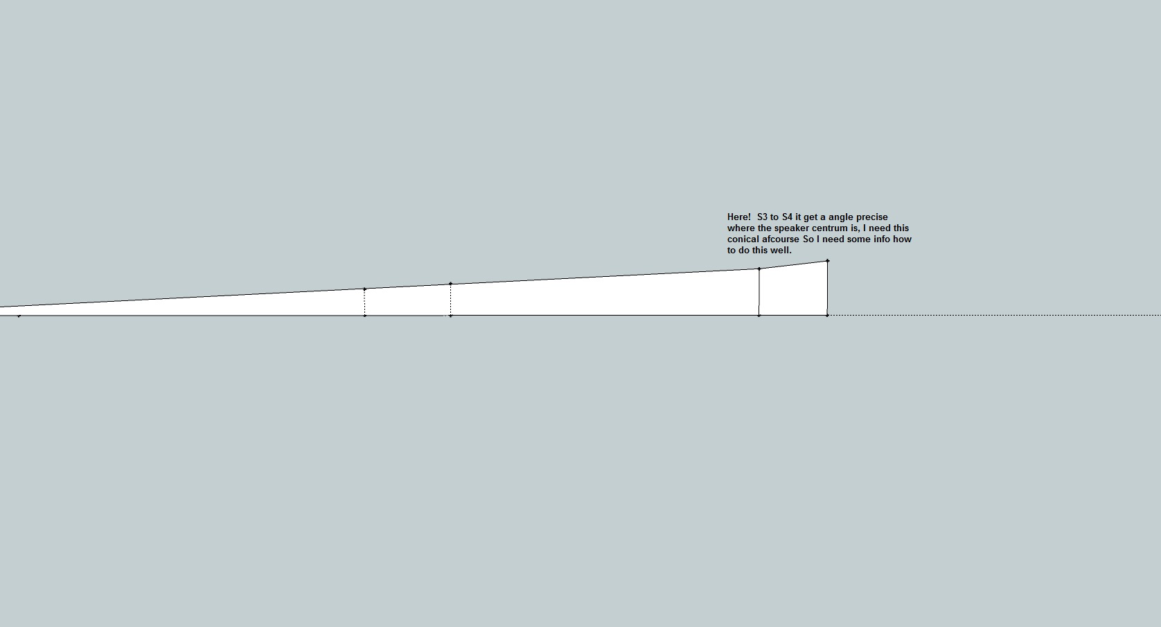

Hi David
When use the output I can make nice bends? see the picture post 3848 as example, not the real one afcourse.
If I do S3 800 and S4 959 then it go like on the picture, I need to get S1 to S4 so that it is pure conical otherwise I have a bend in the middle of the speaker, this is the last part I do need to now, the rest I have it.
I think S1 200 S2 800 S3 800 and S4 so That it do not bend, maybe I need to now a rule here from the experienced here. I see that I can make the mouth smaller or the S3 taller to get it a straight line to the mouth.
Sorry about my green ears.
thanks
kees

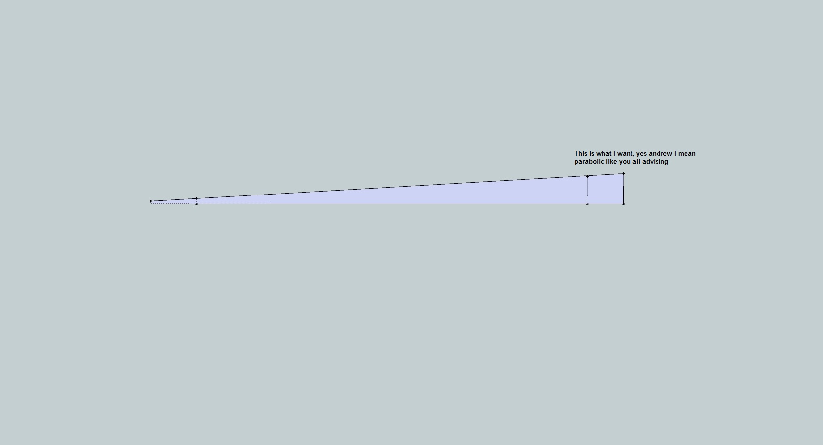

Why does the final section need to be conical?
What's wrong with parabolic for all sections?

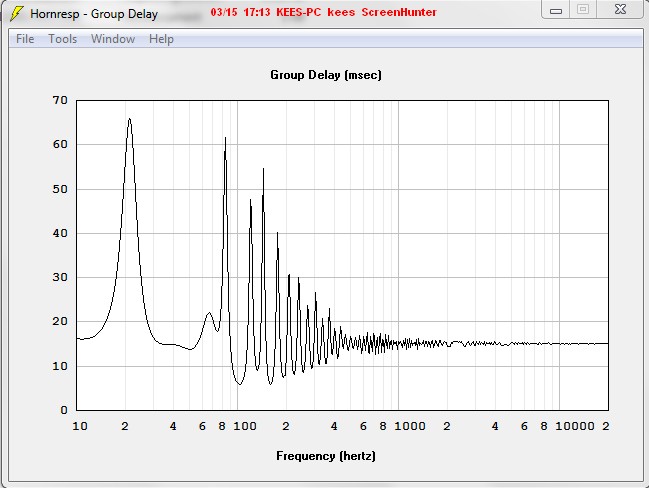

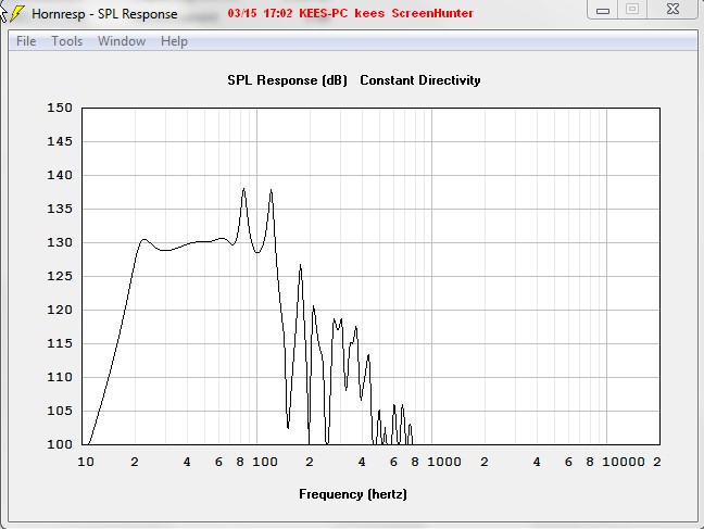

Hi Andrew

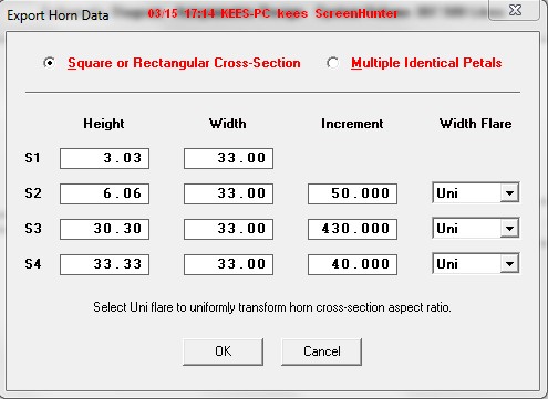

I don,t get how to set it like you all do, one straight line from mouth to throat I did mean all parabolic, I show what I want to see in the picture below.
I have now uses only measurement of S1 S2 S3 S4 like David say, the picture in the post before S3 and S4 did bend, and how it looks now I do need for easy workout the box.
picture horn, and response of the infinity 1260W etc like it is now with straight angle and not as last post this is what I want but what is the best way, that is what I did mean so Andrew there is nothing wrong with parabolic but I need no bend in the middle of the speaker...
What I also not get 100 % is how I do fill in extra volume in hornresp for braces and such, like the driver volume, do I make the S3 and S4 bigger ? for example if bracing is 10 liters in the long part I do make S3 10 liter bigger, this are the last parts, If I now them then I have remove my greenery behindthe ears I hope.
Thanks all for the help, and some input about the design I do like also and maybe some extra info..

Hi David
Yes I do now but how do people implement the braces and the speaker itslefs? when I put that in the hornresp design your cros-sectional area change, the only way I see it when there is a 18 mm brace I have to extra widen the box to get the same area again, or do I see this wrong? I can tread the braces also as a cross sectional area, better I need to do that and fill in that extra space in hornresp, some do 20-30 procent extra to the outcome of hornresp.

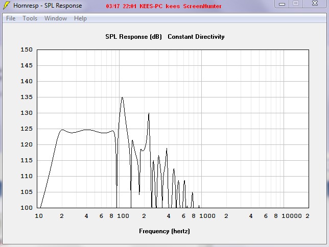

Do you like the graph in the post 3953? I now did only measure s1 s2 s3 s4 and drawn a straight line like you say, I think with a notch or damping I get to 100 Hz bandwith with some loss of efficienty.
I go try to find some more info, the tapped horn treads are sometimes very very big, special if i am there:)

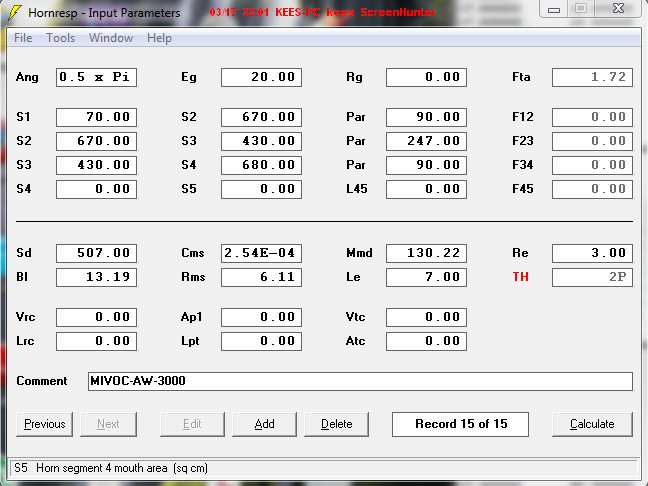

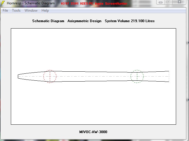

Ahh I did not now everything, One thing resists.
The outcome see pictures, here I have a strange outcome but a very good graph, The question is precisely on the center of S2 or S3 where the speaker is I can not assemble the speaker because there is a angle there, what do you in such case put the speaker on the back of the horn? so it will fitt on that angle, I hope you understand what I mean, my english in technical form is not as good.
This grahp from hornresp is from two speakers, I can put them like it is in TH-Spud tapper horn, but this is nog a real tapped horn, more a combination of a tapped horn and a T-TQWT, the question here is about one speaker, if there is a bend on S3 or S2.
see exort sketchup the circle on S2 this box is just a testing for me, I even have not that mivoc speaker.
Have a nice weekend.
kees
