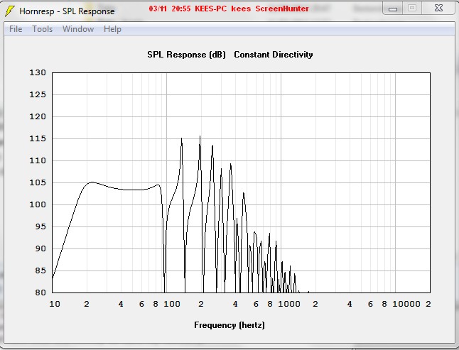

I did some test with the visatons, one speaker.
looks nice but spl per watt is 85 dB, I can go wide, above 100 Hz
without wildness.
The TS parameters of the infinity are oke, I have test it with martin sheet, I do not use this woofer for TQWT because it don,t work there well, it is for tapped horn, in the lab 12 it works with slight changes.
The TQWT do react strongly at corner load or not, (peak at 70 Hz) but that is manageble with damping I think?

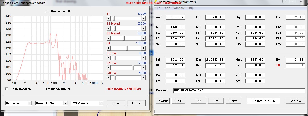

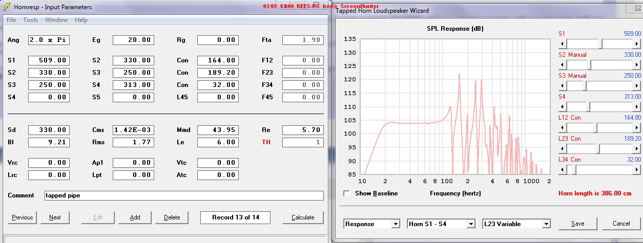

Wel it is a tapped horn thread so, I shere the hornresp data for the infinity W1260 woofer, the graph looks good, in a TQWT this woofer don,t work and a tapped pipe also not good, I have him and so a tapped horn wil it be, I have shorted the horn length to 25 hz and then still I have 118 dB on 20 hz so I can hear an pipe organ lowest octave, nice, the visatons do wel in a tapped pipe or TQWT, so a light cone is good there.
So much boxes, difficult to decide what, it is for home theatre use and music.

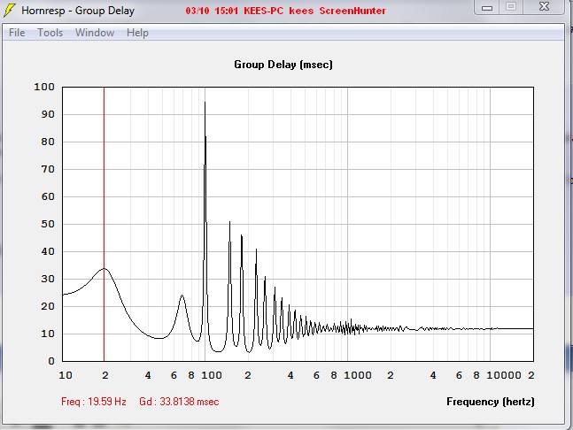

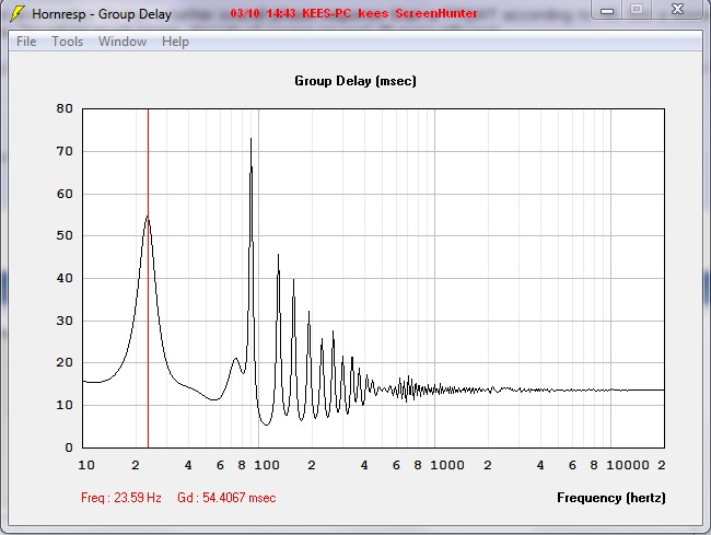

I have seen that the TQWT is in fact a reversed tapped horn and so you gain bandwith at expense of efficienty but for home use it is enough, for PA a tapped horn is better, see I this right, I also go look and read about it, the infinity wil not work in it, I did try, possible to heavy cone weight..
in the pictures I did see a group delay of 80 milliseconds for Tapped Horn and 20 millisecond for the tapped pipe so the tapped horn indeed has a lot more, the most delay was around the cutoff 20-23 Hz I don,t now if it has impact then op sound.

the tapped horn or T_TQWT for correction, the most delay is around 22 hz so not a big issiue.

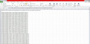

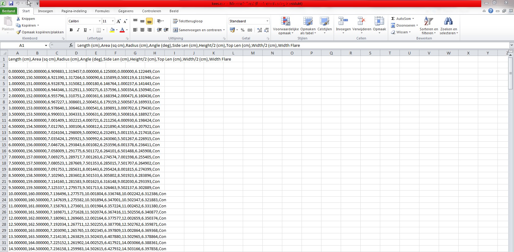

Hi David
I have also try with exel also here a mess see photo
colums on top are longer for example, maybe also here a problem with the fonts?

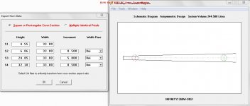

Well I have found it, only for exel not yet, it gives a mess, notepad works now with a other font.

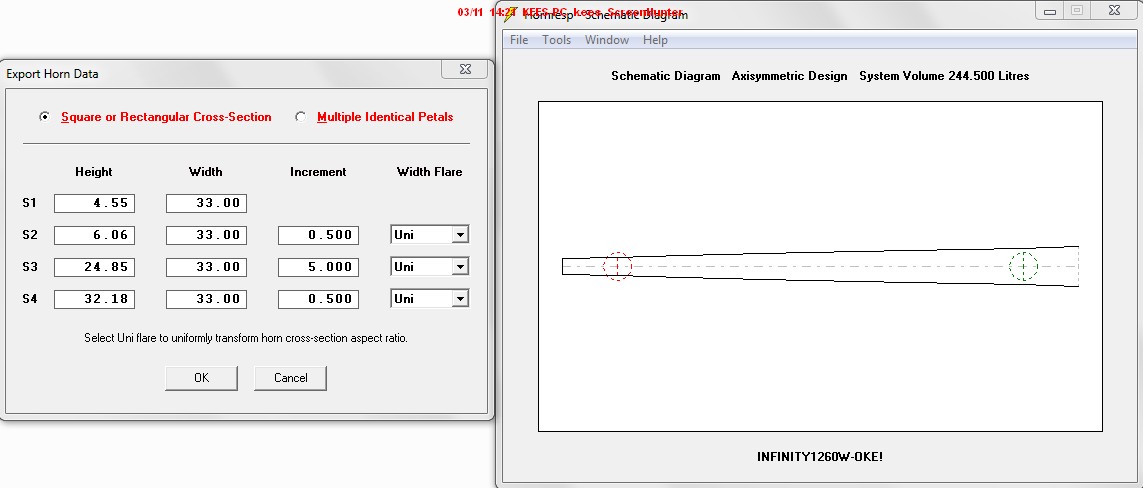

So now to understand the txt file for drawn the box, can you take a look that I was right where S1 start and S4 end, I have put that in the txt file, also the width and heigh, my box is 33 cm wide to fit speaker in also here in foto did I right?
thanks, now I can start with the first one, I have the infinity so I can only go TH, it is not to big with 244 liters and a -3dB 22 Hz.
zip file is akabak script, I can not use akabak in 64 bit windows so maybe here someone can simulate and see what akabak says.
So now I can with the knowledge do something.
thanks.
When you open the infinity w1260.txt with excel it should go through an import process where it is detected as tab delimited. There's nothing wrong with the text file you've attached.

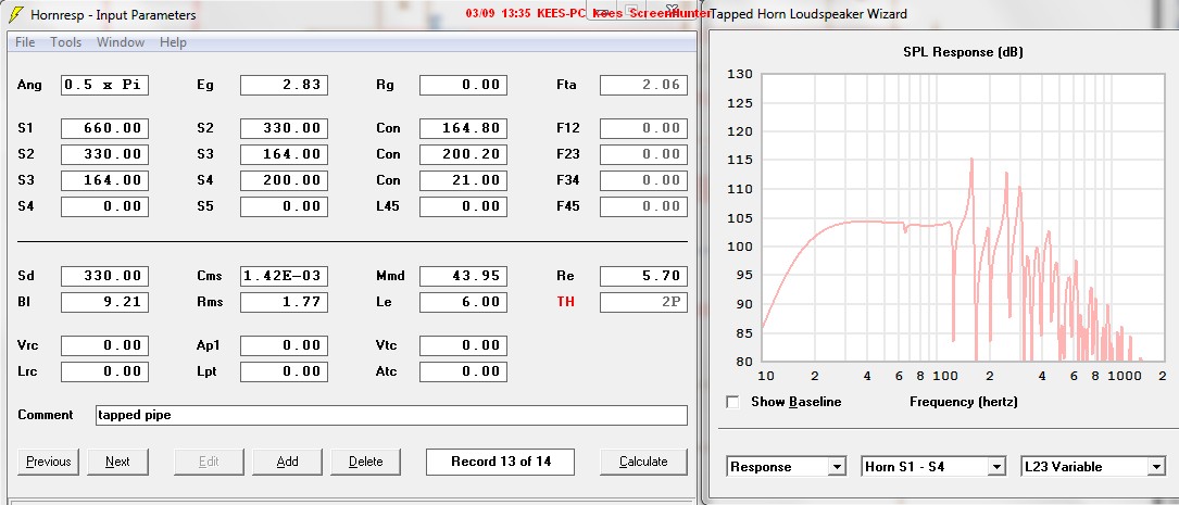

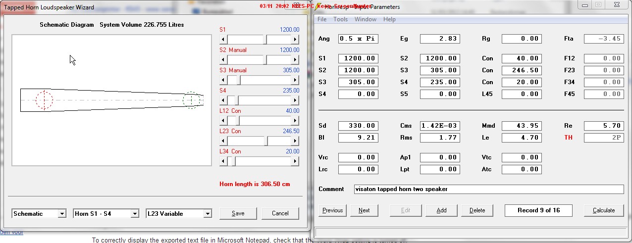

Here I have new ones and also I have play with the visatons in a T-TQWT to look what it does, like for me also interesting outcome, but first afcourse the tapped horn with the infinity to cure my curiosity.
but do give the small mouth in the T-TQWT not a noise problem with two woofers inside of total Sd of 660 cm? this T-TQWT looks more like a TL for me
a tapped pipe also different is tapered or not.
Hi kees52,
It seems that you may be using a non-standard number format. As I understand it, the conventional regional setting for the Netherlands is a comma for the decimal separator, and this is what your Dutch-language version of Excel is expecting to see. However your screenprints show that you are using a period as the decimal separator, which is why the exported Hornresp csv.file is not being interpreted correctly by your Excel program.
If you change your regional number setting to a comma as the decimal separator rather than a period, then a Hornresp-generated csv file should open correctly in your copy of Excel. Close Hornresp before you make the number format change and then re-open it again after the change has been made. Hornresp will automatically detect that the decimal separator is different, and make the necessary alterations to any new exported csv data files.
Alternatively, you could change the number format in Excel so that a period rather than a comma is used as the decimal separator. Search using "decimal separator" as the key words in Excel Help for further information on how to do this.
The advantage of working in Excel rather than Notepad (for example) is that the exported Hornresp data can be more readily manipulated.

And now learning the folding, be the way, do I need expand volume for the material and speaker ? I did hear 20 30 procent more volume, where do I add this, for my it seems make the enclosure wider, nog higher because this effect length of horn pad.
Maybe I did find a bug, when I open hornresp and go to my design en open schematic and go back schematic in tools is grayed out, I have to go first to next and then back to my design and I can again go to tools then schematic once, after again grayed and ticked.

Hi kees,
As far as Hornresp is concerned, the volumes of the drive unit and the enclosure panels are not taken into account. The simulation model is only interested in the air volumes through which the sound energy passes. When folding the design, it is important to maintain the air duct cross-sectional areas and lengths as specified in Hornresp, otherwise the actual constructed speaker will not be the same as the simulated design.
The Hornresp schematic diagram can be generated two different ways - either by selecting the Tools > View Schematic menu command from the main input parameters window, or by clicking the Calculate button (or pressing F5). In both cases the diagram can then be viewed as 2 Schematic Diagram under the Window menu.
If the diagram is initially generated using the Tools > View Schematic menu command, then the command is ticked and disabled to indicate that the diagram is available and can be viewed by selecting the Window > 2 Schematic Diagram menu command. It is not necessary to re-enable and reuse the Tools> View Schematic command to view the diagram.
Kind regards,
David
Kind regards,
David
