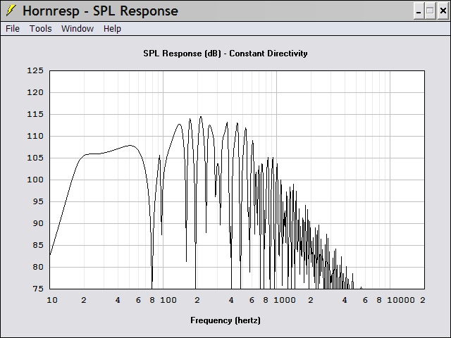

The above was an expensive 18, this is a cheap 15 (and a smaller box):
Don Snyder said:
Is this a Tapped Horn?
I found this on Speakerplans.com and it has been widely built and tested. This nearly finished cabinet needs bracing and a side, and to be turned over.
Yep. This is one of those designs where L12 and L34 are nearly zero. They probably modeled it as a back-loaded horn, even though it's really a tapped horn. L12 and L34 can never go to zero, unless the cone was infinitely small right? For instance, with a 12" woofer they can't go any lower than 15.2cm right?
If you rotate the driver 90 degrees (so that the drivers cone fires straight down the horn path, L12 would be zero.
As far as S23 goes, I asume that when, with a single folded design like the transflex, if you end the horn at the axial position in front of the driver, S23 would be non-existant as well.
Regards Johan

1/2 pi loading is absurdly optimistic. These simulations would make a lot more sense if people would stop using it. It gives the readers of this forum the incorrect expectation that they're going to hit 120db with 100 watts. Do you know how much gain is added when you model in 1/2 pi instead of free air or half space?
Yes, of course...
As I said it drops ~5dB in quarter space; (actually 5.5dB).
In half space it drops 11dB.
I can't imagine using them in free space, so why model them that way.
As I said, I'm using them in corners, with concrete walls and floors...
So if everything goes wrong, and it acts like it's only half space, and only 99.5 dB @ one watt; ten watts is still 109.5 dB, more than I need...
I still say the Eminence Definimax 4012HO is a great driver for a TH, IF one is looking for good quality sound.
(not just looking permanant hearing damage-- I have no interest in "how loud can I make it)."

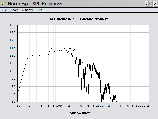

Hi Patrick, why do you think it is optimistic? Is this opinion based on measurements and if so, how were they done?
If the walls are made of concrete and the room doesnt have alot of leaks like doors and windows (which would be neccessary for it to behave like the model), i cant imagine why the predictions made by hornresp should be wrong. Hornresp does a great job at modelling horns, so i think it is strange to assume that exactly one aspect of its simulations would be way off. Actually, room response for corner placement should be even better than 0,5PI simulations because you have a ceiling and the room gain below the lowest room mode, which both is not simulated in hornresp.
The modeling programs assume the walls of the horn and walls of the room are made of something real dense, like depleted uranium.
In real life we don't 'quite' get that level of performance.

Interesting information, djk, but i have some concerns, which conflict with it.
Placing several horns close together is the same as having one big horn with one big driver. Following this, the picture implies that a big horn has relatively more losses than a small one. Since this is not the case, or else simulations of speakers would be totally unusable, i think something is wrong with this picture, either within the measurement itself, the measured loudspeakers or its application as an argument here.
Assuming this picture IS right, i dont see its validity concerning a room with concrete walls, which are quite solid in comparison to air and dont vibrate alot more than the lovely non vibration kryptonite :) (which is also valid for a well braced box i assume).
After all, i just theorise here, having no clues whatsoever to support my position. So take this all with a grain of salt.
