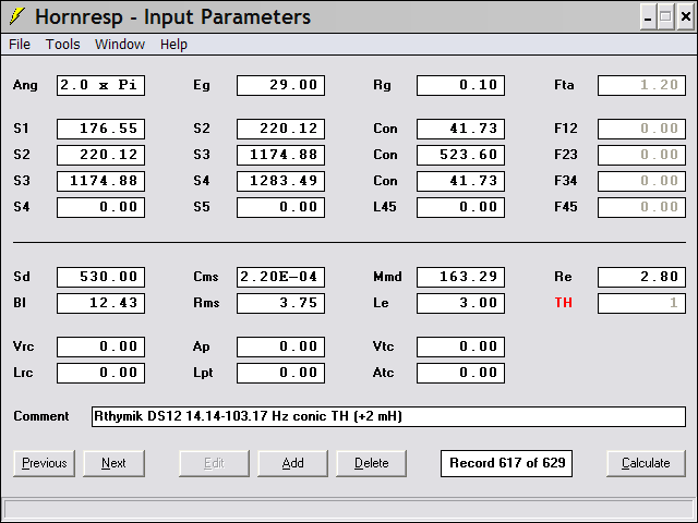

Has anyone considered some of the Rythmik drivers for TH use? I'm presently planning to build a couple of smaller THs for PA use. The major issue with THs that I've encountered in Hornresp is related to diaphram displacement. Given the large displacement peaks above the horn cutoff, most drivers hit xmax way before they run into their power limits. In trying to squeeze out the most performance, I came across the following driver from Rythmik:
http://www.rythmikaudio.com/DS12driver.html
This driver has an xmax of roughly 35mm, (if I am reading their specs correctly). The BL is a bit on the low side, but overall, not bad for around 130 dB from a single 12" driver (roughly 350W).
This driver also has a servo sensing coil and Rythmik sells one custom servo controller amps. I wonder if that might be of use in helping to control displacement or for taming out some of those anomalies at the top of the TH's bandpass.
craigwalsh said:Has anyone considered some of the Rythmik drivers for TH use?
This driver has an xmax of roughly 35mm........
Not me..........
Its specs doesn't seem all that conducive to a small PA app.
Xmax is a one way spec, so ~17.78 mm.
FWIW, the BL is too low for the rest of its specs, so none to be trusted IMO, which they shouldn't be for a horn design anyway.

Thanks for clarifying Xmax. Hornresp's help file states that it displays the one-way maximum (1/2 wave) displacement. I get it now.
Rythmik lists a couple of other 12" drivers with higher BL. It would seem those might be useful for TH, no?
So, some issues come to mine. In the effort to identify high output for say around 30 Hz low cut, it seems as though the limiting factor is Xmax. Is this correct? If so, what 12" driver has the highest Xmax that would be useful for a TH alignment? Second, how do TH alignments deal with bass transients (like kick drum) compared to standard bass horns or vented enclosures? In other words, does the TH require that the signal fed to them have roughly symetric 1/2 waves for each cycle? Finally, I don't see why servo sensing couldn't be used to counteract the displacement peaks that limit the BW of the TH.

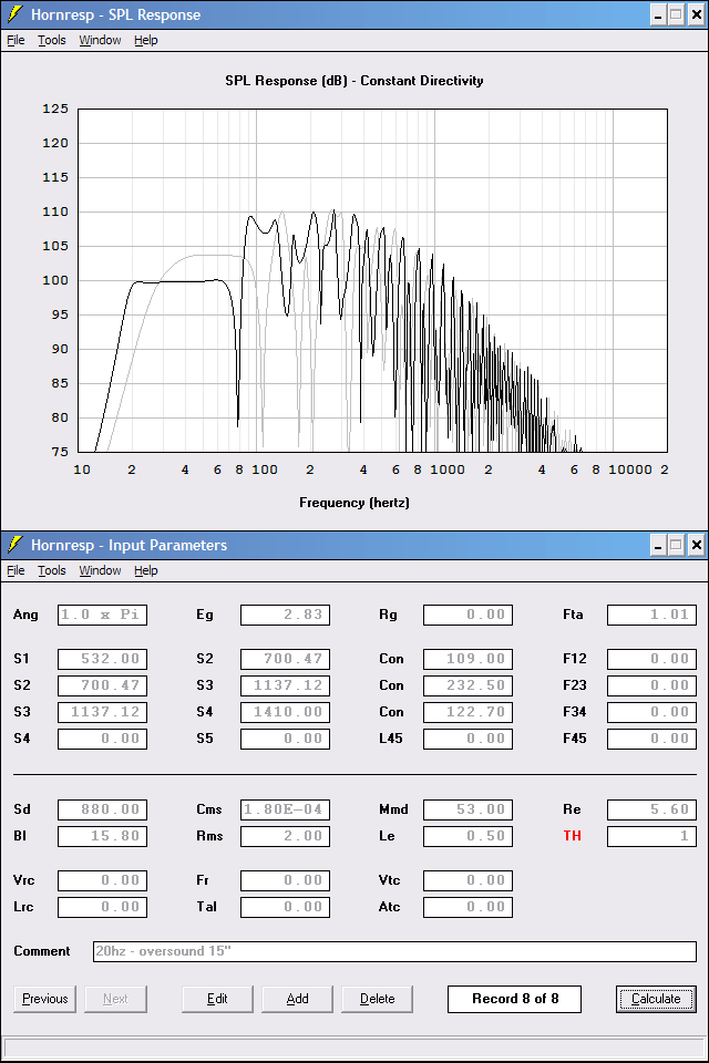

I've recenty aquired an Oversound MB 15-450 which seems to have pretty similar specs to the Eminence 4012 but it's 15":
http://www.oversound.com.br/index.php?pag=../loja/loja_produto&cat=123&pro=3348
Now, it appears that the specs are incomplete, it's missing things like BL, Cms and Rms. Is there a way of calculating these from the other values or am I going to have to use one of these "woofer tester" systems?
Thanks very much. I put Le in as 0.5mH just for testing, you don't know this value also do you?Sabbelbacke said:Here you go:
Anyway, doesn't seem like a bad driver, hopefully it should cope with horn loading ok as it's intended for PA use. It does do 20Hz pretty well but the box ending up a little large at 15 cubic feet. The grey graph is a horn around half the size, but much less 20Hz output, this would be more suited to music than HT.

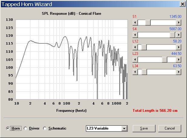

Well it was pretty late when I was running those sims. I took a closer look this afternoon and it looks like what is happening is that by moving the driver further from the throat (relative to its distance from the mouth) we are smoothing out the penultimate bump and evening the response in that first 8va at the expense of the next octave up thus restricting us to only about one 8va range.
Not worth it I think unless a specific application warrants. Pics show what I mean.
The "normal" results where I tried to get the best combination of extension, smoothness and bandwidth while having the mouth far enough away from the driver to allow either choice of exit axis. Careful choice of crossover should give more than 2 octaves with bumps only about 2dB or so.
And just for giggles I thought I would try putting the driver right at the throat (i.e. firing right into the end of the horn like a normal horn) but with the rear of the driver firing into the mouth ala tapped horn. Interesting. If you can handle a fair amount of ripple there is quite a bit of bandwidth there.
MikeHunt79 said:...........it's missing things like BL, Cms and Rms. Is there a way of calculating these from the other values.........
Yes, Hornresp will calculate them by inputting Sd, Vas, Re, Qes, Qms in the appropriate fields.

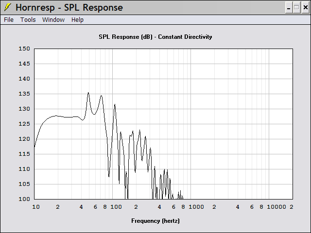

Recently I built a bandpass sub, and much to my surprise, it seemed louder than my tapped horn. Even though the tapped horn was bigger, and used the same driver.
This was quite a shock, so I researched things, and I think I've solved the mystery.
The problem is that almost everyone is modeling their tapped horns in eigth space, and that's just ridiculously optimistic. In addition, the excursion simulations from horn response seem a bit suspect I'm afraid
While the jury is out on which program accurately models excursion, I am confident that anyone who compares a tapped horn modeled in eighth space to a vented box simulation from any other program, is going to get bogus results.
Here's how I came to this conclusion:
http://www.diyaudio.com/forums/showthread.php?postid=1597059#post1597059

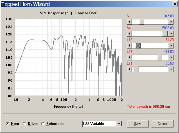

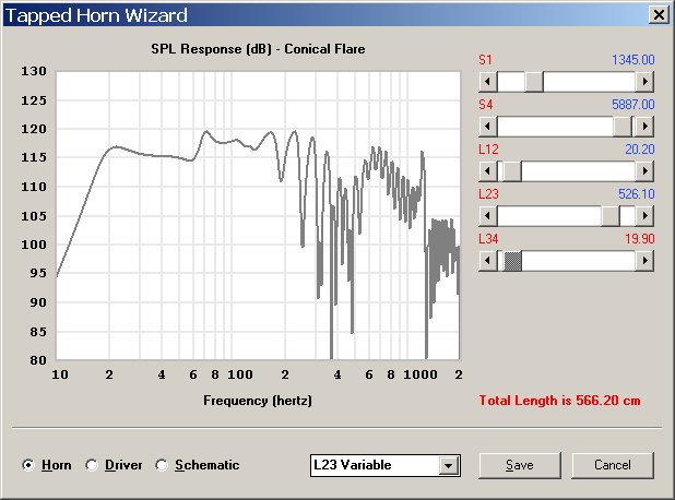

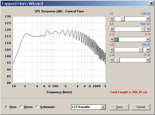

Mashaffer,
I've recently figured out how to sim the TH's in Hornresp. ( Thanks to David McBean, and all the others contributing here!)
I would like to suggest that whatever driver you are working with you try this as a baseline ( it's been working for me, and I stumbled across it.):
Start with S1 at about 1/2 of Sd, input any conical expansion you please, end up with S4 at about 2X Sd.
Start with the throat L1 at about 1/2 of the Dia. of the driver ( the driver truly at the side of the throat ) L2 to whatever length required to tune low as you desire, and L3 30-60Cm from the mouth.
bring up the tapped horn wizard and "Play" the sliders to smooth out the response you desire.
One Caveat: make sure to check the excursion graph, I've found when simulating a 20 Hz Horn with small drivers that the excursion tends to exceed X-max below the horn tuning, so a subsonic filter may be required to protect your driver.
I have been amazed at the variety of drivers I have been able to sim, with very good looking results.....now if it will cool of enough to get out in the shop and make some sawdust....
