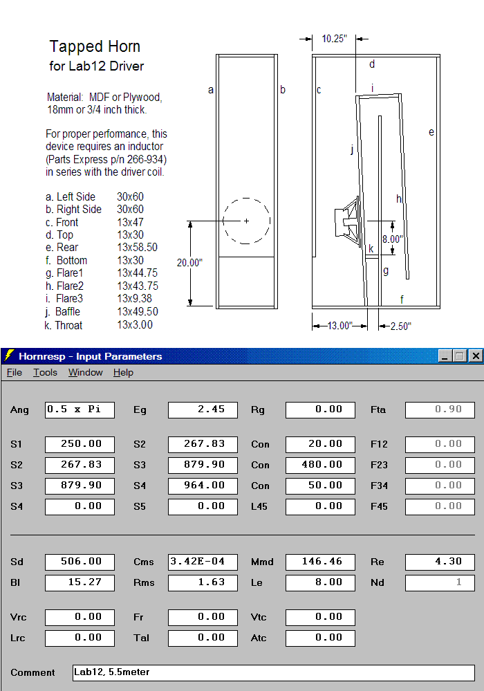

Hello guys,
FWIW, sumsound's DT-20 clone is over 500 L, MaVo's sim is 348 L, and mine (attached) is 321 L. Hornresp says that mine will XMAX out with a 25 Hz sine wave at 90 Watts, but it still sounds great at 150 Watts. It should handle 300 Watts of music.
The Driver can be installed thru the mouth. It isn't easy, you gotta do it by feel, but it's not as hard as reaching the oil filter on my truck. It just requires a piece of 3/16 dowel to center the speaker over the T-Nuts, and it helps to use 1/4-20 socket head cap screws and a hex screw driver. That way, the tool doesn't slip and punch a hole in your driver's cone.
Here is a cleaned-up version of the earlier posting, with some dimensions rounded to the nearest 1/8 inch, and the throat piece and required inductor defined.
Hello guys,

Newbie - check my understanding
I just got around to playing with the TH features of horn resp. It took me a while to get the idea but I think I am getting there. The way I approached it was to set up three conical segments of equal length and taper providing the total length and mouth area that I wanted.
I then started the TH wizard and adjusted driver positions for the smoothest and broadest response. The best results were generally with the driver located rather close to the ends of the horn. Mouth size was not as critical as I would have believed.
Does that sound like typical results? It also appears that the low frequency cut off is almost entirely determined by line length, correct?
Also if I am understanding correctly the driver positions simply represent the distance of the tap from each end. How you fold it to achieve that is really of little consequence right?
It appears that HR is modeling with the opening on the end (i.e. axis of the the mouth opening is basically perpendicular to the driver's axis). However a lot (most?) designs I have seen have the end closed off and the mouth axis essentially parallel to the driver axis (looks like a big port). How does one determine the length/distange from the mouth for the latter approach? Is the end of the mouth half way across the opening?
Sorry if I am not clear, it is a little hard to describe.

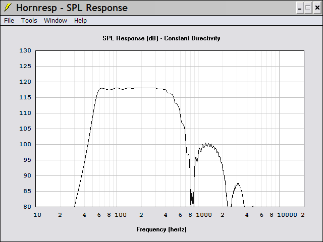

Chris8sirhC said:I thought it could handle 141 watts at 20 hz?
Sims are sims. Once you have the physical horn, you can test and find out how good it really is. Hornresp sims 90 Watts at 25 Hz, but Tapped Horns typically measure 60% to 70% higher than Hornresp shows. That's 144 Watts at 25 Hz. I would bet money that your speaker will take 300 Watts at 20 Hz and above 35 Hz.
