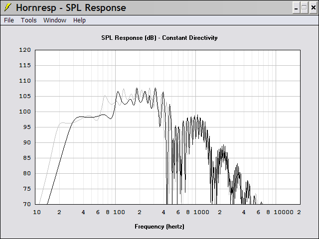

'Default' ~21 Hz conic/~392.6 L net, 1 W, half space (shaded response = ~14 Hz conic/~873.3 L net):
GM
zlast said:Anyone used or modeled this driver in a tapped horn?
GM

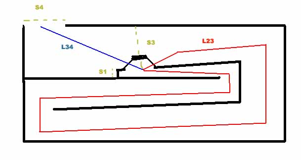

Building a TH with a long L34?
I'm trying to realize a build plan from my HR data and I'm having trouble with a long L34 (80 cm).
Any reason this layout won't work? It's the only way I can see to achieve a long L34 with out making the horn too deep.
The diagram isn't to scale, it's just a rough sketch to illustrate mounting the driver about 1/2 way along the last section of tapper. Most of the designs I see here have the driver in mouth. Having S4 only slightly larger than S3 does not seem to have much effect on the FR.

That should work fine. I just completed construction of my second TH as a check of my understanding of how these work. Though I used a simpler fold, my design has a long L34 like you have in your drawing, as well as a slow expansion rate. My initial evaluation is that it seems to work as I hoped (and as Hornresp predicts).
I've not measured impedance or frequency response yet, but some purely subjective listening and A/B comparisons with my other TH indicate that the performance is similar to what I modeled. I am hearing bass notes that my other TH did not reproduce (and would not be expected to).
Anyhow - short answer - yes - it will work fine.
If you model things realistically and build what you model accurately, what you build should behave as your model predicts. If reality does not agree with your model, check your assumptions first, check your measurements second.

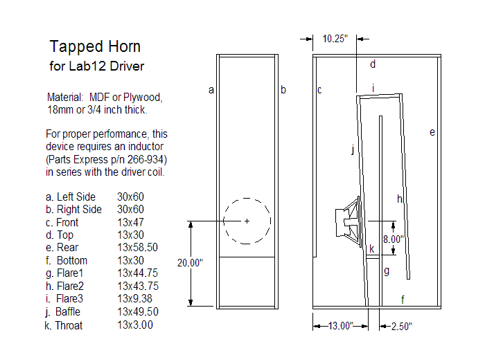

I designed the fold for a Lab12 driven TH for Chris. L34 simmed best at 60 cm, but 50 cm was almost as good, and allowed reaching the driver thru the mouth (no access panels).
What you have sketched should work fine!
steve71 said:I'm trying to realize a build plan from my HR data and I'm having trouble with a long L34 (80 cm).
