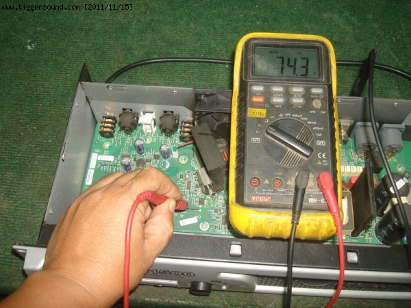

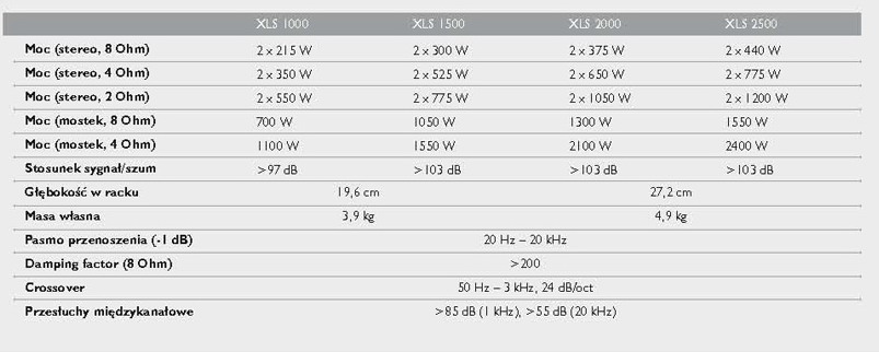

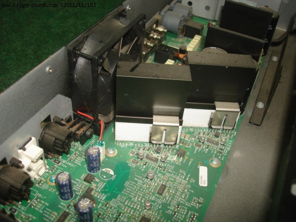

i attached three photos about Crown XLS1500
the rail voltage of this amp is about +/- 75v same as D200 , also this amp use a pair of TO-220 in output stage , but crown claim that this amp can handle 300w @ 8 Ohm / 525w @ 4 Ohm / 775w @ 2Ohm
how it's possible ?
Regards ,
IRSound

Crown XLS1500 use regulated SMPS in PSU, with SMPS D200 have same power as Crown.
Regards
