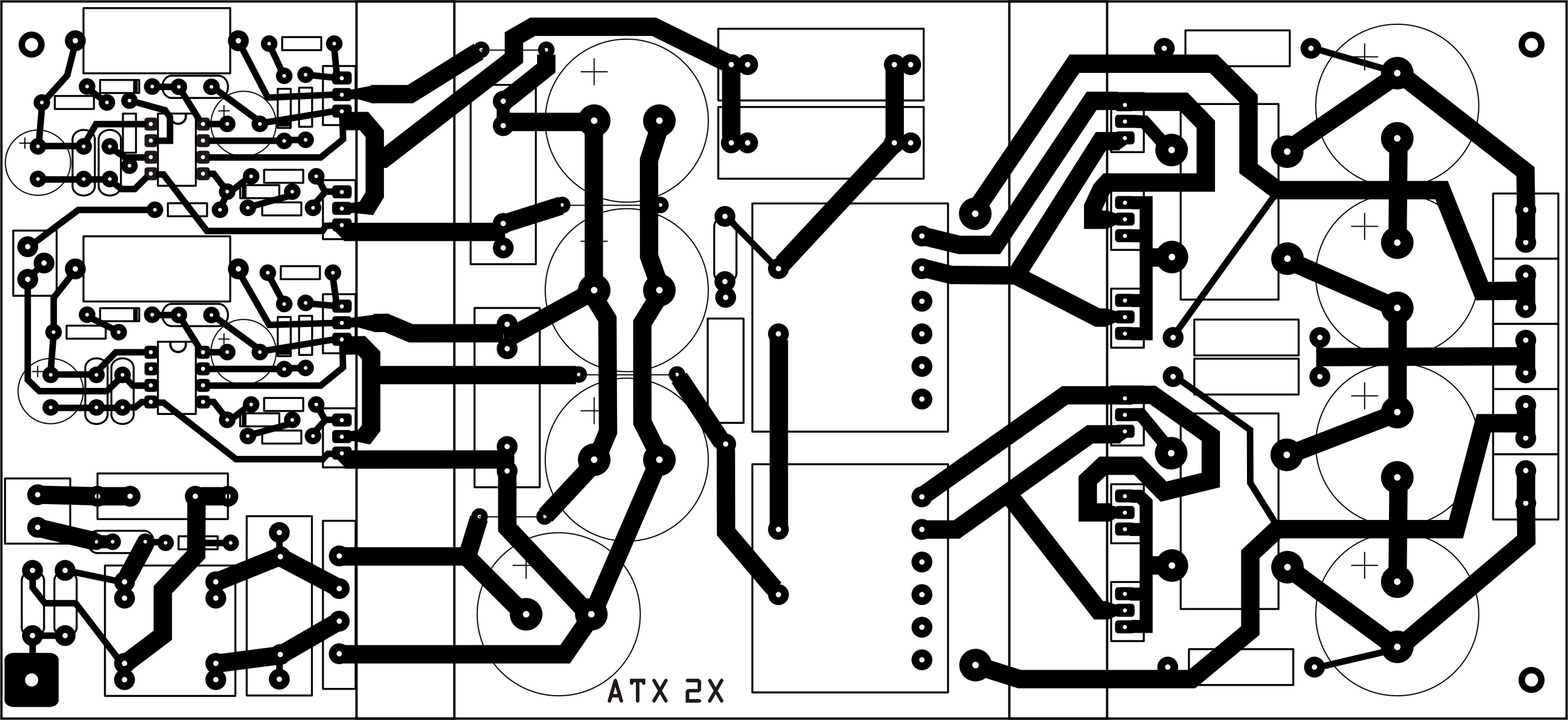

Mile ,
why you aren't use electrolyte capacitor behind the mosfets ? (to avoid PS pumping)
and do you know any commercial pro amps which use this type of circuit ?
sorry mile for repeating this , can you give us schematic ?

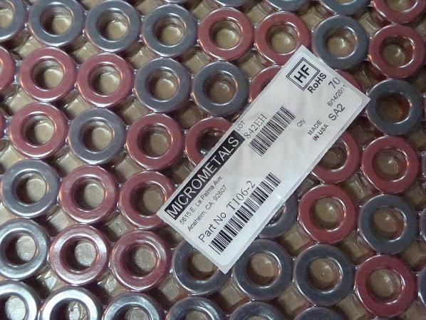

Hadighorbani,
i think your toroid cores aren't original , because their color is bright red and have some differences in packaging (take a look at attached images)..you should test your amp with 500~1000w power supply and use dummy loads. then , you can test your core with higher output power. with asymmetrical 25v supply you cant achieve high power.

In post #92 you can see similar schematic from Mackie active speaker SRM450V2, and all diy frendly amps in this forum IRS900, 1500, 2000, 3000 and AUD600 use topology from IRADAMP 1 http://www.irf.com/technical-info/refdesigns/iraudamp1.pdf

Hi IRsound
i dont have power full smps
this core not heat when i use that
when i take picture it was night and i change the camera color seeting to have good quality picture.
i burn to sub woofer 305C pioneer with sir manoj amp and this core in one time.

Core must be micrometals T106-2 with 62 turns 1mm wire and IRFB31N20D can be use instead IRFB4227, IRFPs can't be use, only IRF640 for test with +/-50V max.

I had look on web, all cores are micrometal, and T106:
1.Product Colour Code: Grey / Clear core: T106-3 Micrometals Iron Powder Toroid
2.Product Colour Code: Green/Yellow core: T106-40 Micrometals Iron Powder Toroid
3.Yellow core: toroidal inductor iron powder core T106-26
4.Product Colour Code: Green/Blue core:T106-52 Micrometals Iron Powder Toroid

building a high power smps isn't as easy as making diy amplifiers. it's highly dangerous and lethal damages may be happen to you.
about color , yes , but as i mentioned between original and fake one is some differences in color (Glossy Red/Clear--Bright Red/Gray).
look at this :
Irvynejay Quote
burning a woofer sometimes happen due to pushing clipping power into speaker. it's not a normal burning because your amp's power were below 50w !
I suggest you to using at least a dc protect.
about core weight , i've just checked micromtals software and i found 0.047Lbs which is about 21.31 grams.
Hi mile,
don't need 50uH for @450KHz cut off freq. will be low as <20KHz.
need 33uH/25uH for 450KHz. for 33uH @50Turns 0.8mm wire.

my core is the color full core not clear core
the clear core was be in here but when we use that it was heet up and can not touch that after only 3 minets
my sub woofer work and bourn
not for the cliping
it was power
i find a transformer with power ampers and sir manoj amp will bourd it beacuse it was power full than other amp i have
