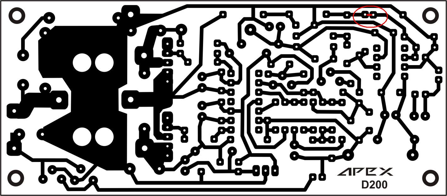

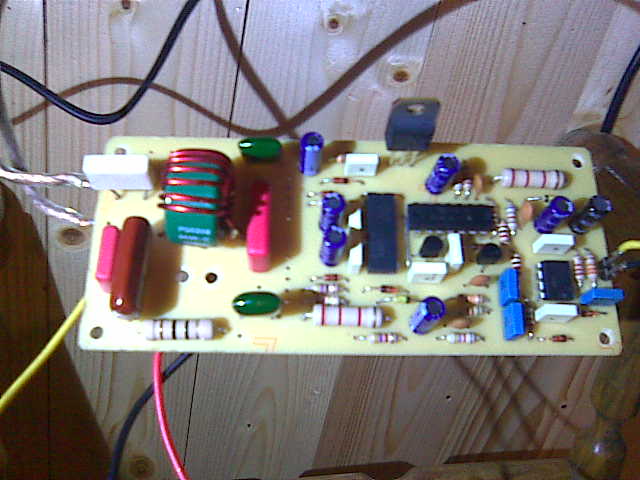

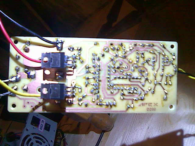

why D200 is not good in low FREQ ?
my sub woofer say gher gher gher in midel and hi volume
Measure voltage on zeners, and check on your pcb if red track missing. You have to high level of HF after inductor, but can't be check without scope.
Regards
HI sir mile
zener voltage was 11.49 v
the red section was connected in my board.
it must be connect or not ?
i was use 1k 1% for OSC resistor
i thing it was be 250KHZ
ok?
i use T106-2 with 47 turn 0.8 mm wire for filter
It's ok must be connected, what s voltage on 5,6V zeners and offset voltage on amp out?
Remove O/C protect for test, short circuit 0,15R/5W.
