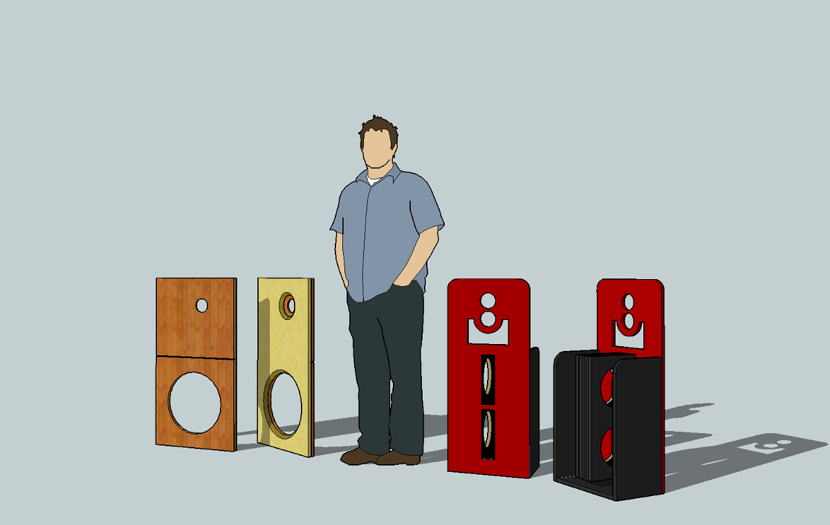

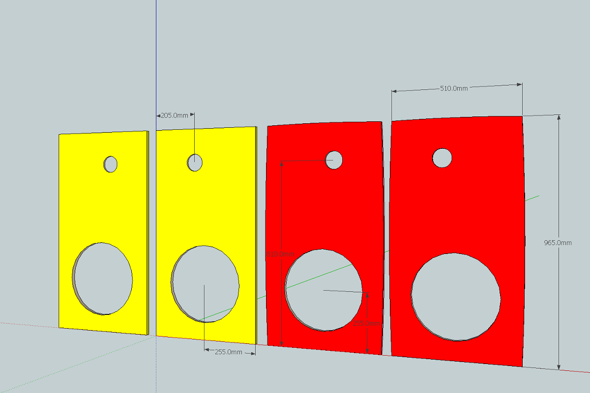

I really like the idea of the slot loaded OB also, but for a first try a simple single layer baffle will be the quickest thing to do. Baffle will be 20" x 38", the Eminence centre should be 10" up from the bottom, the Vifa centred at 32" and offset 2" from the centre line.
For fun, penned two different OB designs in ShetchUp. Simple OB is twin layered, with CLD between MDF rear and wood front. Slot loaded OB is for 4 x 8" woofers and duel Vifa/Faital Pro drivers.

You will be in DSP bi-amp OB heaven with all those drivers to play with :D. Your quad 8 in driver slot loaded setup with tweeter cutouts look great. Did you know Z posted his SW files on his thread so anyone can send them to a CNC mill and get identical speakers made without generating sawdust at home? I am really curious about the Faital Pro - they appear to be like the Vifa but with 91 dB to boot. Keep us posted - I am also curious if you find out if you can hear a difference when using regular IIR EQ and XO (as I have in my 2x4 miniDSP) vs the FIR version that you can get in your miniSHARC?

Basic OB in yellow & red [with bulbous edges]... have the idea of getting some big posters and gluing them to the baffle fronts... bringing some art & colour into the room :)

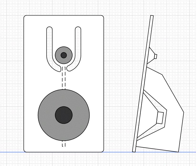

Anyway, this simple/honest build will sound fantastic, but you can improve the design with cutouts using just a jigsaw and this would give you much better directivity vs frequency; center the FR. Something like this:
Cutouts not to scale
This would not be possible without eq. but with the mini Sharc setup you'll have plenty of capability to work this out. (Damn, I want to go downstairs and cut some holes in MDF scraps I have- LOL.)

Neat idea. So you are saying that a simple 1.5 in wide U shaped cutout around the lower portion of the full range but leave the rest of the baffle wide? Does the extended baffle beyond the U help to lower the full range driver's OB low freq cutoff so that it can integrate with the woofer at a lower freq like 300 Hz or so? This is certainly easy enough for me to take an xacto to my cardboard slot loaded OB to see how it works. With the U cutout, is there still any point in off setting the full range driver so that no two edges have the same distance to avoid diffraction?

The idea is more that the narrow baffle around the small driver (about 2x the diameter wide, total) will keep it working like a dipole up until the driver starts to beam. Otherwise you'll get dipole bass with wide "bloom" at some point after you cross to the FR, probably between 800-2k (guess) because the baffles too wide. The extended baffle beyond the u does help a little but that's not the main point, the cutout will cause you to loose more low end from the FR but you just eq it flat. That's why most of the dipoles are 4-way, the eq can only work so far before you run out of power. I would be a little nervous doing cutouts in cardboard, might be too floppy. Could you glue a vertical rib that connects above and below the FR and crosses the gap? Love that you can try this so quick!
