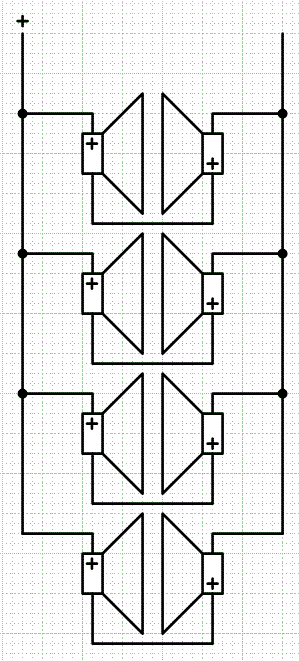

Hi there Z and X: Could you explain the force cancelation aspect of this OB system and how are the drivers wired (with drivers positioned facing magnet#1 to cone #2)? Are the drivers bolted to each other with spacers or does the slot chamber structure transmit the frame forces between the drivers? It seems curious that pressure in the slot does not cause vibration in the slot structure. ...regards, Michael

The drivers are wired so that they move in opposite directions to produce dipole bass. The cones either squeeze or suck the volume behind the slot. Because the motion is diametrically opposed, the net reaction force (Newton's law) is zero for identical masses moving in opposite directions. The drivers are mounted with magnet inside cavity on one side and outside on the other is to cancel hysteresis induced harmonic distortion. There is still pressure on the slot and that can make baffle move due jet forces.
Wiring the slot woofers
The pressure in the slot must indeed cause vibration, but that's low compared to the inertial energy from the cone movement, which is cancelled. Because the slots are a laminated structure of solid MDF (but not in the cardboard implementation) it's like a monolithic block with very thick walls and I can't feel this vibrating at all. I just posted some more on the baffle/slot construction here: http://www.diyaudio.com/forums/multi-way/252593-novel-open-baffle-construction-techniques-2.html
I am not certain about the exact series/parallel wiring scheme I used, but it did end up with 4 Ohms for sure. I think it's wired like this:
