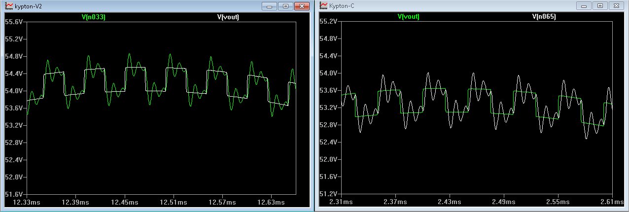

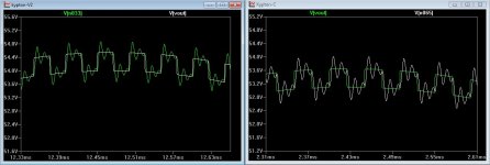

Hi dadod When I look at the graph, the squares seem to have peak-to-peak value of about 5V instead of .2? Also, is that without input filter?
Input was set to+-100mV square times the gain and you get +-3V. Maybe this is to much to ask from the amp?? That was with input filter.

Ah okay, I was just wondering, as Keantoken was speaking of +-100mV at the output and not the input. I don't think you're asking too much from the amp, the graph looks very peachy .Input was set to+-100mV square times the gain and you get +-3V. Maybe this is to much to ask from the amp?? That was with input filter.

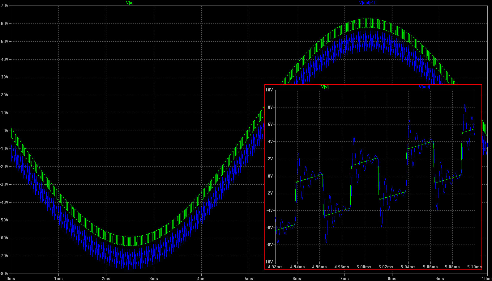

Simming that 100Hz/20KHz wave indeed takes VERY long but I did it, using a pure 2u load (no parallel R). Warning, it's a big picture. The blue graph is the output after the inductor, the green before the inductor. I deliberately offset the blue graph by 10 volts to separate the waves. I also added a close-up of part of the wave where I did not offset the waves to keep them overlapping.
I think that 100Hz sin and 20kHz square is to extreme, it takes to long to run simulation.
Here is 2kHz sin at almost full power and 20kHz square +-100mV from my lateral MOSFET 200W amp.

That's a real cool torture test ... some amps don't do as well as others.
Transient analysis took 5 sec (instant is normal)
"fast ones" (amps) seem to like it.
