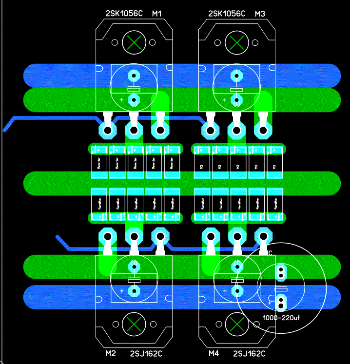

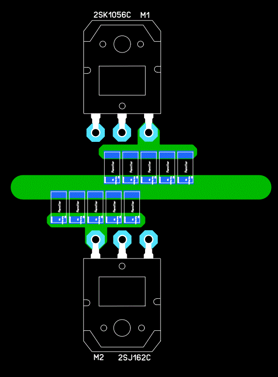

Hi Bob, thanks for your insight on this, it makes me feel like it's better to keep the 22n cap on-board right after the inductor and still keep a standard Zobel at the terminal.
Is this an acceptable starting point?

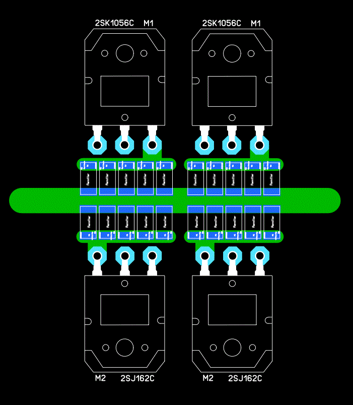

The symmetry nut in me would offset the bottom transistors so the emitters (and resistors) line up perfectly :)
Edit: Or create a bit more vertical space to guide the emitter trace towards lined up resistors and keep the transistors also lined up.
Lika Dis Here:D
I would like to add a big piece of solid copper #12 AWG would be nice right down the middle of the output trace...

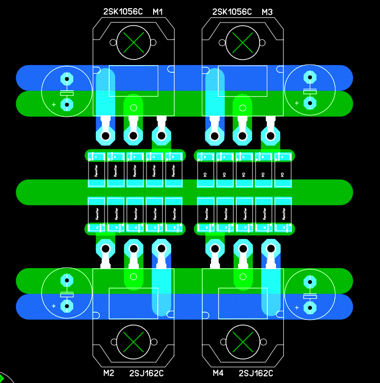

Why not make the ground and rail traces perfectly parallel, directly on top of one another? Then turn the caps 90 degrees. Much less radiated magnetic field, and much less inductance as well.
Yes. :cool::) Its the best way. We explained this over on the Blowtorch (John Curl) forum not too long ago. IMO -- Always do it this way.
THx-RNMarsh
