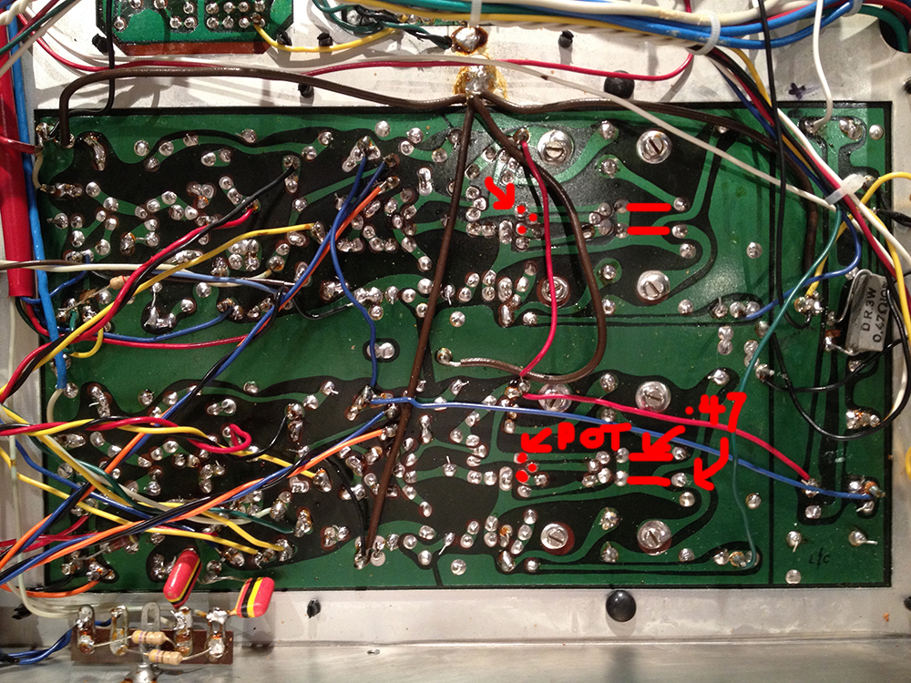

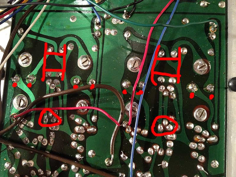

I have included images of the area in question so hopefully you guys may see something. The small circles are the contacts for the trims and the other lines indicate where the .47 ohms resistors are.

Good pics and helpful, thanks.
I can make out that the lower 0.47R resistor of each pair is connected to the collector of the lower of each pair of power transistors (that's to the bolt heads you see connecting the case/collector through the PCB). The other end of the resistor connects to the output DC point and that is the where the large output cap leading to the speaker terminals looks to be connected, as we might expect .
The upper 0.47R resistors (of each pair) are also connected to that node and though I can't really see this, it must then connect to the emitter of the upper transistor. The T03 transistor pinouts look like this:
The collector of the second transitor then connects direct to ground. In other words, it's a standard Quasi-complementary audio output stage and you definitely should see some bias current through those resistors if the amplifier bias control works as the bulb brightening suggests and you have reasonable audio.
It occurred to me that you might have had the meter set to DC current instead of voltage for this bias current measurement. (?) It does happen, since you are looking to measure current but not as such - it's the mV drop across the resistor(s) you need, and that may be treated as a current measurement, specific to the resistor used. Perhaps this is just needless advice too.
Try placing the probes across both resistors in series. i.e. measure between the right side resistor leads, (as they appear in your first pic. above, marked with the parallel lines) of each resistor pair and see what you measure as DCV then, which should simply be twice the reading across any single resistor but perhaps easier to read.

Well those 0.47 ohms are we are looking for. If you measure across both together (so second picture measuring across the two top connections of each pair) do you get a voltage and does that voltage vary at all ? It can be helpful to tag wires to those points and stuff them in the meter sockets to get a good connection.

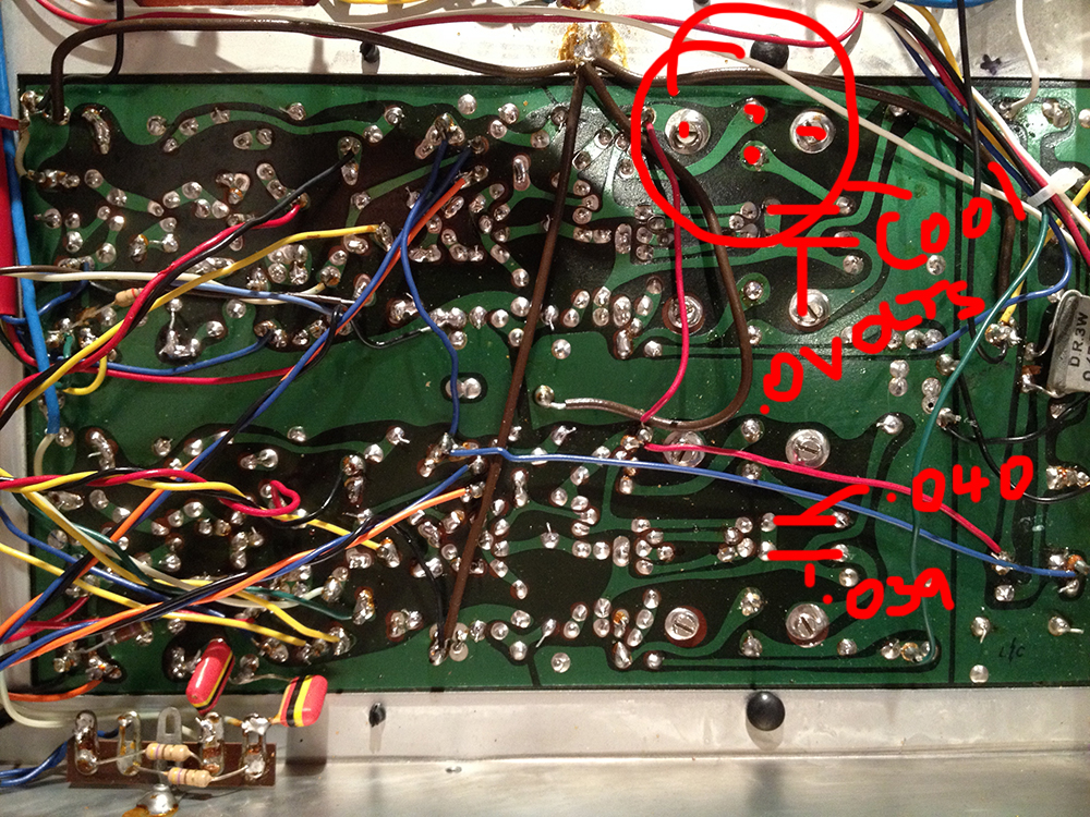

Thanks and will conduct more test based on this a advice. I seem to have got rid of the distortion by turing up the trims to where they were before I started this. What I have notice is that one of the trannies on the Left channel is cool while the other 3 are warm to the touch.
It is indicated in the pic below.
Right channel reading .039 and .040 and no voltage reading on the left. Measured across each resistor.

0.04 volts across 0.47 ohm is not far off 100ma. Too high I would say for something like this.
If one transistor is cold then that indicates that the mid point voltage is incorrect. On an AC coupled amp, the amplifier output (which is the junction of those 0.47 ohms) should be at about one half of the supply voltage. So that's around 18 volts on a 36 volt rail.
Edit or maybe not because the heatsink is shared by one from each channel. So maybe there is a "no bias" situation on that channel with the cold transistor.
Check the reading on both channels.

Not sure I follow Mooly.
One thing I know is that each terminal of each of those resistors is getting 18V.
The right channel I can read voltage across them, but not the left:confused:
The resistors seem to check out ok and not faulty.

The 18 volts is the midpoint I mentioned. So both channels are correct on that. Looks like you have a bias issue then if one channel adjusts and the other doesn't.

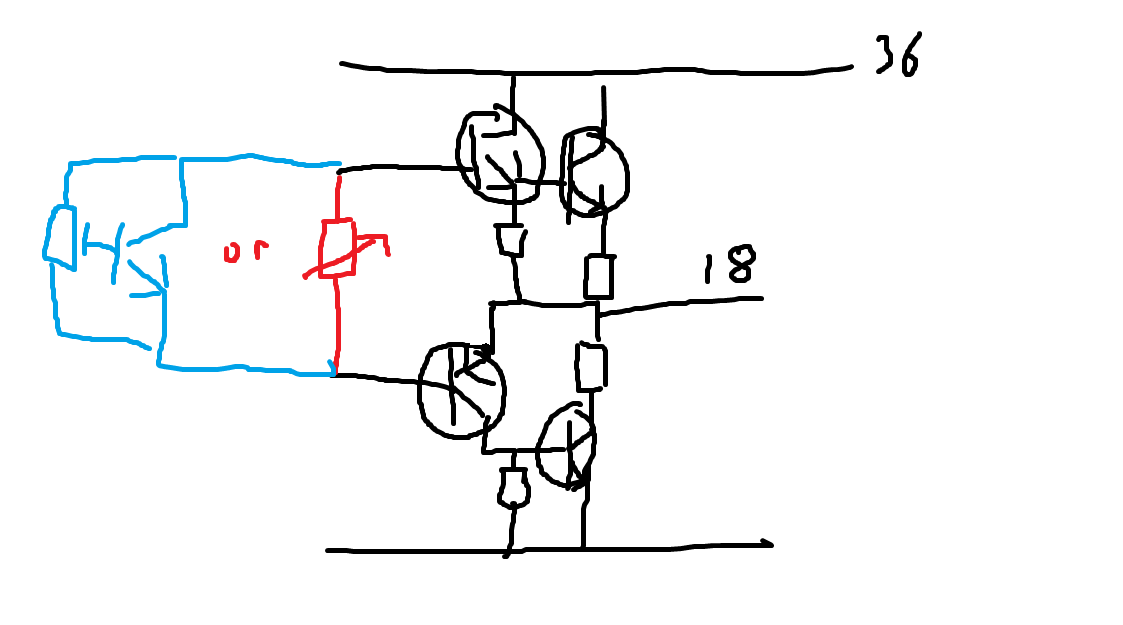

You need to try and draw the circuit around the preset. The way it will work is this...
The preset will allow the voltage between the two driver transistors to increase as its turned. These days a transistor is used with the pot (a vbe multiplier) but yours may be much more basic and just have the pot between the bases (perhaps with diodes or the thermistor in series with it).

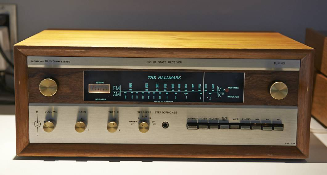

Well Mooly, been a while, but I have this baby up and running. It turned out that all that was needed was a few transistors on the amp board that needed replacing. I did a full recap, but not those funny candy coloured ones:D
She sounds positively delicious for an old gal. I have it at my office and playing through a pair of Elac BS123's. Excellent detail, nice extended bass and controlled highs. Sound stage is wide and detailed. Frankly a very nice little purchase for the $25.00 I paid for it. Cleaned up the cabinet as well so she even looks pretty. Pic attached.
