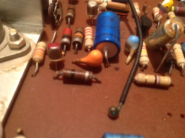

Any help on getting values for those funny looking caps Mooly.

I'm normally quite good at finding data for obscure components but these have beaten me.

They are the pin-up caps: ceramic group II, and they certainly don't need to be replaced.
Color code is the same as for other components, like "tropical fish" ones
I see the ones at the foreground now but I would need to see it close up.
The orange ones at the back... could they be thermistors ?
No, they are probably 3nF-something: http://frank.pocnet.net/other/Philips/ColourCodeRC1966.pdfI see the ones at the foreground now but I would need to see it close up.

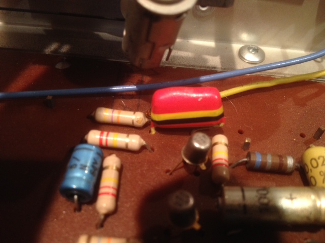

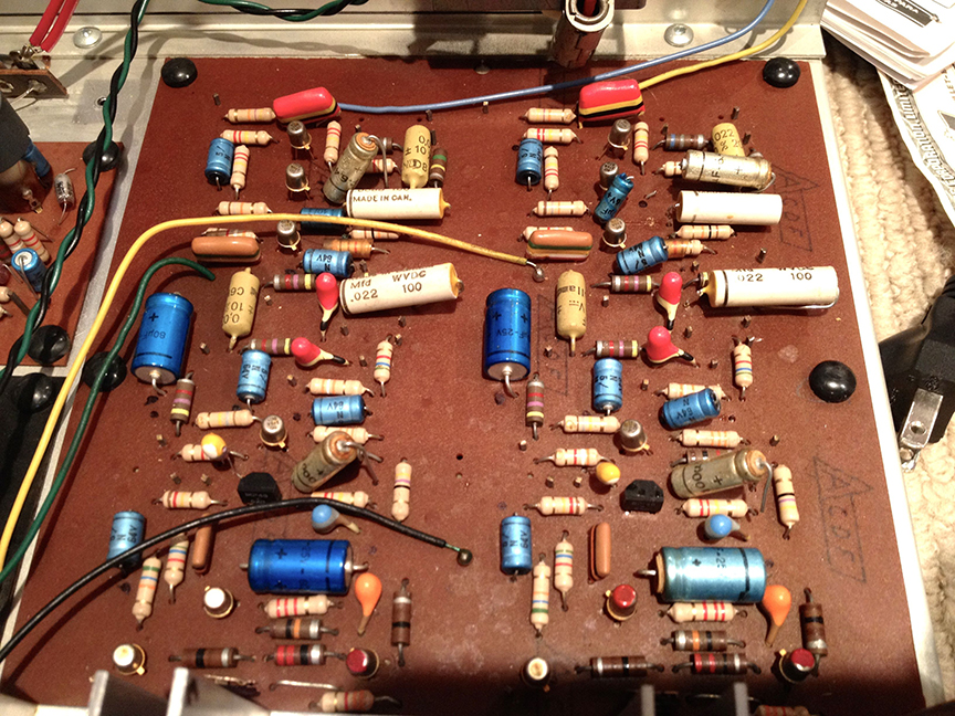

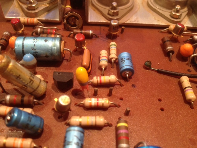

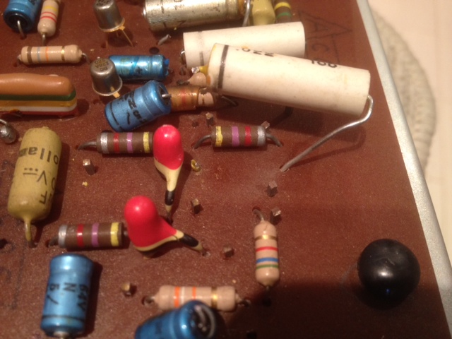

I will be recapping and have the parts list ready to go when. The pesky coloured caps I have taken some close-ups, see attached, for ID purposes. I will then yank one known good 93SE133 and the suspect one and see if I can determine PNP or NPN. That would help us I am sure. May also determine, if indeed, the suspect is shorted.
One other thing, the small blue electrolytics, 15 I think in total on the various boards, have the number 5/N 64V as a marking. I am assuming that is 5 uf. Is that correct?

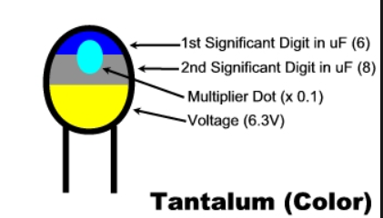

The yellow ones are tants, if you google tantalum colour codes you will be able to figure the values out. (That electro in the third picture looks to have something oozing ? from it)
Elvees correct on the stand up ceramics... I can't recall ever coming across that style, and could only find one picture of them on a "vintage" site.
The orange ones, I'm still not sure tbh although they do look like caps of yesteryear. Its difficult interpreting pictures sometimes. That white cap looks to have one lead snapped off and so do a couple of the electros.
Yes 5uf at 64 volt, so 4.7uf at 63v in todays money.

The tants are messy to read... well messy because they don't automatically "register" with not having worked much with them. With resistors you just look at them and know the values without having to mentally think. These and its back to basics... now which is the multiplier... what does the spot mean

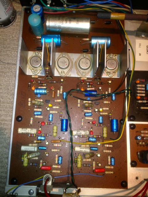

Was able to yank the Driver Transistors out last night. A test shows that they are fine with no apparent shorts or leakage. They are reading as PNP transistors. I was lucky as 2 of them had the letters "B" - "C" engraved beside the 2 pins which makes the case the Emitter. Following this procedure PNP was the analysis. This is good news since it looks like I will not have to find replacements after all.
I had noticed that one of the leads from one of the Reservoir Caps was not attached to the board. So this maybe part of the problem. After a recap we will see. Just hoping none of the smaller transistors are at faulty.

I am taking a stab at those small colures caps.
The large horizontals one is a 0.22uf and the small roundish ones are 0.0000022uf.

The C280 series one looks like a 0.22 (can't make the pic any bigger).
0.0000022uf is 2.2pf... which is very very small but a valid value non the less. Are you sure that is what they are ? See these equals signs ==

I am going off of this site Capacitor Colour Codes and Colour Code Descriptions
The red band on the larger one is a double red and same goes for the smaller cap. This is, as I understand it Red, Red and then the Multiplier. The small cap I am reading the third band as white although it looks cream. I am putting that down to age.
I'll be honest, those little caps are outside my comfort zone
I say that because I'm so used to working on what I'm familiar with (when it was the day job) that I don't actually "read" the colour codes, in exactly the same way that you don't see individual letters making up words. You see a collection of letters as a whole word, I see a 0.22uf cap, not a red, red, yellow and black. Same for resistors, I see the value, not the colours.
Now those little caps are totally unfamiliar so I would have to look up exactly what they are and exactly what the multipliers etc are to see how the code is constructed.

I hope to have the the lyrics in and the large transistors replaced as well in a day or two. I have cleaned the trannies and got new mica insulators as well.
Should I be reading my voltages across the emitter resistors? Perhaps I should start off by turning the pots all the way to the left.
