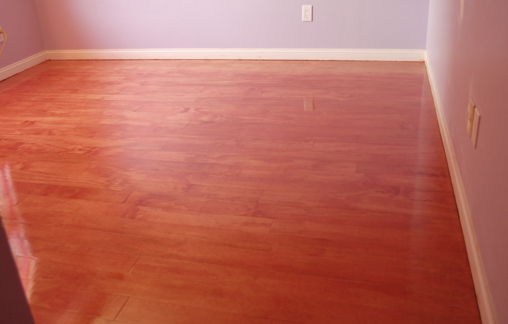

Any plans on dressing them up a bit? That plywood can look pretty good with some attention - I actually did a finished floor with it a while back that turned out nice.

That looks better than nice, you are being modest. You ripped into planks and T&G'd it?That plywood can look pretty good with some attention - I actually did a finished floor with it a while back that turned out nice.

Thanks again Cal! The strips were ripped square edge and face nailed (with brads) and glued to the plywood subfloor. A lot of work to finish but worth it in the end.
