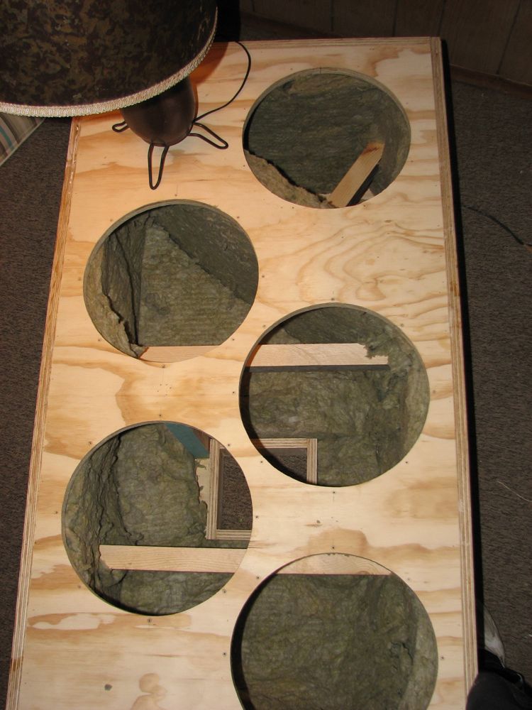

First round of holes. The circled one is the driver center. Keep going? One more round?
You likely need more holes. You don't want so few that it acts like a BR.
I had intended you swiss cheese the entire triangle.

I was kind of hoping you would say that Dave. My drill is at the ready. But, it will be an XO of 200 Hz min. so is it still a BR? Maybe higher than 200 depending on how it sounds.

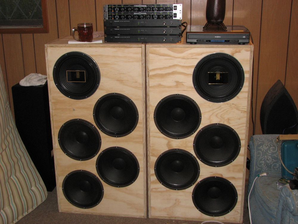

Had a little time today so I loaded the boxes into the truck and took them to the old place and had a go at 'er. Pics of the insulation and then assembled and hooked up. Comments coming up soon. The honey-do list was neglected today so I'm in hiding. She thinks I'm in the bathroom.

Hi John, nice to see you back and thanks for the complements. Ya, cleats, installed ahead of box assembly make Cal's life easy. Funny, when I look at the pic it tells me there's a guy who wears gloves a lot. Not true, I just like to wash my hands in MEK I guess.
Hi John, nice to see you back and thanks for the complements. Ya, cleats, installed ahead of assembly make Cal's life easy when it comes to assembly. Funny, when I look at the pic it tells me there's a guy who wears gloves a lot. Not true, I just like to wash my hands in MEK.
Cal,
That looks to be a speaker worthy of it's celebrated builder! I can hardly wait until you get the other speaker (right channel?) built. That's going to be just awesome.

OK so now for some thoughts:
They are tri-amped with Tascam 30 WPC "semi-pro" amps. They are XO'd with a Behringer 2310 on each. I set them for 200 Hz and 2K to start but when turned up I found that 125 and 3K worked better. I am quite taken by the sensitivity. At no point did I need anything more for the bass. I know those little amps are great but I was thinking I might need one for each channel or maybe even a real amp even for the short 30 minute or so test I did today. No need. These are a real R&R speaker and were so f***ing loud that 30 minutes was all I could take. The bass, while not deep, is really punchy as you'd like from this kind of set up and the Sammi's performed better than expected. The vocals were not laboured and the tweeter with it's massive motor sounded better than I would have thought. All in all I am very pleased.
