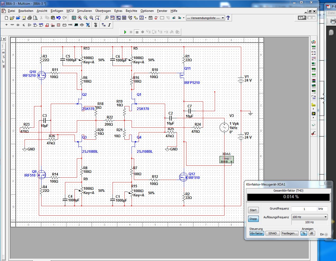

just for fun I simulated the BBA-3 with some feedback.....
when you play with R24/23 and R22 in the circuit you can adjust the gain.
I never heard it....all deviation from the original circuit are due to limitations in my simulation program....
Aleph P still playing and I am still occupied to get my different FW clones close to an original J2 Nelson made... so relaxed and detailed....
this is an invitation to play yourself....

I forgot to mention the main reason for trying feedback, to use BBA-3 as a pre.... and of course the gain was for this use often too high.....
but I do not now how it shapes the sound that we loose NFB quality Man!...

My hint was really thought for someone who has just the BBA-3 on the bench and has no problem to put two 470 R resistors in the right place......
