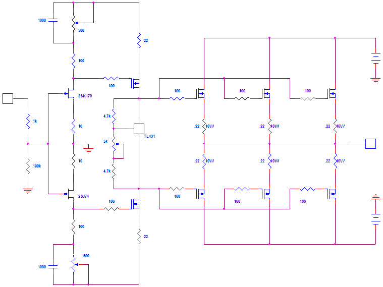

A transistor Vbe multiplier would work in place of the 431 and it would adjust in the normal way to set the output stage bias.
However, if the BA-3 FE with was direct coupled to the output stage as described above (I guess we shouldn't be having this discussion without a schematic) then you would have to use the P1 and P2 pots in the FE to adjust the final output stage offset. P1 and P2 would then be adjusting the 2013/313 bias and the final output offset interactively. The temperature performance of the 2013/313 pair could potentially affect the output offset drift more than one might want. This would need some experimentation to find out what the drift performance would be like.
gl
I looked at the 431 data sheet too. Assuming 9V across the 431 and 45ma through it gives you 405 mw being dissipated. That's higher than I like to run a TO92, especially if it's in an enclosed space.
I'm using Toshiba's 4.2V, maybe, 200mW maybe, with H.S. probably :)
The pot in the JFET drains doesn't set the bias in the 2013/313 stage.
Really? I think it will, and output offset too??? The real question is the overall stability?
The big similarity between the BA-3 FE (and BA-3b) and the A75 FE is that they're designed to be run open loop if that's your thing.
I didn"t get there yet. I stopped hear first, honestly, I would have forgotten if I didn'come back here...
The resistor(s) to ground would carry the 2013/313 bias current so that the 431 doesn't have to.
Well, ther is the capability of leaving it floating (with a little H.S,), but, what will work or sound better?
I think you have a cool idea there of trying to simplify the interface between the BA-3 FE and the crippled F4 or BA output section.
Thx, I have to many projects at the moment to acually get back to my BA-3 FE. :violin::violin::violin:
...was direct coupled to the output stage as described above (I guess we shouldn't be having this discussion without a schematic) then you would...

OK I forgot to finish it? There is no FE pwr Supply?

I'm just saying that you can put appropriate resistor in parallel with entire TL431 based voltage reg , if you need greater amount of current through said reg .
it will worsen (slightly) voltage regulation , but - if you need to implement that vertical string in output vertical of some FE (say that that vertical is made of two opposite mosfets ) , with goal to exclude series connected caps ........ then that's neat solution
temp compensation ....... Papa made some components fashionable lately ......... :clown: sometimes you can choose plain NTC for said purpose
I remember Babowana was first Greedy Boy , testing NTC's in some Zen project
edit: I did exactly that (resistor in parallel with 431 circ) drawing some funny Babelfish XA 30.5 amp , with goal to have it :

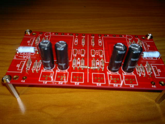

I am going to order the boards for a balanced Ba-3 I need the front end board (BAGSv2.0&BASB z2.0) and a output board (BaCb v2.0 &Bacov 2.0)
Right so It says these are 2 chanels so the (BAGSv2.0&BASB z2.0) board has + in and - in one chanel in,so 1 channel, V + and V- is power supply in,Now here's where I need the help,lol the D+ needs one board like the ba output stage D- needs another output stage,I see the power in ,But what is D and out? and on the front board I have D+ D-,and S where do these connect ? D+ I see And this tells me I need 4 output stages and 2 input stages for L&R stereo?
I know I am suppose to be getting smarter at this but too many boards and too many names for them,I was ok until we got off ba-1 ba-2 ba-3, BBA,
Thanks alot,
