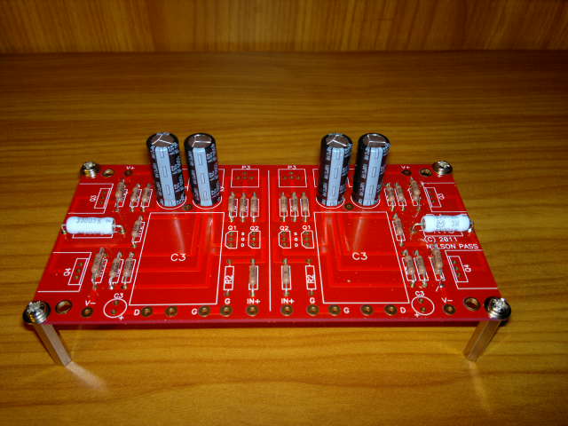

Some progress

I don't like trim pots. They are necessay sometimes. Ussually you can sit on them and play for a while to get a good idea of the long term stability, and then replace with a fixed "Audiophile" type component. Or, I use Vi$hay metal foil trim pot$. The long one$ Ive u$ed are black. The $quare one$ on my B3 are green.
The cap issue is interesting. Ive got a few to try that should be of a sufficient voltage breakdown but fit the footprint. and a big poly similar to what N.P. used. what was that big Pass cap?
Yep, I'm not sure what series I have at the moment. Can't go look, but I got something like that, that fit. Not outrageously expensive as I recall...
I might just have one a couple of those Axon's too!
Actually I'm waiting to try a more direct coupling method, without the cap. Just the tl431 between the MOSFETs We'll see...
Keeping them separate allows you to adjust the bias through the 2013/313's independently from setting the operating current through the 431. Plus, I don't know how the 431 would feel about 45+ ma running through it. Would need to check on that.
You could consider a traditional discrete Vbe multiplier.
Graeme
flg,
Check out the A75 part 1 article on the passdiy site and look at fig. 9.
You could try putting your tl431 between the 2013 and 313 then use two 620 or 680 ohm resistors to ground from each drain in place of R13 in the BA-3 FE. Like R24 and R25 in the A75. I would put a good sized cap around the 431 too. That keeps the front end bias/gain adjustment separate from the output bias and keeps the current through the 431 down - and no coupling caps.
If it was me, I'd give it a shot.
gl
I hadn't used a tl431 at that high a current before either but, I went and looked. it should do it. Maybe a little heat sink is in order...
as for the resistors to GND, I've seen both ways???
As for the adjusting output bias, it would still be with the TL pot. The 2013/313's bias would still be the pot bypassed by the cap in th JFET darins.
:D
I looked at the 431 data sheet too. Assuming 9V across the 431 and 45ma through it gives you 405 mw being dissipated. That's higher than I like to run a TO92, especially if it's in an enclosed space.
The pot in the JFET drains doesn't set the bias in the 2013/313 stage.
The big similarity between the BA-3 FE (and BA-3b) and the A75 FE is that they're designed to be run open loop if that's your thing.
The resistor(s) to ground would carry the 2013/313 bias current so that the 431 doesn't have to.
I think you have a cool idea there of trying to simplify the interface between the BA-3 FE and the crippled F4 or BA output section.
