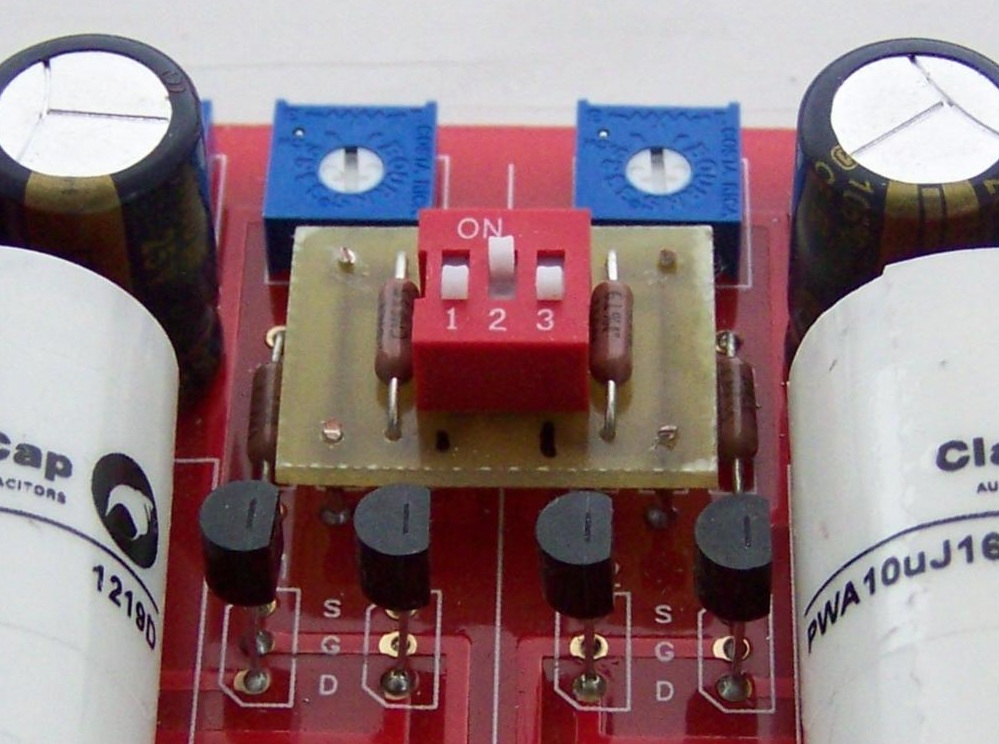

...and here is the complete BA-3 board
hey, thats a great way to do it
hmm, means in SE mode there will be 4 output channels available, yes ?

Here are small knapsack circuits ......
OFF-ON-OFF = balanced, the two 100R resistors are in line, ON-OFF-ON =unbalanced, the two resistors are laid to ground.
what kind of switch is best ?
this one, or small toggle switch ?
but if the changing from, SE in and balanced out, to SE in SE out, then what happens around the input output interconnect plugs
more things will change
No, nothing else has to be switched. Just install one XLR input and output terminal each for balanced mode (one channel) and two RCA terminals each for unbalanced stereo mode (two channels). So you can operate the BA-3 module eather balanced mono or unbalanced stereo by simply connecting the XLRs or the RCAs to your source and the following power stages (you have to switch the small onboard DIL switch accordingly, of course).
Sorry, I misunderstood your comment. But SE in and balanced out is not an issue, too. Connect the right channel RCA in to your source and stick a shortcut U-plug into the XLR in (from – in to ground). That’s all.
And that's pin 1 to pin 3...
