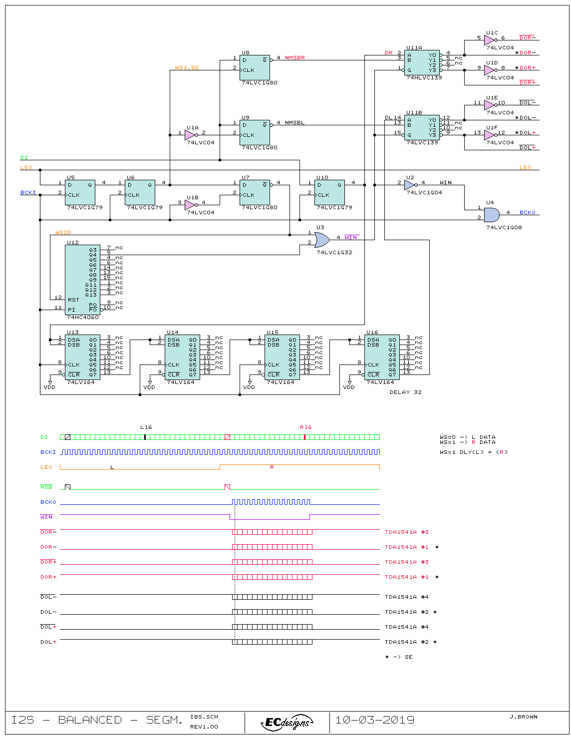

Hi xaled,
I made a new schematic for the I2S to (balanced) segmented decoder.
Decoding is simplified using the 74LVC139 decoder / demultiplexer.
Inverted and non-inverted signals are available for SE (2 x TDA1541A) and balanced (4 x TDA1541A) DACs.
Data muting is fixed by using the /E inputs of the 74LVC139. "0" on this /E input will enable the outputs. When outputs are disabled, all outputs are "1". because the 74LVC139 is enabled with a "0" U3 is changed to an OR gate (74LVC1G32).
BCKO has to be enabled with a "1" so an inverter (U2) is added
The remaining 6 inverters (purple) are part of a 74LVC04 HEX inverter.
The window has been moved to WS=1 zone by using a 74LVC80 (U7) to reset the counter and enable the window. Left data is loaded first while WS=0 and put through the 32 bit delay line. When WS=1 the R channel data is clocked out together with the delayed and now aligned L channel data.
U5 ... U10 may be replaced by 3 x 74LVC74. Verify that the correct outputs are used, 74LVC79 -> use Q output of the 74LVC1G74, 74LVC1G80 (use /Q output of the 74LVC1G74).
The outputs for a SE version are indicated with an asterisk (*).

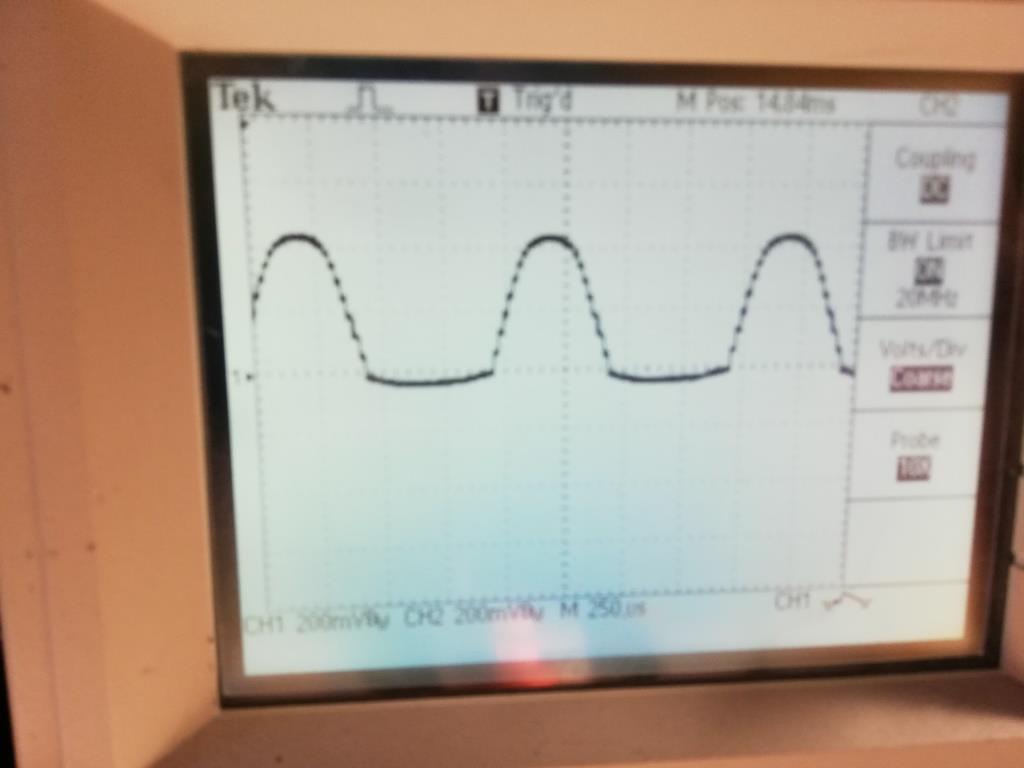

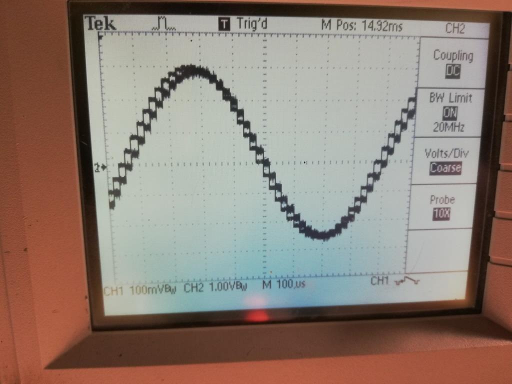

Hi koldby,
There are tolerances between L and R channel full scale current and tolerances between full scale current of different TDA1541A chips.
The full scale current equals approx. -4mA.
Put a separate 150R I/V resistor & +2mA bias current on each of the segment outputs. Now sum both outputs together using a summing circuit (2 x 1K resistor to a summing node for example). It is important that the 1K resistors come -after- the I/V resistor, not between TDA1541A output and I/V resistor!
Now you can trim one 150R I/V resistor, so that the full scale currents for both segments are exactly the same. By varying the I/V resistor value slightly, the ac voltage across that I/V resistor and related full scale voltage will also vary slightly.
One could also use a step-up transformer with multiple primary windings for summing the segment outputs.
I am not quite sure what you are saying here?
Is it between L and R channel or is it the channel difference between the two DAC's inside one TDA1541A that is used to form the single Signed Magnitude
DAC?
If your are talking about the last situation, then I do not think this could work , as you have to connect the two 150 Ohm resistors when done, and then nothing has been gained. If you use one 150 ohm on each of the DAC's (DAC- and DAC+) and sample the two outputs with 1 KOhm resistors, you get severe distortion at least with full scale digital input.
But that was exactly what I did and got severe distortion @ full scale. Maybe I should try it again...Hi koldby,

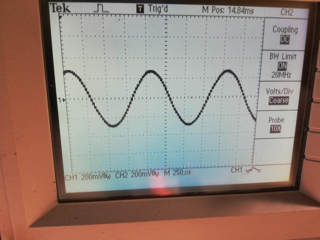

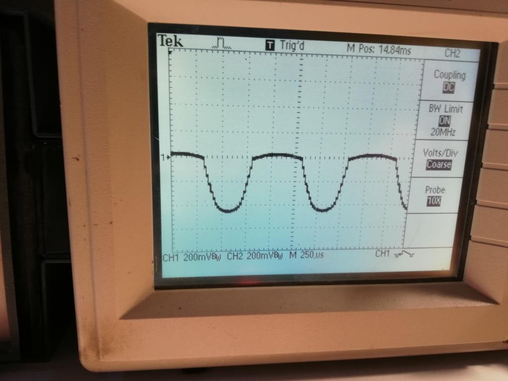

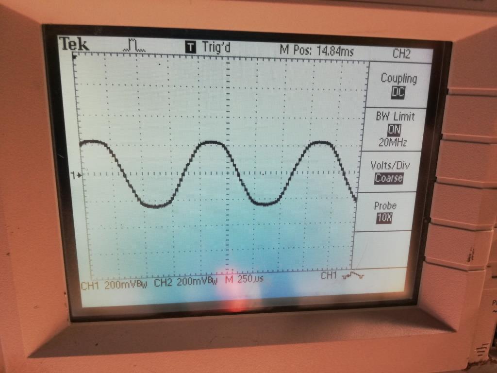

I still do not think this works properly.Hi koldby,
Pic.27 shows the summed output from the two 1KOhm resistors connected to each of the 150 Ohm resistorsthat is connected between the outputs of TDA1541A and ground.
Pic 28 & 29 shows the signal on each of the outputs directly across the 150 Ohms and with the two 1 KOhm in series connecting the two 150 Ohm.
Pic 29 shows the outputs when connecting the two 150 Ohms (and thereby also the two outputs)(short circuit the two 1KOhm resistors).
Now I speculate, and I have been known to be error prone in this art at times o), that this comes from the special behavior of the DO- outputs. When you look at the outputs only with 150 Ohm to ground and not connected together, the DO+ is a perfect half sinus going positive and ,with proper bias resistor, with a baseline @ 0V.
But if you look at the DO-, you have a perfect half sinus going negative and a baseline @ 0 V without a bias resistor. I think it is because the DAC that handles the DO- is loaded with 1111111111111111 with no digital input to the Signed Magnitude converter and therefore puts out 0 mA into the 150 Ohm resistor.
I am not sure why the outputs are behaving as they do, with a 2KOhm resistor( the two 1KOhm resistors in series) connected between them.
Hi xaled,
Hi ecdesigns,
I'm reworking my board to interface stacked TDA board(s) and this will be the basis for it.
As always I highly appreciate your input.
After working more with the signed magnitude converter , I have realized, that the bias and I/V component values are actually wrong.
It is because the two dac's (dac+ and dac- ) are not working in parallel.
The dac+ is the only one that needs 2 mA bias and therefor the bias resistor must be 2.5 kOnms and it can only swing to + 2mA and the dac- do not need bias (all its current sources is off when not getting any data) and wil only swing to -2mA as it does not receive data that will make it swing further negative.
So the combination of the two dac's can only swing +/- 2mA and not +/- 4 mA and therefore the I/V resistor should be 150 Ohm and not 75 Ohm to make the same voltage swing as a TDA1541A working normally.
Hi Kolby,Here is a picture of the phase difference between L and R, as John mentioned.
How do you plan to compensate this phase difference?
