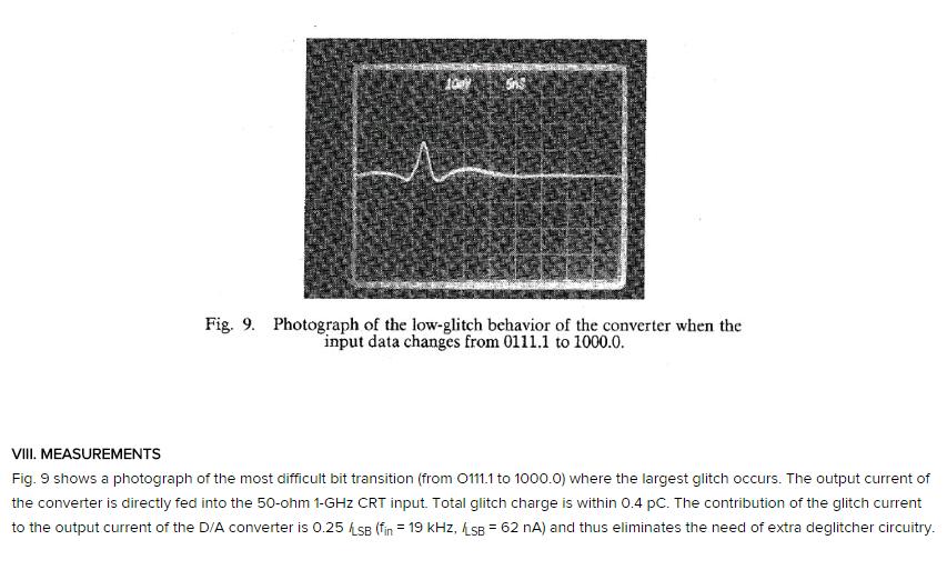

It is not I that says it is an improvement, it is ecdesigns, I only visualized the problem he was talking about and that the the signed magnitude actually eliminates that.
If it is an improvement , soundwise, I cannot comment on as I haven't heard it yet.
I do not have an AP or other sofisticated measuring tools, so I cannot perform a measurement as you show, everything drowns in noise in my measure equipment at those levels.

I would not ignore such a spike even though the level of energy stored in there seems small. I think there is a reason why a lot of the highly rated multibit DACs do use signed magnitude. They have other issues as they for the most part are R2R DACs. And I think there is a reason why John says this is the best way to use a TDA1541A. I personally do not care if the 2. order harmonic is only down 60 dB, but it could be an indicator of something else wrong. I would really like to hear what level of 2. harmonic John experienced , when he made that circuit.

I've heard about this before and now i took the time to read your explanation, ecdesigns explanation too, but the photo with that spike convinced me for once that i can fully ignore this issue.
Reason:
The spike has less than 1/10...1/20 of the energy than a whole step, its not even the same voltage magnitude as the upper step, so the integer circuit after it will simply swallow it.
More on this, at lower levels the i/v circuit noise itself can mask that spike entirely .Dithering in mastering audio(being it done by the sound engineer ) can make this problem even more irrelevant because they mix an entire musical program so that you can clearly hear only what's relevant and they think of it in advance, how to make a poor sounding audio system sound reasonably well.

How do you come to that conclusion?
1 LSB , to my calculations, with 1 V out FS corresponds to 15 uV so 0,25 LSB would be less than 4 uV.
Clearly the spike is much bigger than that. It is 15 mV , but I don't have the level of the 300 Hz sinus I was measuring, but I can guaranty it was not more that 5 V.
What's really important is the ENERGY of that spike which is close to nothing compared to a full step energy while the step itself isn't much...

Thanks. Well if you are happy with that, fine by me. I am not sure I have tried that particular opamp, but a lot of others that people told were the way to go (LM4562, LME49720 and many more not present in my memory), and still I prefer discrete solutions and in TDA1541A especially a passive solution. At some point I will try the LM6172 though.
Have you ever tried a passive solution with a Sowter transformer?
Here is a fragment of the article mentioned above.
