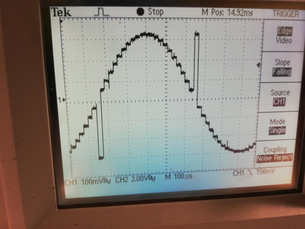

So I finally got to connect the signed magnitude converter to a TDA1541A.
I have a test DAC with Johns I2S to Simultaneous converter and a modified Red Baron TDA1541A dac. Not the same as my main dac as this is a balanced dac but again with Johns I2S to Sim. converter.
So I could just swap the I2S to Sim with I2S to Signed. and disconnect the I/U converter and connect the two outputs from the TDA1541A to each other and a 100 Ohm to GND and a 1KOhm to +5 V.
The converter did not work as planned.
I switched back to the old configuration just to be sure, but that worked perfectly.
I2S to Signed in again and here are the results:
Pic. 9 shows the output with a full scale 1 Khz digital signal.
Can anybody please help here???

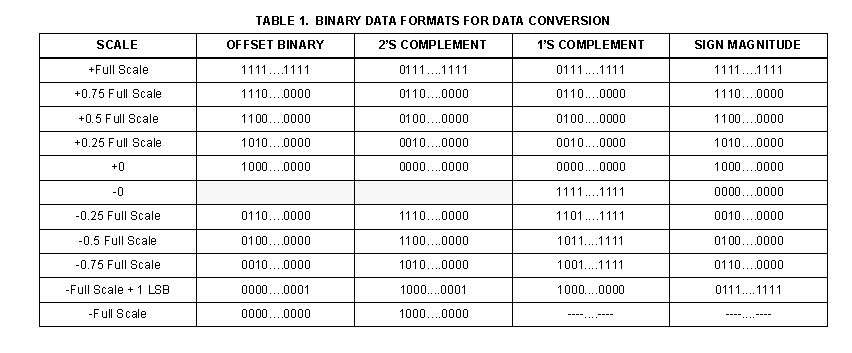

How are you handling the fact that the dac requires offset binary and you have got Signed Magnitude?
Does photo 9 not show what you get if you feed in SM instead of OB?

This problem can be fixed if we use a signed magnitude DAC. As the name implies we have a sign bit (positive or negative) indicating the polarity and magnitude information (number) that, well determines the signal magnitude.
And what's so different about this approach?
With signed magnitude we usually have two identical DACs. One handles the positive signal halve only, the other handles the negative signal half only.
Now we can step away from the zero crossing with small steps in both directions like this:
Signal rises from zero crossing to plus, 000000000000000 -> 000000000000001 -> 000000000000010 and so on. L channel never goes below 000000000000000, we have only one bit flipping around the signal crossover, positive DAC is working, negative DAC takes a break.
Signal drops from zero crossing to minus, 111111111111111 -> 111111111111110 -> 111111111111101 and so on. R channel never goes above 111111111111111, we have only one bit flipping around the signal crossover. negative DAC is working, positive DAC takes a break.
MSB now becomes the sign bit that controls the polarity and no longer shows up in the data (magnitude) of both DACs. So we have a spare (extra) bit where MSB used to be. Now we can also double the resolution.

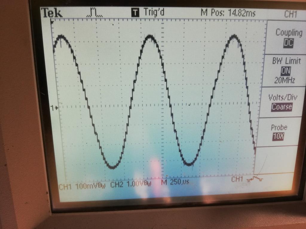

Maybe now a little closer to a solution.
I found out, that if I adjusted my Wave generator to exactly the same frequency in R and L channel I got the result in pic. 21
Pretty close to what it should be, right?

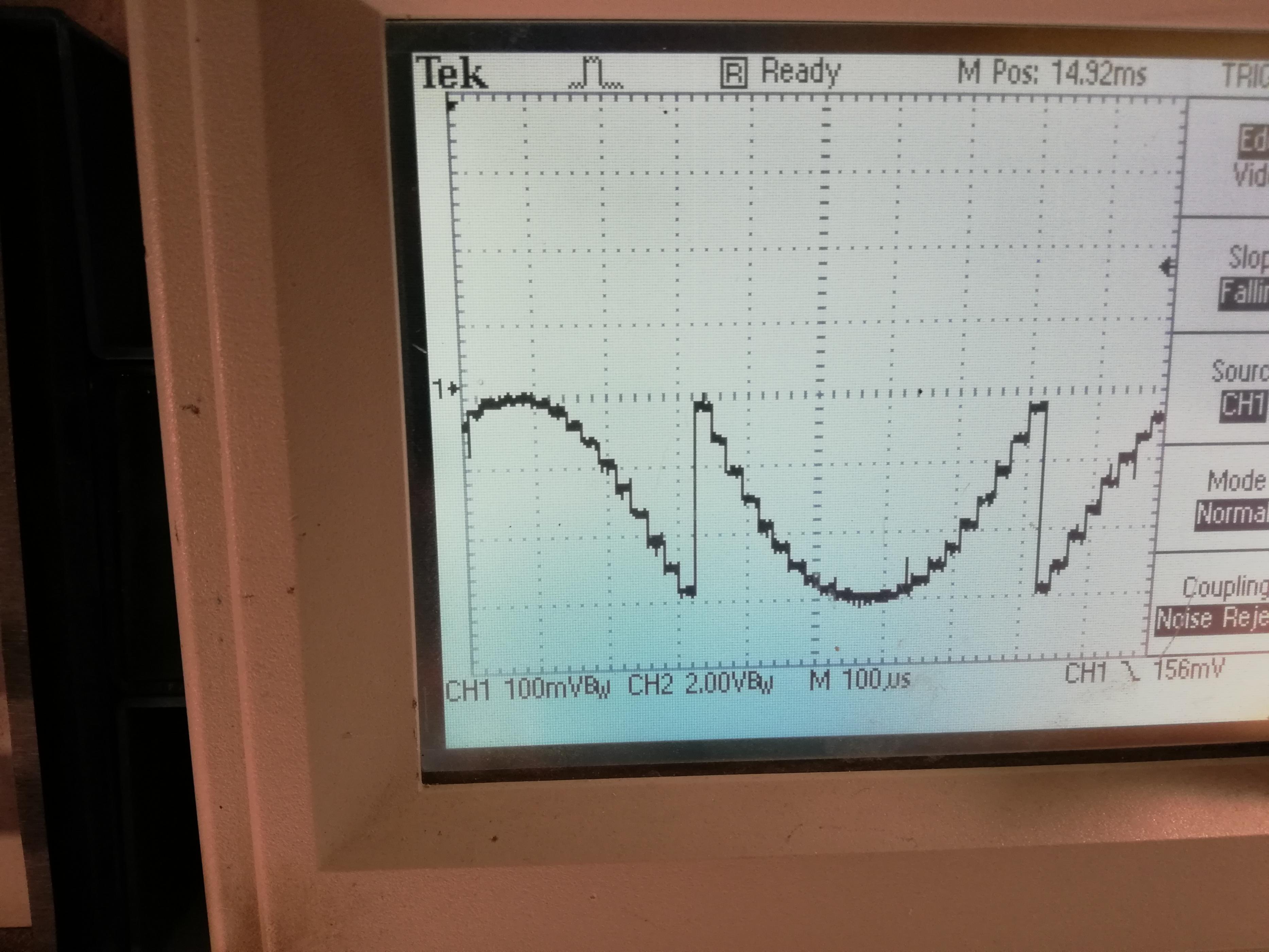

It dosent matter what the level is in the other channel, it dose not alter the audio out.
If I alter the frequency so they are different in the two channels it all goes wacko.
And if I completely mute the other channel (no data and therefore no MSB in that channel) the result is as in pic.22
I think I can conclude, that the MSB from the other channel affects the channel I am measuring. So here is what we should be looking after.

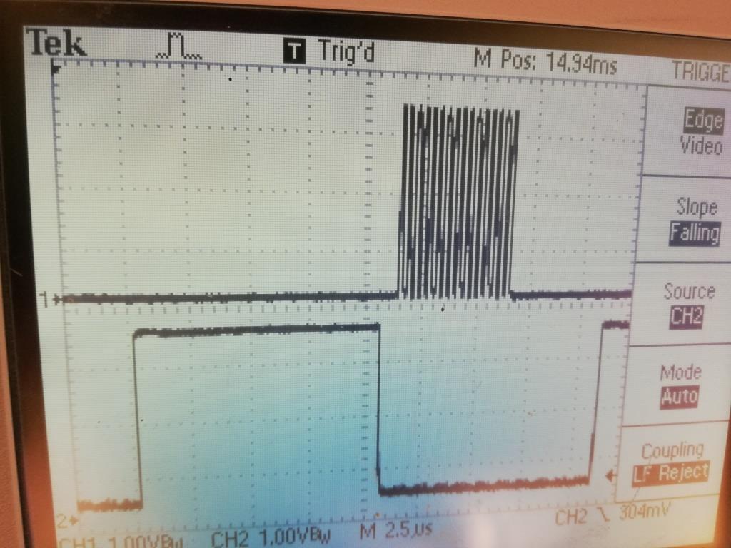

You are right, xaled, it is not the 1 bit delay.

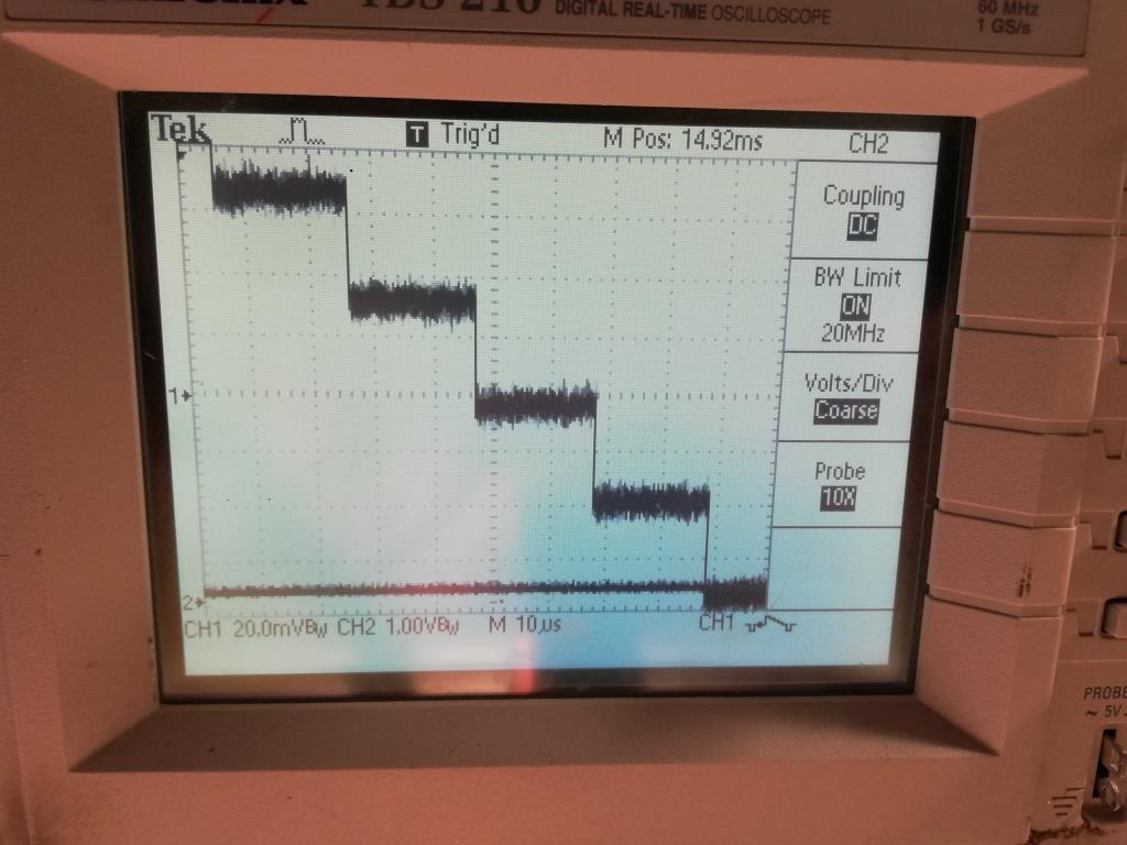

In order to clean up the signals from the Sim. converter , I mounted and gates on the four ( DOL+ DOL- DOR+ DOR- ) data outputs and this means there are no data present outside the clk window.
Pic.23 shows DOR- before the and gate and Pic. 24 after. The other trace is the BCK01.
BUT!!!
Now I have moved even closer to a solution. I asked xaled if he could make some wav. files with only data for one channel. That he did and now it is obvious whats wrong.!

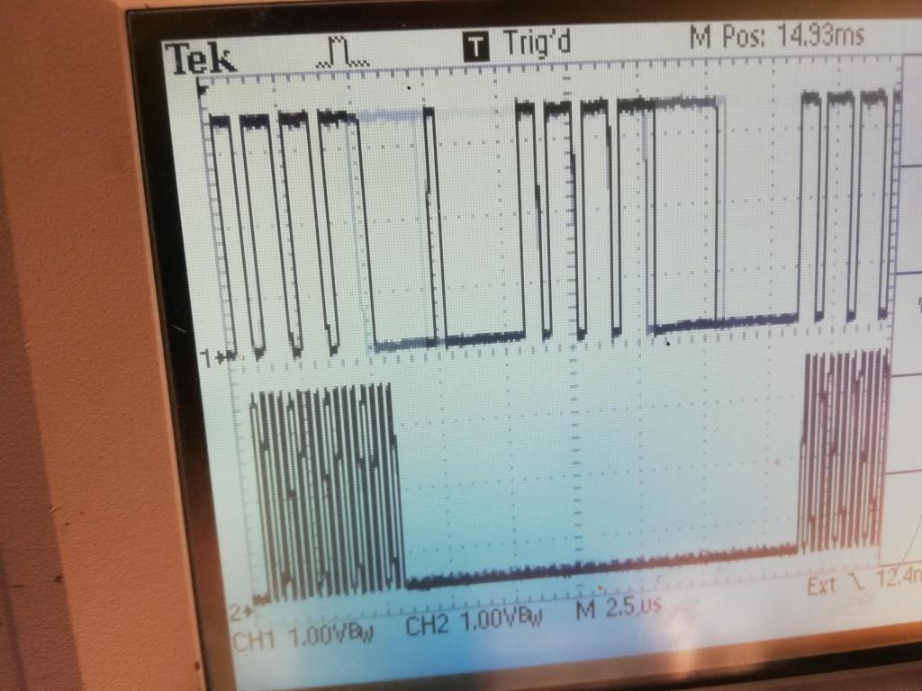

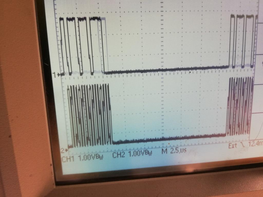

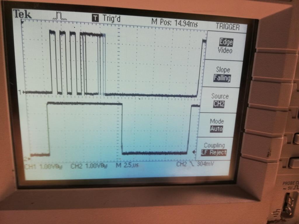

Pic . 25 shows LE and BCK01. See the clock starts shortly after the falling edge.
Pic. 26 shows DATA-R @ U6 pin 4 while playing a wav. file with only data in the right channel. Data starts just after the rising edge..
So it is the data from the wrong channel that is being clocked in.

Hi koldby
The original signed magnitude decoder circuit was designed and tested for use with Left Justified input.
It was later modified for I2S by adding an extra 1 bit delay and swapping the channels.
Unfortunately the MSB's were left unchanged and that means that the L channel MSB is used for the Right channel data and vice versa.
LJ: WS=0 -> Right channel data, WS=1 -> Left channel data.
I2S: WS=0 -> Left channel data, WS=1 -> Right channel data.
If we look at the schematic for the I2S version MSB (R) is sampled on the rising edge of WS.
However, the Right channel data appears after the falling edge of WS.
This can be easily fixed by swapping the outputs 6 and 8 of the 74xx74 dual flip-flop U21.

Hi John,
Of course you were right, I must have made an error first time I tried to swap NML and NMR because now , after swapping again ( pin 6 of U21 connected to pin 12 of U14 and pin 8 of U21 connected to pin 4 of U14) the resul is as shown in the Pic.

Remember I posted a picture of a the spikes around zero crossing in post 6575?
That is the second pic shown. It is one TDA1541A fed by Johns (and ryanj's) I2S to simultaneous converter.
The first picture is two TDA1541A fed by Johns (and xaled's) signed magnitude converter.
See the spike is totally gone around zero crossing. The first is a little more noisy, but I think it is because I measure directly over the 75 Ohm I/V resistor with no amplification after.

Nice to see the zero crossing spike gone with John's Signed Magnitude converter!

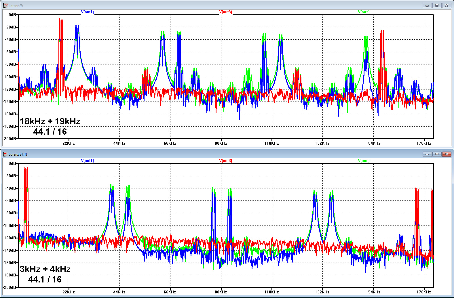

Just out of curiousity, I made an LTSpice model with 3 variants, see image below.
1: No time time shifting, but 4 16bits Dac's converting at the same time, thereby improving accuracy and reducing noise in green, called V(Nos)
2: 4 16 bits Dac's time shifted giving much smaller interpolation steps in blue, called V(Out1)
3: A 4 times oversampled signal, as a reference in red, called V(Out3)
I'm very well aware of the fact that simulating is one thing and listening has it's own dynamic's, but nevertheless, base on the sim I have a few points.
When reconstructing a signal wit a DAC, it will be multiplied in magnitude by a sin(x)/x, making that f.i a 19kHz signal will be attenuated by 2.8dB when reconstructing at 44,1kHz.
When interpolating with 4 time shifted samples, this 2.8dB can easily double to 6dB.
So FR with this type of interpolating will have an earlier roll off, not a big deal, but nevertheless.
Looking at the spectra below for non shifting versus shifting the samples gives the same advantage in correcting individual errors between Dac's.
So what remains is that the first, second and third super sonic spectra are attenuated a bit, but the fourth at 176kHz is again at full strength.
After this long introduction, a simple question: in this sim the advantage of time shifting didn't become obvious, so I'm just curious whether you have auditioned this setup to a version where no time shifting takes place with just 4 Dac's parallel in time.
Thanks in advance,
