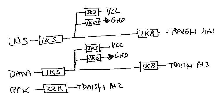

Hi John,
"WS and DATA input signals were attenuated, each input, 3K3 to +5V, 1K to GND, and 3K3 from input to WS / DATA output. This significantly reduces HF interference being dumped on the DAC chip substrate."
at the moment I have 10 ohm resistors in series with the WS,DATA and BCK signals, please could you post a quick schematic of the above arrangement, just to be sure that I have got it down right. (10R to 3.3K seems like a big jump!)

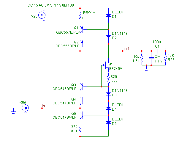

I also have a couple of kits (pcbs and parts) that I intend to use for the I/V conversion on one of my diy TDA1541 DACs: please see attached file. I originally bought these kits from the diyparadise site for one of my other TDA1543 DACs and found them to sound better than my OPamp tube output I/V. From info provided in earlier posts I think they will be ideal for the TDA1541. - am I correct. I was going to use a seperate charge tfr power supply for around 20v plus Super regulators for this.
keep up the good work.
cheers Jonners,
I think that the "less simple I/V circuit" is the way to go for the tda1541.

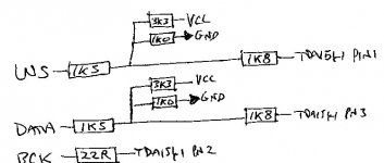

John,
quote: "WS and DATA input signals were attenuated, each input, 3K3 to +5V, 1K to GND, and 3K3 from input to WS / DATA output. This significantly reduces HF interference being dumped on the DAC chip substrate."
I would still like to see a schematic of the input attenuation scheme described above.
Brad

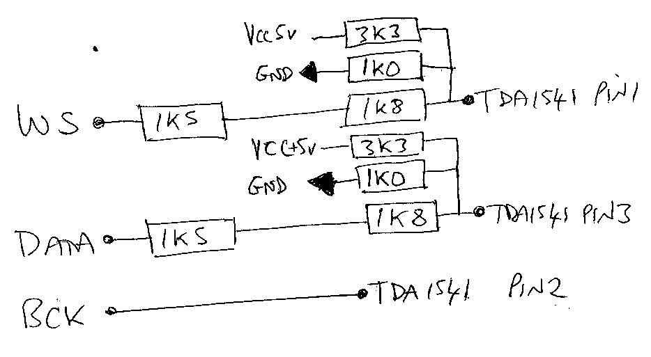

Hi Builder Brad,
I read back into this thread to see if I could find more info on the current attenuation scheme for the WS, BCK and DATA streams, and have posted the following sketch just to be sure that I have got it right:
Almost, I no longer use a damping resistor for BCK input (buffer > DAC clock input is less than half of an inch).
Both 3K3 and 1K are connected to the DAC chip input, and both 1K5 and 1K8 are connected in series. I placed 1K5 close to the transmitter, and the 1K8 close to the DAC chip input.
1K5 > PCB trace > 1K8 > DAC chip input.
3K3 from DAC chip input to VCC
1K from DAC chip input to GND.
The attenuator was tested up to 48 KHz sample rate.
For higher sample rates, all resistor values need to be lowered.
