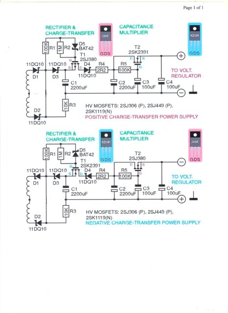

Hi John,
I have just updated the charge transfer schematic to show the connections for transformers without the centre tap - is this the correct way to connect these?
I have also just added the sugested attenuation on the WS and data signals and have now got a problem with the output on the right channel - after about 5 minutes of playback the right channel starts to distort. I may have altered something else, but I think it may be caused by the attenuation scheme.
Brad
Brad
Hi Builder Brad,
You need to use a rectifier bridge (requires 4 rectifier diodes).
This is probably caused by tolerances, as the DAC chip heats-up, the voltage across the internal diodes (digital input circuit) drops. This can be solved by lowering the series resistor value, you could try 2K2 or lower.

THANK-YOU JOHN,
"You need to use a rectifier bridge (requires 4 rectifier diodes)"
I thought that your schematic was giving half wave rectification - providing plenty of time for the mosfets to switch and transfer the charge - looking at the details again I can see that the centre tapped transformer is also connected up for full wave rectification.

Hi John,
I had prepared such a circuit with a full bridge rectifier that I intended to use.
To return to your original circuit we only need to remove D3, D4 and add the jumper.
This way we can use a transformer with center tap or a single winding.
I also worked on a pcb for this circuit. I still need to ajust the footprints for various capacitors to use.
I would appreciate you check it out, if it would be usefull to others on this thread.
I don't know what hapenned, the pdf file did not follow.
I try again, hoping it will work.
