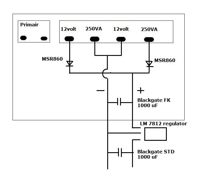

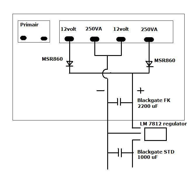

I did it on this way for my DDDAC1543 MK2 FULL-24 Kit, 500VA 2x12volt
Is this the right way to make a good supply?
Sorry for my bad English.
Rudy

I would add some small resistors (0.5 ... 1 Ohm) in series with the diodes to limit peak currents during charging, but you have to check if this doesn't cause too much voltage drop.
Power supply requirements for the master clock are highly critical, these power supplies need to be very clean. I use additional LC filters to achieve this.
