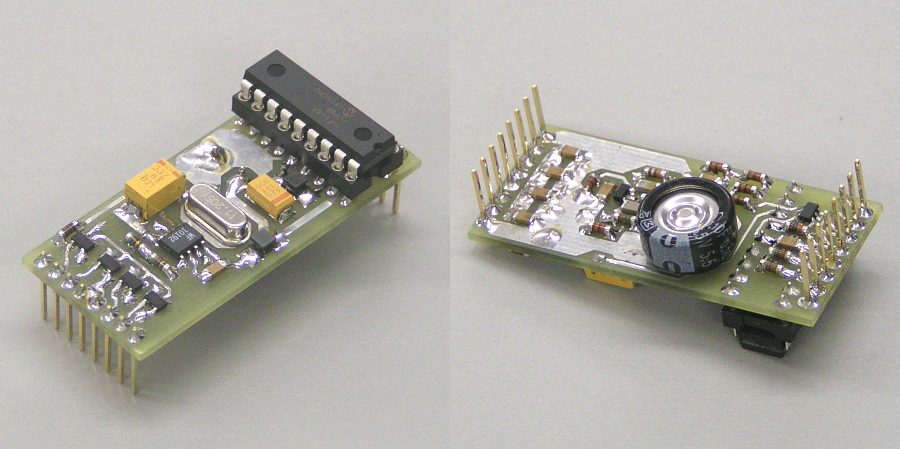

2009 started with some interesting new developments, a new module was designed, this module holds tracker, master clock, and clock buffers.
I attached a picture of this new module,
Picture on the left shows the component side, the micro controller is placed in an IC-socket. It wasn't possible to use an 8 or 14 pin Microchip controller because the timer #1 input pin shares the external clock input pin, and a separate clock and timer #1 input were needed.
At the front there are the 4 UHS clock buffers, they are connected to the master clock using 2 x 47 Ohm series resistors. The VCXO master clock is built around the WF10192 chip that is programmed to divide the master clock by 4, providing exactly 50% duty cycle. The power supplies of micro controller and master clock are separately filtered (LC filters).
Picture on the right shows the solder side, on the left there are 4 decoupling caps for the clock buffers. In the center is the dual varactor diode with surrounding components. The crystal runs on very low power (series resistors). The large supercap is used for the master clock power supply. Above the supercap is the low-series capacitance filter that filters the DAC output signal prior to feeding it to the varactors. Filter consists of 3 x 220K, 100nF to GND, another 3 x 220K, and another 100nF to GND. The small SOT23-5 SMD chip on the right is a 12-bit Microchip DAC with serial interface. The DAC is guaranteed monotonous (series resistor ladder with taps), and provides approx. 5V full-scale with a resolution of approx. 1.22mV.
The master clock frequency is corrected once, every 2 seconds. The micro controller has 2 seconds to measure the delta frequency between it's own clock (varying master clock), and the external clock, and perform calculations to estimate required correction factor. This basically means that the master clock should be within range after only one correction (regardless of the frequency difference between both source and master clock). Then fine-adjustments take place to maintain accurate tracking.
