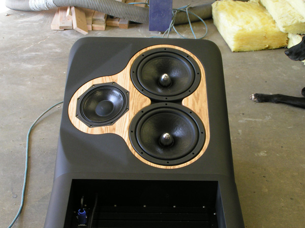

One of the reasons I like the rubber wrap around edge gaskets is that they trim up everything nicely. They have a little flex to them when putting the drivers in the hole. They have about a 1/8" radius on the outside edge. Using a 1/4" or 1/8" radius on the countersink hole then fitting the woofer tightly gives a pretty nice finished look:
This is the best example I can find now, but you can see how the gasket covers everything and fits tight in the holes.
