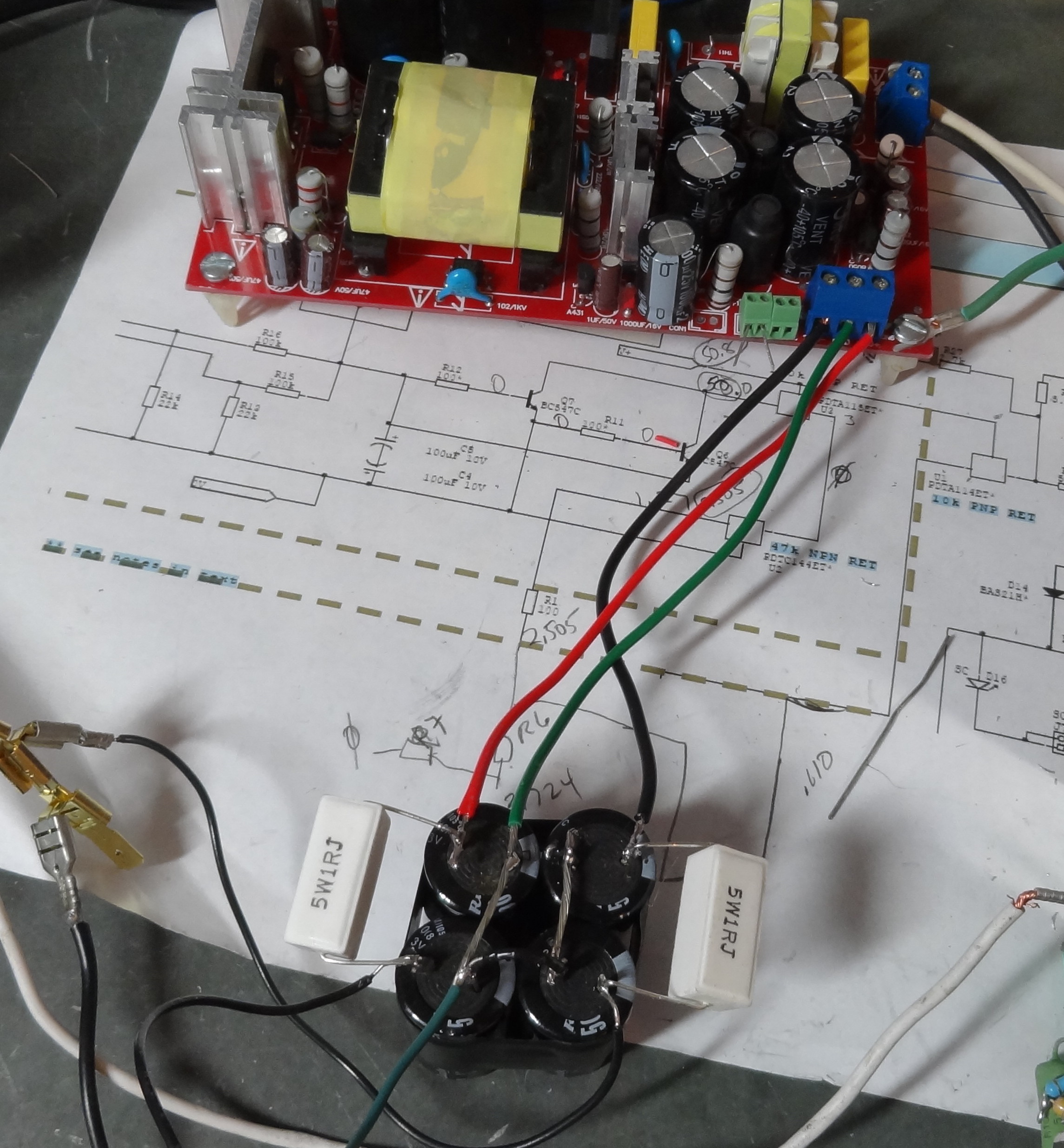

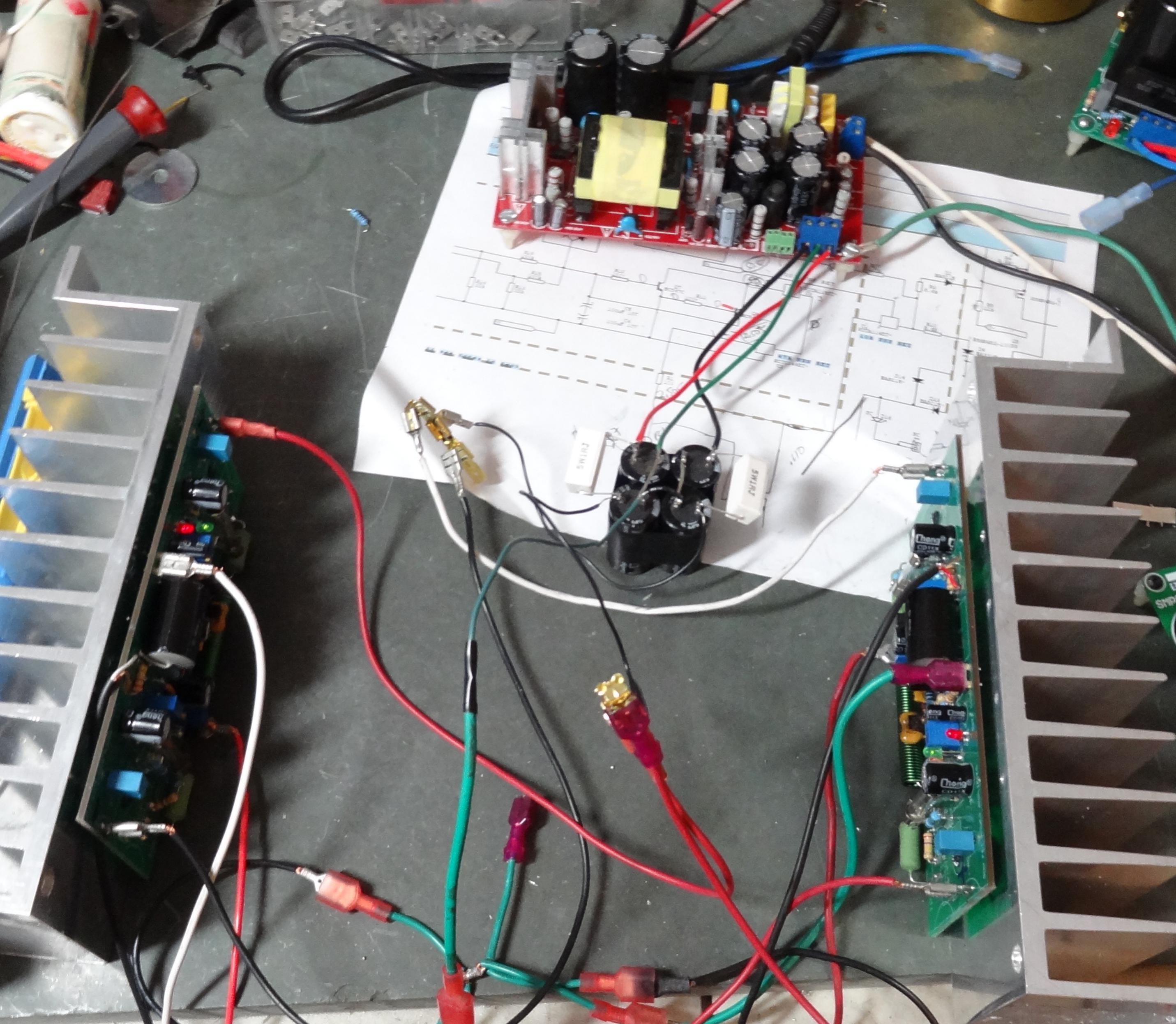

I put together a small CRC to try with the 25v SMPS. I used 4, 4700uf caps and two 5W 1R resistors. The SMPS started fine connected to the caps so I hooked it up to the two amp modules and it still started up just fine. The only time it didn't was when I had everything hooked with a music signal being inputted. I turned down the input and then it started just fine.
The FetZilla sounds very good set up like this. I A/B'd it against my VSSA and they are very, very close until you get to high volume and then the FetZilla starts clipping sooner than the VSSA but to be fair, The VSSA is running on +-37V rails and a cap multiplier and FetZilla is +_24V after the CRC. I would be plenty happy to use it as is. It is also dead quiet with this setup and I don't even have it in a case and have wires running all over the place.

OK, one more thing to add. I hooked up the 300RE using the same little CRC and inserted CL-90 thermistors between the SMPS and the CRC filters. Upon first fire up it worked fine. It drops about 2.1v per rail measuring from SMPS output to tab on the boards. This is driving both boards with music playing. The issue arises when you shut down the amp and then try to restart it. The SMPS starts its cycling on and off. You have to let the amp sit for while so the CL-90s can cool down. Then it will start again. So this tells me you could use a soft start circuit between the SMPS300RE and the filter bank and have it short out after a few seconds and you should be fine.
