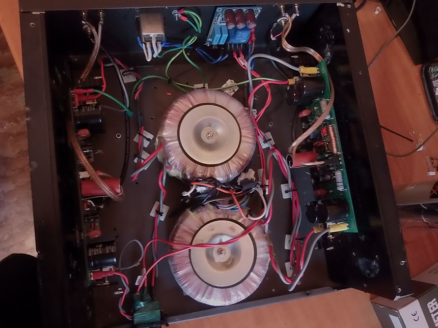

Hello
After having assempled my fist fetzilla channel i have some problem adjusting the offset.
I can't get it lower than -600mV.
The R12 Voltage is 24 V
I adjusted the bias to about 38mV on R17 and R18
What could be the problem?
Did you short the input?
Yes i tested everything with the input shorted.

I admit that i'm not experienced with circuit analysis and troubleshooting so I did the following:
Assembled the second channel (this works as expected) and adjusted according to instructions (no problems).
I compared (measured off line) all resistors of both channels (except those that cannot be measured in circuit due to near by capacitors) and found they are almost identical.
What troubles me is that I measured the voltage (referenced to earth) near the gate of 2sk170 (just before r6):
The working channel has "gate voltage" about 3.04V and offset at output near 0 (+-10mV). (R12 is adjusted at 24V, and bias at 37mV)
In order to adjust the non working channel i need to have more "gate voltage" and then i run out of P2 range, having 3.26V near the gate and the best offset at the output is around -630 mV (again R12 is adjusted at 24V, and bias at 37mV)
Do you have any more suggestions on what to measure so that i can troubleshoot the problem?
Is there a possibility that there is a failure of an active component?
Thanks in advance for you time and guidance
regards
Theodore
