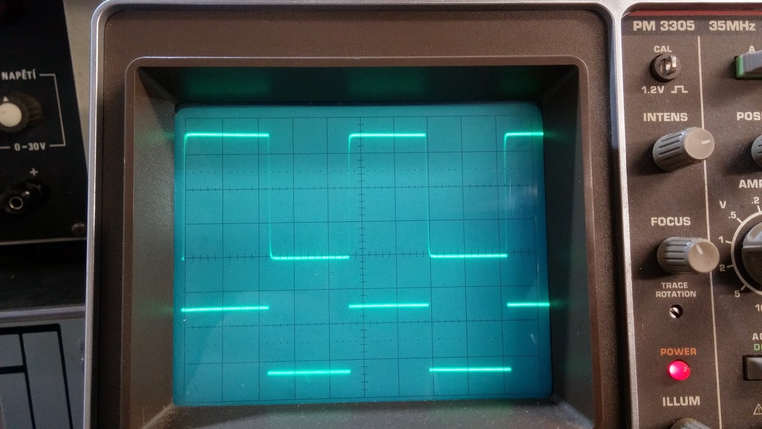

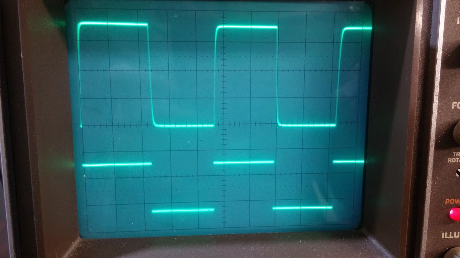

Today I had chance to look on my amp. So, I found, that both gate resistors was interrupted..It was my mistake I used 0,25w resistors, and thought, that there is no much current going to gates I really don't understand, how could amp played without them
So, now is all right, and square is still fine at 20 Khz..(first pisture is at 10khz and second is at 20khz) I did some short listening test , and sound great... I am not able to assess, which is better I think, that all amp which I already assembled, are great sounding ...

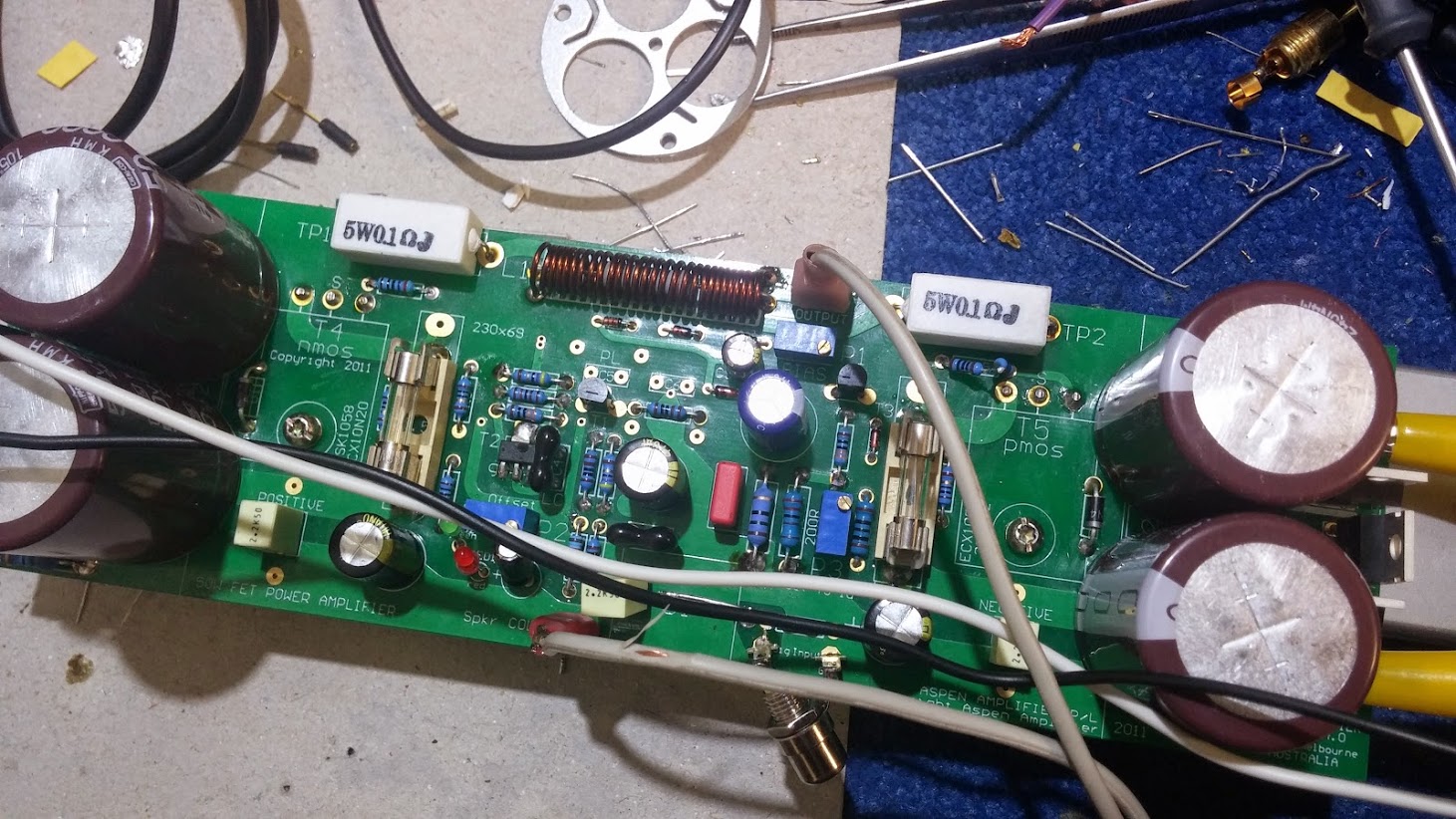

My findings as well, although i didn't go as far. I went back and reworked my PCBs today, there were quite a few changes. And i hit the singular snag with my boards, that the middle rectifier holes being just a tad too tight. After some sweating i just gave up and mounted that rectifier slightly high, should be fine.
The old .47uF Jensen copper PIO caps are on, and i came up with a neat way to keep them on the board, using some stuff i had around the house, will post a pic of that later. Also got around to swapping my 2SK170s of unknown Idss for parts with 7ma Idss, and fitted a regular diode instead of a LED for D3. Fingers crossed one or both of these things will alleviate my turn-on thump.

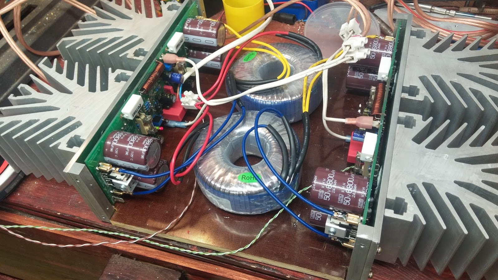

after long time i had chance to continue with work on this amp... I started with my own made chassis

This heat sinks are made by czech firm ČKD, usually for big rectifier 100 amp and more, for example for welding machine Due bigger bias I decided to use this heatsink, second reason is that you can buy this for good price in our country
So, how does it sound....I think, we have very small nuances between well-designed amps... This amp have very clear sound, with good soundstage, and isn´t so aggressive like fet amp usually are ..I compared this amp with just finished Apex A14, which have little bit more bas, but isn´t so detailed ... but again, there are maybe some subjective feelings... maybe, when I already finished all my projects, I will do some big comparison....
