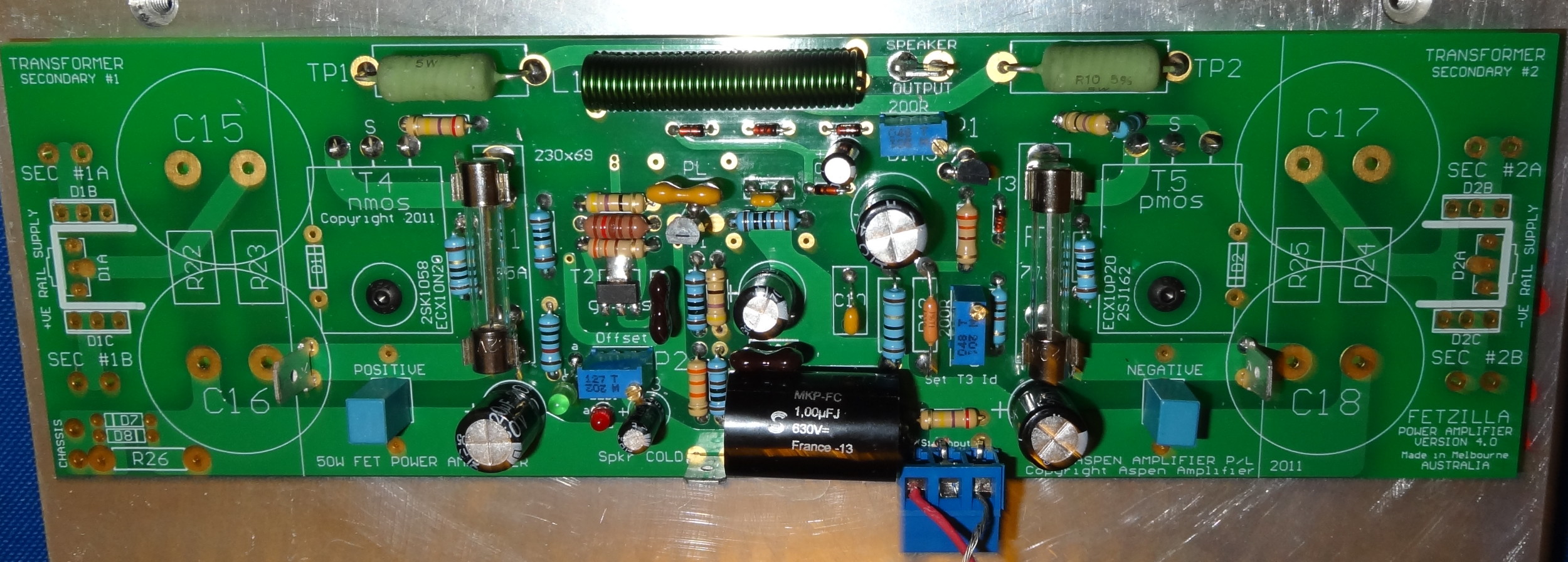

Part list says 33pF schematic 15pF
I used this one see link http://www.diyaudio.com/forums/aksa/198170-group-buy-2-fetzilla.html
I just put 22pf in there figuring I can add 10pf more if there is a problem. I have both channels completed and have set the biases and offset. All looks right so I will be passing a sinewave through them shortly and see what it looks through the scope. It should be playing music this morning some time. I built it without the PSU portion as I plan to run it from an SMPS. I didn't cut the boards so I can try the on board PSU later. I may even try using the PSU on one board and the SMPS on the other and see if I can see or hear a difference but I don't have a small transformer right now.

Test your compensation value.
Adjust the input filter to much higher than the usual 100kHz to 200kHz.
Try 1MHz.
Then apply a 500mVpp 10kHz squarewave that gets filtered by the input filter.
Read what the output does.
If you have significant overshoot or it takes forever to reach the flat top then adjust the compensation value.

Yes, I was starting a Fetzilla build back at the first group buy and realized AKSA carried out a few changes to his taste for his PCB/parts kit group buys. We exchanged emails on it and I have a schematic showing 15pF with another tiny tweak cap in there too.The parts list I have says Swordsfishy. Do you know when and why it was changed to 32pf? Not a huge deal I'm just curious why it was changed...
That Fetzilla design is not quite the same as the Swordfishy (GregH) one, which was still under development in this forum at the time. Perhaps there is a mix-up of who's design became Fetzilla and the compensation he and the other guys contributing to the project wound up with, what compensation they decided on etc. Maybe I dunno either!

I'm not sure what you mean by "adjust the input filter". How are they adjustable?
Thanks for the explanation Ian.
I have had the amp playing for a couple hours. I'm using a Connex SMPS set to +-38V rails. It sound very nice. Slightly less detailed than the VSSA. Very similar to my SKA GB150. It has good gain as I am just playing a CD player through a 15K pot and it gets plenty loud.
I used a Solen 1uF input cap. It fits nicely.

Not a lot of parts in one of these. I paid for the boards back in December so I have had the components in a bag for over a month waiting on the boards so I really only took a couple hours to solder everything in place. Only two holes to drill and tap for mounting the boards. Can't get much easier than this. My only complaint is the way the input is set up. It's designed for two pins but I like using euro style terminals. I had to drill a couple holes. I may take the blocks off and solder direct once I'm ready to install it in a case so I can go lower profile. With the terminal block hanging off the side like that it is over 3" wide. I guess if you use a smaller input cap you could get away with a vertical mount block.
Adjusting everything is pretty straight forward. The VAS bias stays put once it is set. The main bias starts out high and reduces as the amp warms up and the offset is affected by temperature too. It wanders a little with temperature but stays reasonable. At 360mA bias the heatsink runs fairly warm. You need a good size heatsink from what I can tell. The sound I quite nice. This one will get a case soon.
