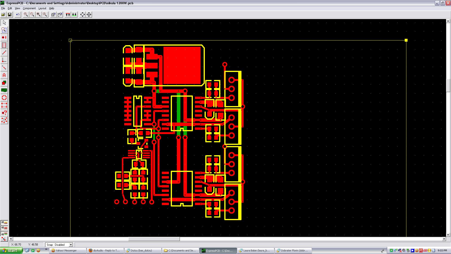

Hope that I am right because I started to try to develop SMD PCB version for it
Attached is the ongoing PCB version. It still need the output filter stage, feedback, supply filtering, top and bottom ground planes and a buffer at the input because i think i have to drive it with a differential op-amp with one out 180 Degree shifted from the other.
Please correct me is i am wrong. I am new kind of new in this field.
