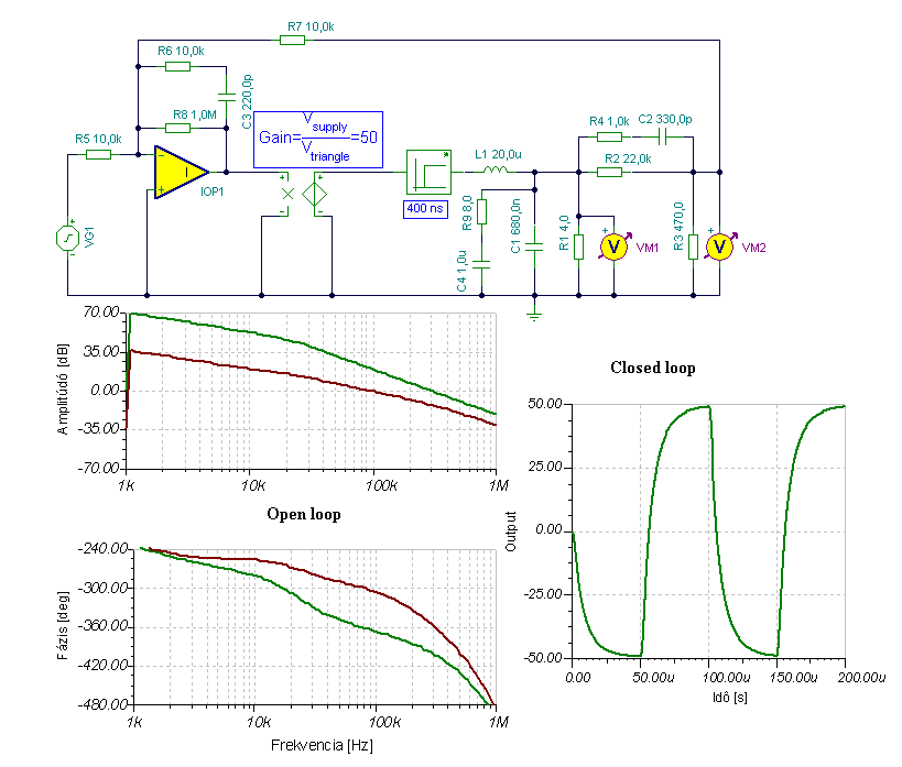

Btw guys, dont you know some links about class D feedback design? Don't get me worng here, i don't one none of you doing my homework but i need a bit push from the back with some infos...
- why do you want an optocoupler?
If something on the outputstage goes wrong, i dont want to blow-up the intire board :D
OK.

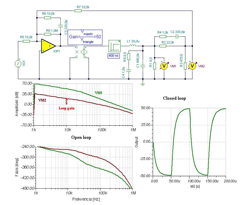

Thanks, Pafi! :) But I have one more question :rolleyes: I think the VM2 voltage will be at least halved by R7 and R5 before reaching IOP1. Is it correct? :( Also, RC network R6+C3 will have relatively low Z at 10KHz here too... Please, correct me, if I am wrong...
EDIT: Oh, I see now... R7 has the same value as R5, so VM2 has the same effect in closed loop, as an VG1 source in open loop... :)
